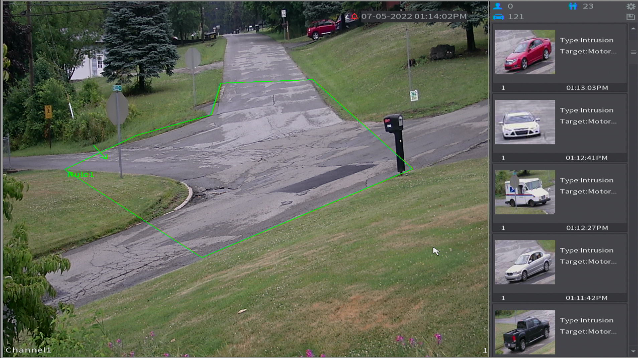

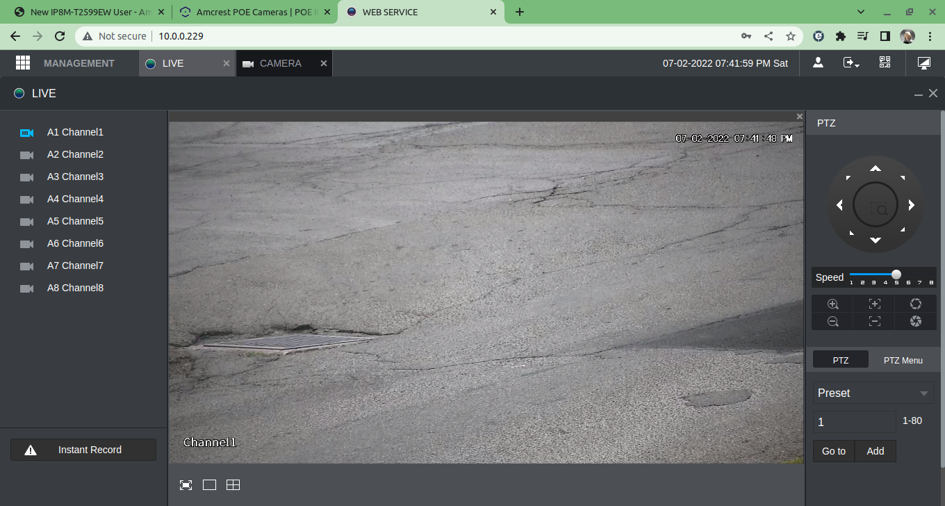

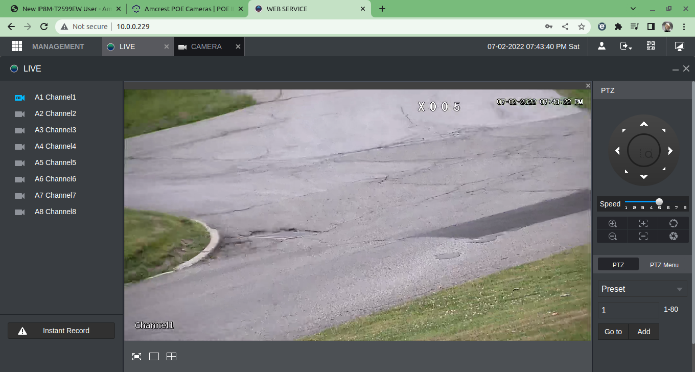

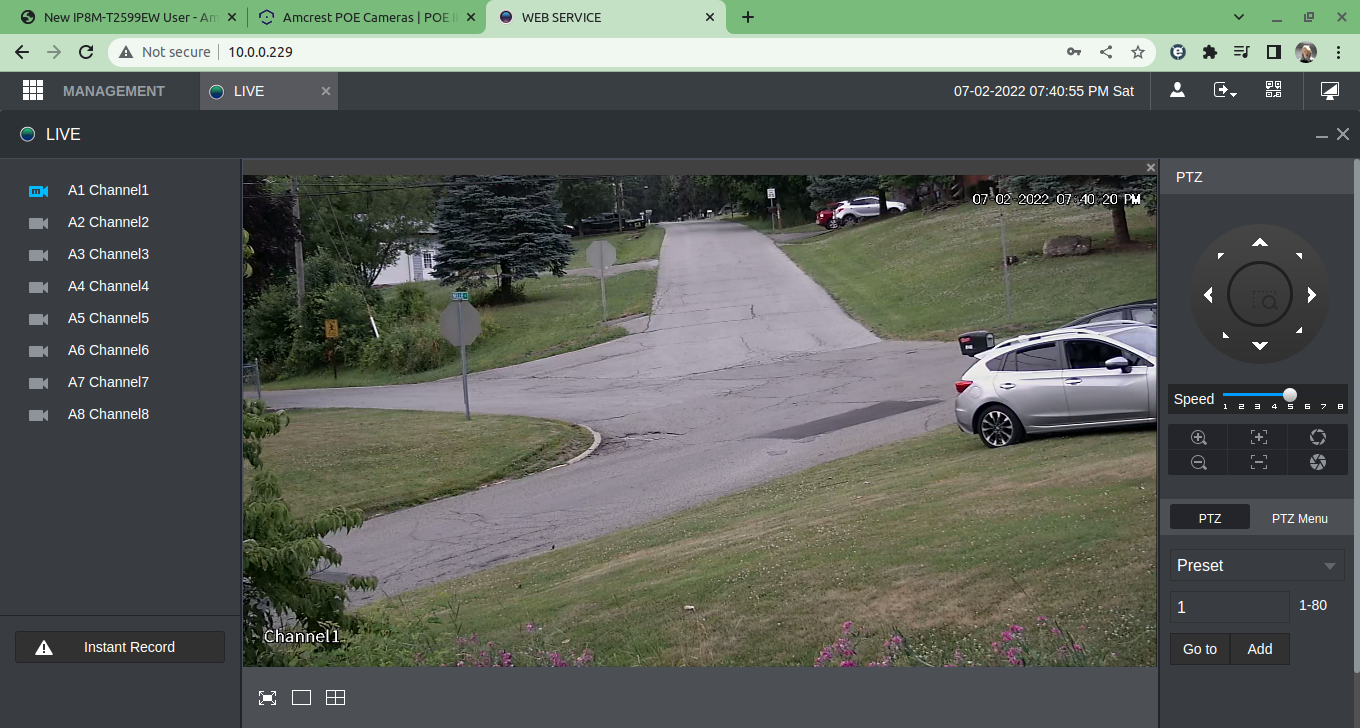

Just reset this DVR again lol So lost all my camera names I have not set them up yet.. However this is my CH1 that shows what I call TriRoad 10x zoom camera. It is a Bullet camera First picture isn't the widest angle it has. However there is a party going on next door and with it all the way back it shows more of people that i don't post
First Picture is my Normal area of View, Second Picture is Full Zoom in at 50mm and last picture is about 24mm and where I would need to have it if I wanted to read plates. This is a DVR so the capture is 30FPS and I can play each frame to find the best one if I wanted to read plates.

That is the WebUI of my Amcrest 7108-AI DVR. Out of the cameras I have installed that are not PTZ it was only one that has the Zoom ability from the point of Install to the Point Of Interest in a road...

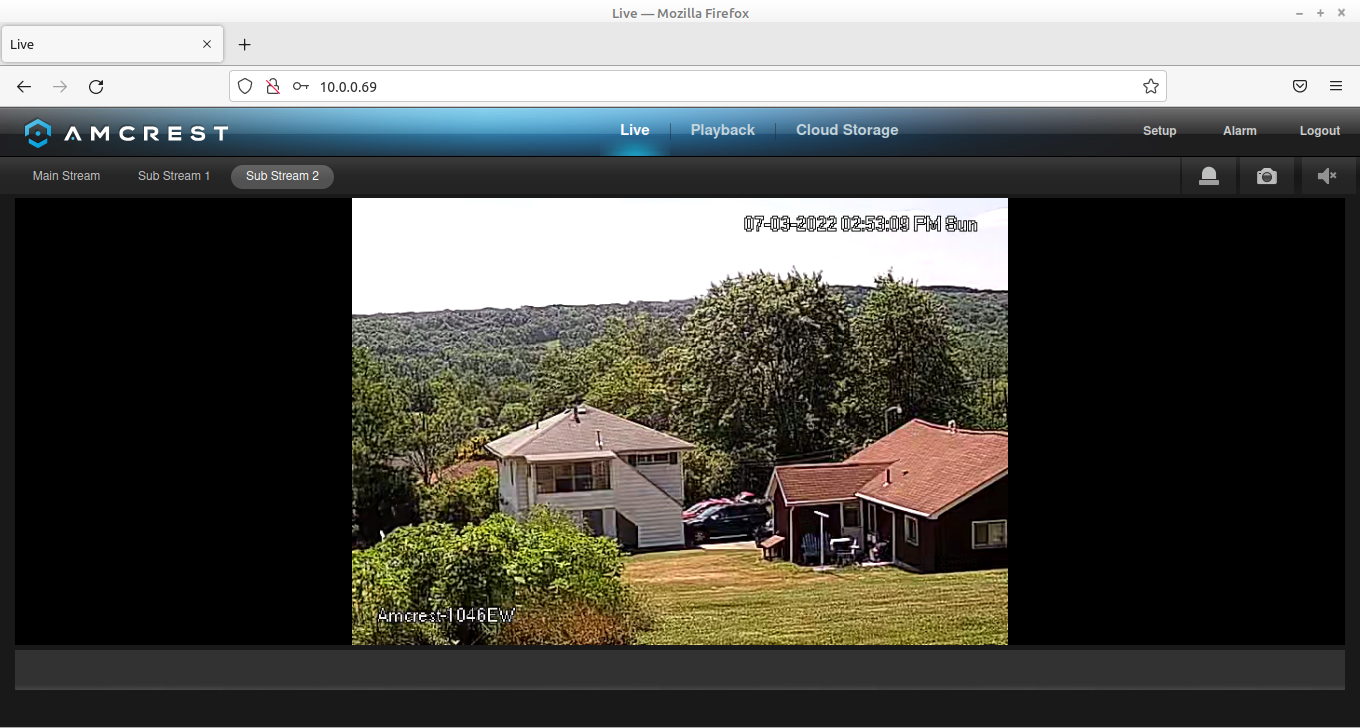

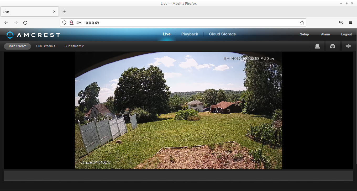

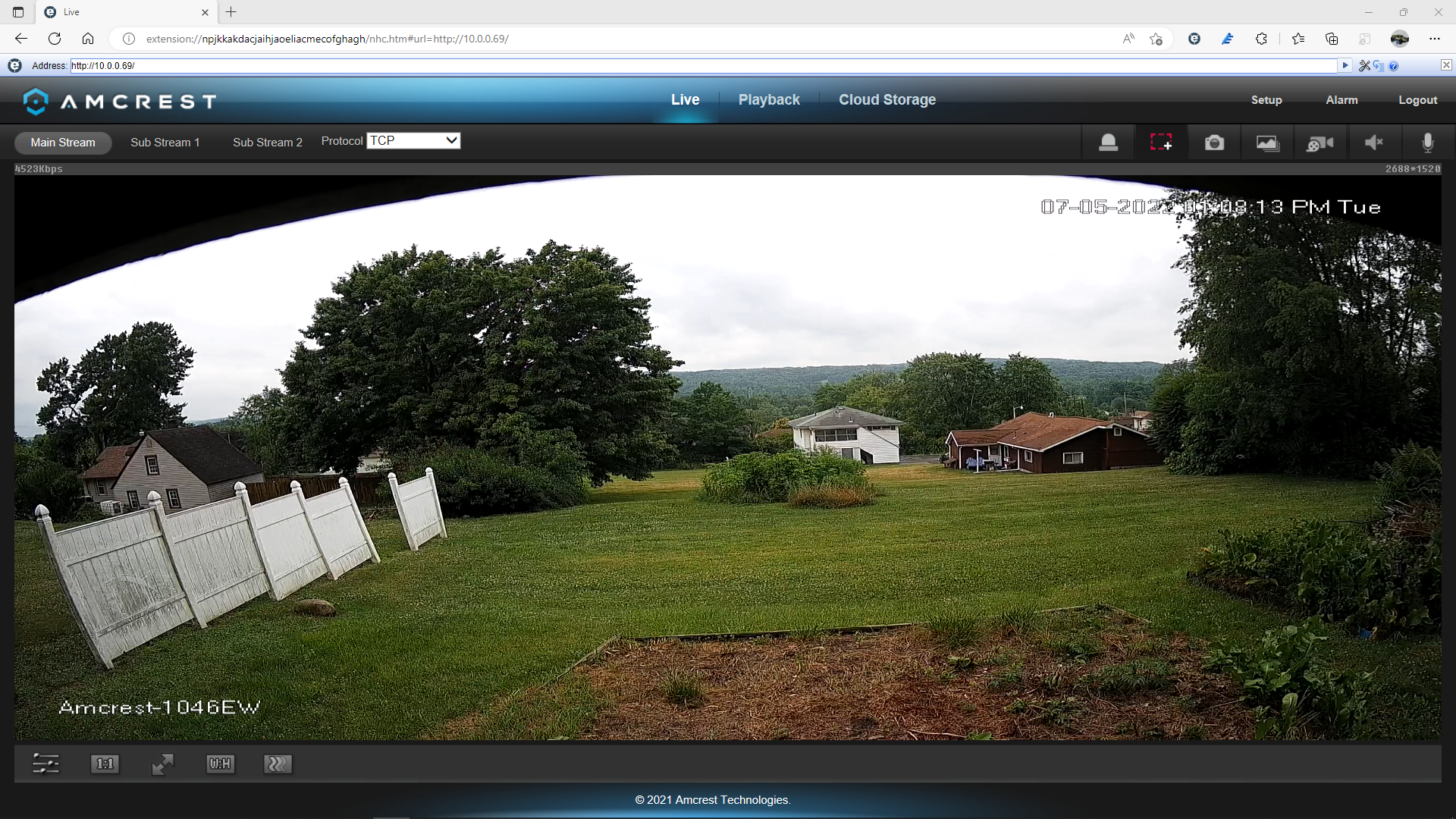

Using my Unix box so wasn't able to use IE however in Firefox I was able to get my Sub2 turned on and setup seeing ASP I could turn it on and choose what size I wanted it but no option for the ROI..
These two pictures are from my 1046EW-AI 4mp camera so you can see what I am talking about with zoom of Sub 2 first picture is of Main, second one is sub2 as you can see in picture..

Re: New IP8M-T2599EW User

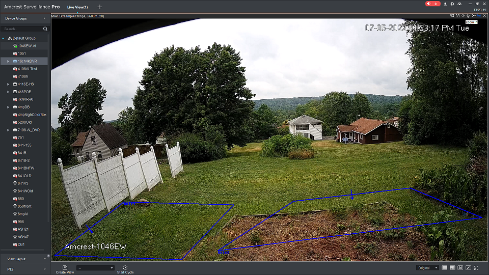

So I also thought I would mention about IE Tab. In my other pictures I was using firefox on Unix and it wasn't happy about ie Tab that I have installed so wasn't able to show. This is from Edge on my Win10 box. The Edge has ability to run in older IE from a tab see picture below. When in that mode you can see the Digital Zoom I have clicked it so it was red in this picture. ONce you do that you can drag an area to zoom in or pull back on mouse wheel will zoom in area of your mouse pointer doing the drag and drop of the box is faster.. But wanted to make sure I gave good details.. Also note that I have added a picture of my AI DVR with that camera in my first pictures to show what happens when I have Intrusion in the area.. This is something that might be able to help as well. I would have shown my AI NVR but I removed that channel for now and was just faster to show my DVR.. So yes my 4216e-AI NVR has the same layout as this DVR so on a Tripwire or intrusion it would look the same.. Also From ASP last window. Sorry had to make picture smaller it was over 3mb now around 1..
