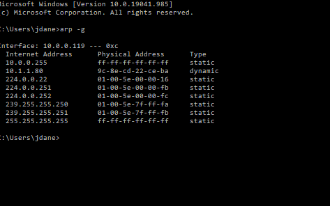

Second to make sure that your camera is reachable with the cable connected to the camera and computer is running the ARP command and make sure your computer can even see the IP in question.. From a Win10 computer press the Windows key next to spacebar, then at the same time press R, Type in CMD in the box that comes up, then when the Command Prompt window comes up type arp -g this will list your IP.s Now if you look at mine while My connection is my main range I do have many IPs and so I was able to access the 10.1.1.80 in my list all the other IPs are not important your looking for the Dynamic IP look at this arp of my connection in question in this picture.. Notice my Interface is my normal Static IP all others that I have on this computer around 6 others in total while not listed I know what ones I have access too without adding others..

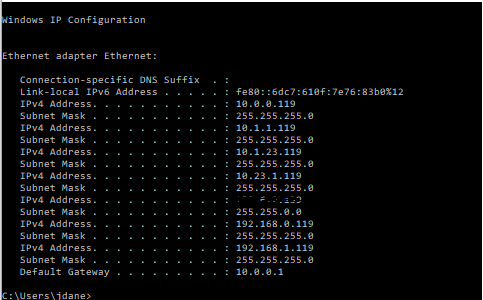

Re: New camera, no IP address
Oh thought I would also show my IPconfig so you understand more about why my interface says one thing and I claim I am able to connect to another just incase there is a Question about this info...
