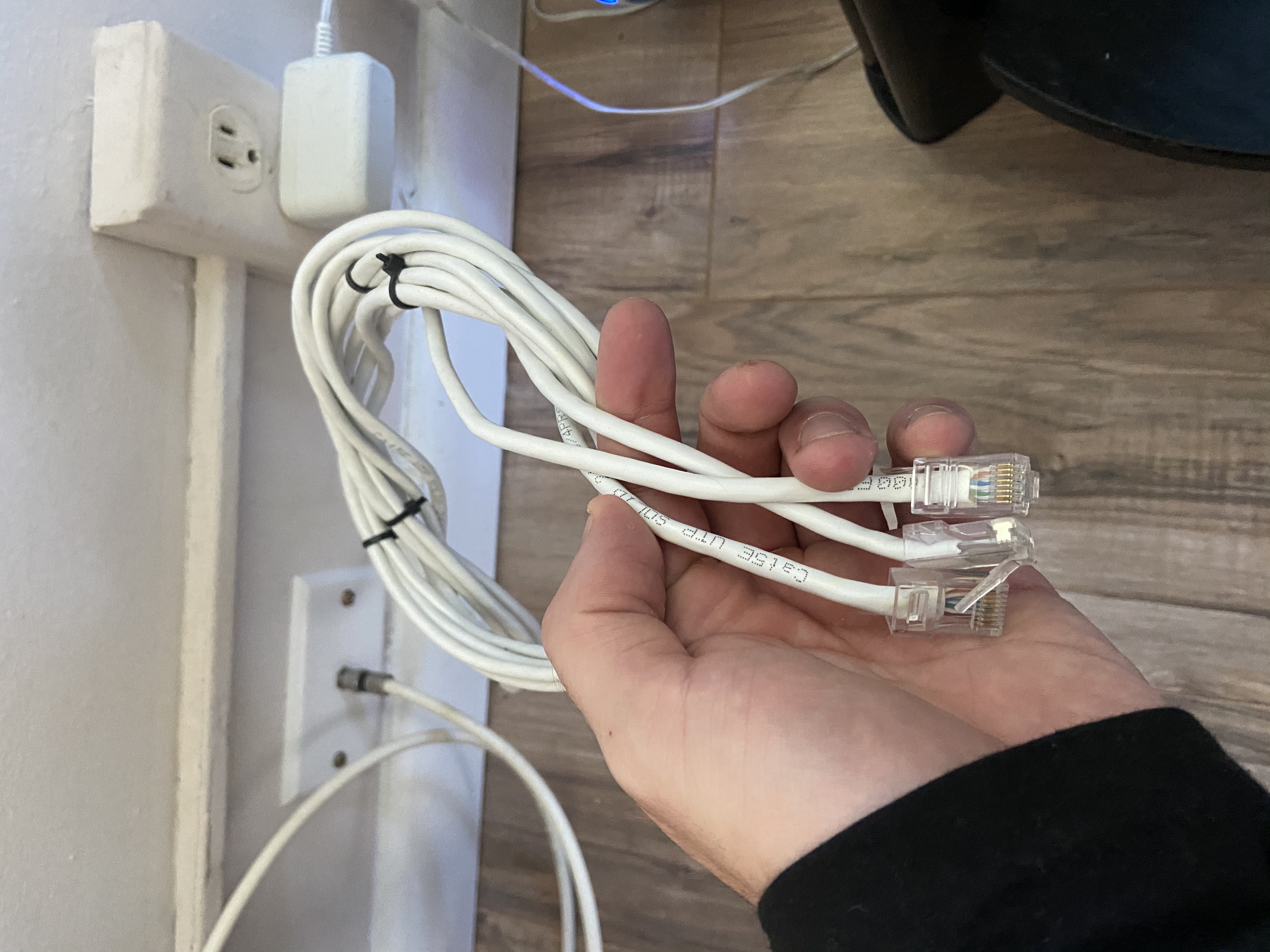

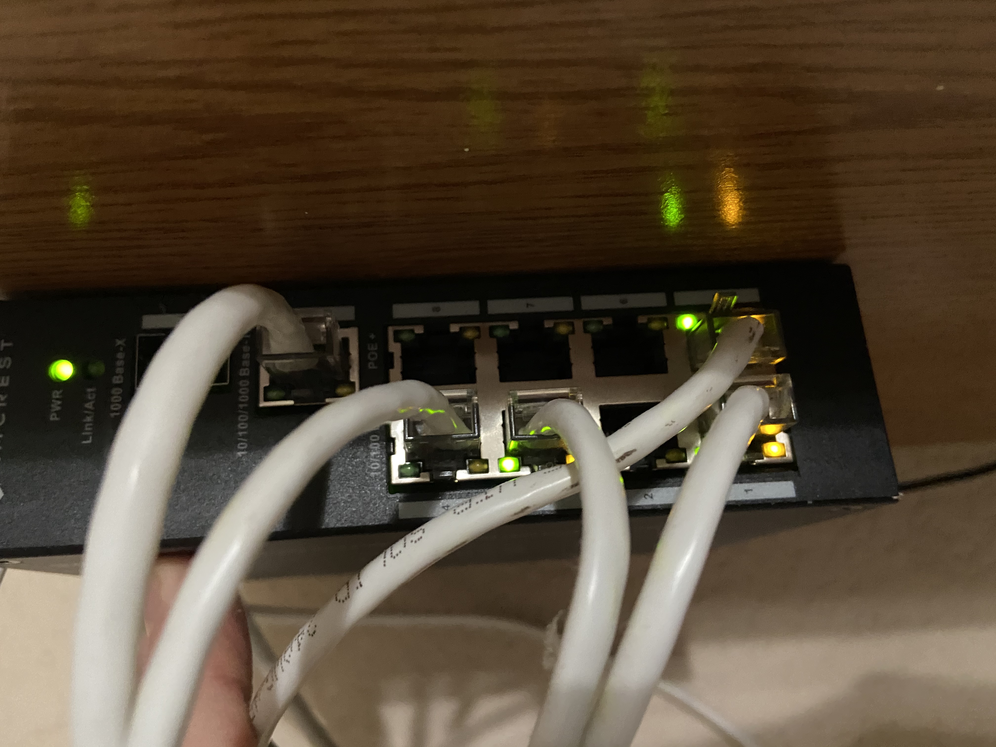

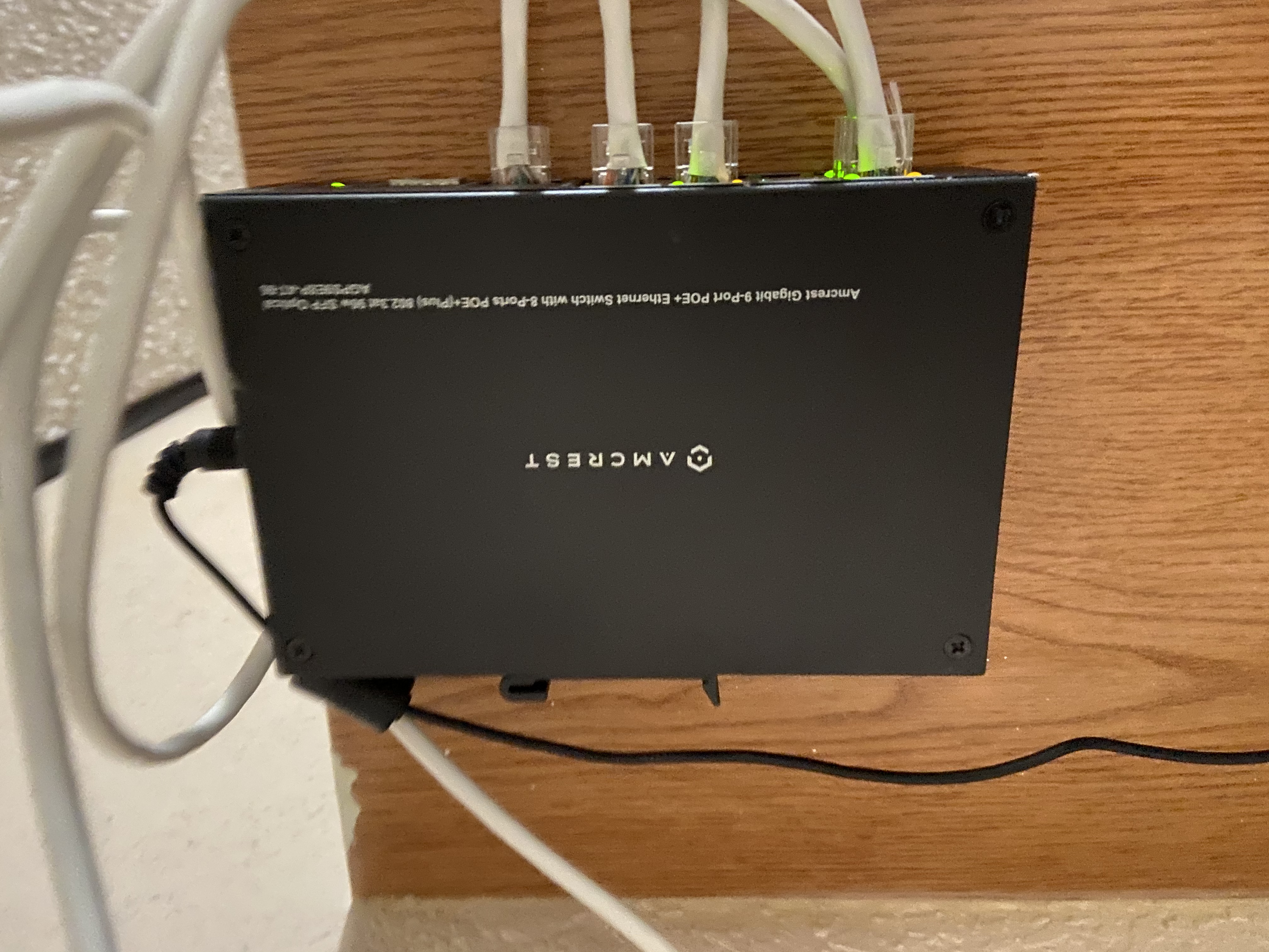

So there are 6 cameras total. 4 of them run into the POE switch in the garage and then there is a cable coming out of the 10/100/1000 Base T port which then runs towards the house. then there are 2 more cameras on the house that then are zip tied with that same cable that all come into the house and Terminate at the 3 cables I show dead ended in the house. Will I need to plug all 3 of these cords into a router? My router for the house is in a different part of the house but I have a wifi extender near these 3 cables, do I need to purchase another router for these 3 cords to plug into? Where would the NVR be tied into this set up? After the router? Lastly, the cameras I believe are under a different password, is there a way to reset the username and password for all cameras?

About the Network connection. Right now I am trying to get it so the 1 connection from the Switch that needs to connect to a NVR at a Min or the main network segment and or so you can gain access to the cameras..

To be honest there is just to much info that I don't have to get a good since of what you have going on.. My guess is that the 3 wires in Drop is going to be 2 POE cameras and the 3rd wire is from the Switch..

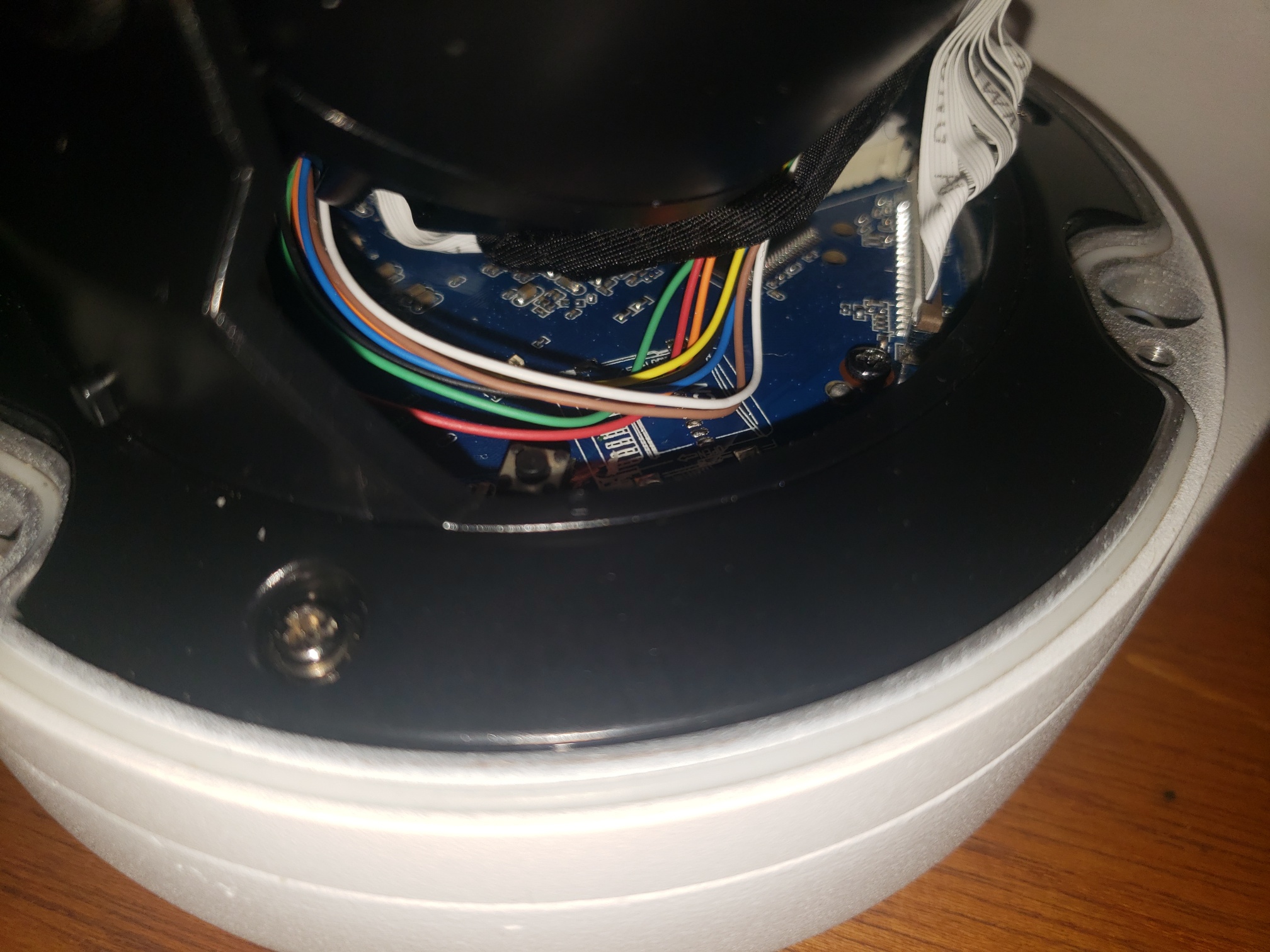

I do own that camera.. If memory serves me right that one does have a Reset button.. I would have to go to my cabin to look.. I did have it here at the house until last winter when I took it to the cabin..
Anyway taking the 3 screws loose on the dome, Removes the dome and there you can gain access to the board, If again memory serves me right the Reset button is close to the Micro SD card slot.. It might take a Security Drive to open the camera that tool comes with the Amcrest cameras when new.. Also any of the Micro Drives sets with them type bits most times have that same size bit so don't need to have the tool it came with just the right sized security bit..

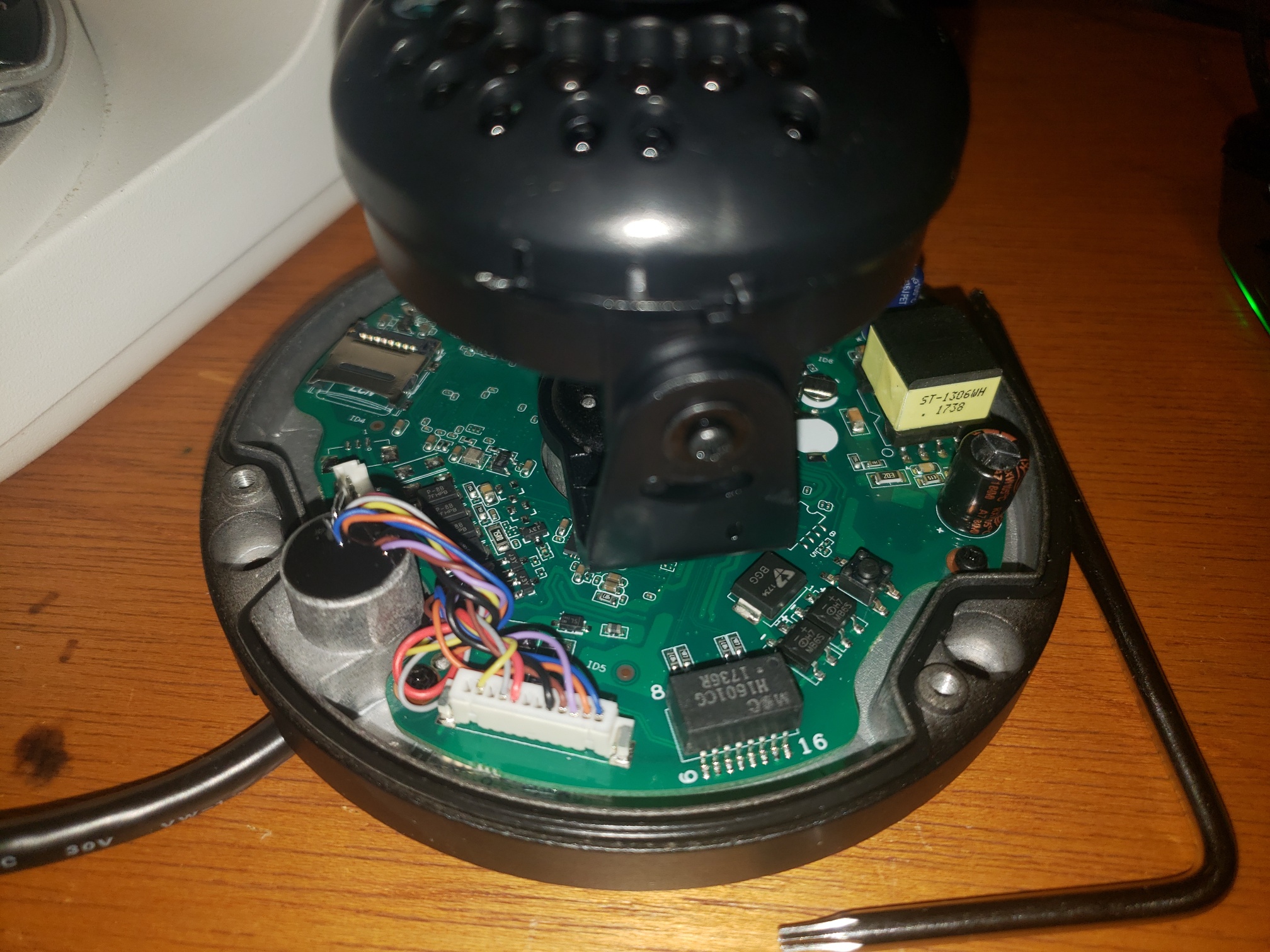

So I am sorry I was wrong when I said the Button is by the Micro SD card Slot.. So the other night when i sent my son to get the camera he came back with the Wrong one lol.. So sent him up today to get the 956EB and did get home with the Right one this time lol..
So looking at where the MSD card is the button is about 6 hours before that.. SO looking at a clock MSD at 6 the button would be around 12 on the Board is best way to explain.. The one he did bring home would be the one I was thinking about where the Button and the Card slot is in same area even though that one don't have the cage the solder area is still there...
Here is my other 3mp Dahua though
