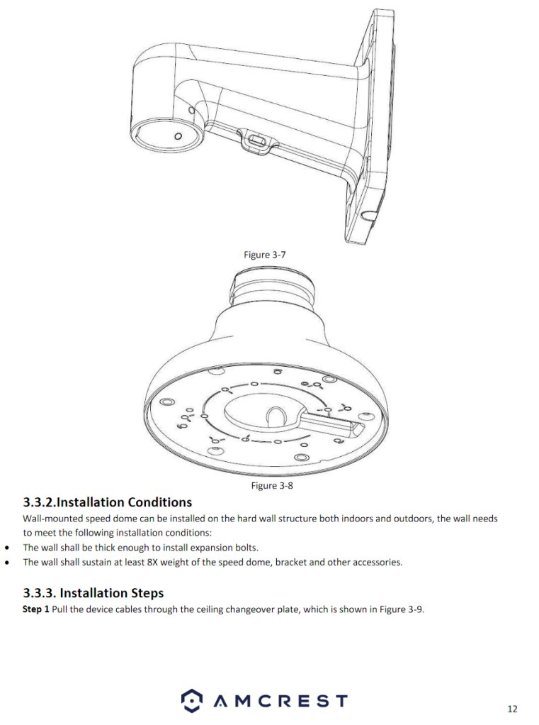

I am not 100% sure but I don't think this camera you want to place on the side of your house. While i am not saying that it can't be mounted in a well covered area. This camera is rather new and mounts maybe out there that would work made for other cameras.. Looking at the Manual I seen a Wall Arm mount that I would say is the best option for mounting to the wall.. While this was the Manual online and might not be same page as one that came with the camera... But that can be found on Page 12. It is same type of Arm as my Speed domes use however this comes with a part to mount the camera too then is put into the arm. Well thought out I think...

The user manual shows the appropriate wall mount. I can't find it for sale by Amcrest only from another source.

Sorry I guess I didn't give enough info and the pictures that was provided didn't help as well... Also as I said in your Manual on Page 12 there is the info for mounting this...
So the Bracket that Jack7 talks about while some cameras could use as a Stand alone I am not sure that is how you want your Camera installed... To me wouldn't look right... However I am going to guess Jack was saying to use that in connection with the Brackets that is on PAGE 12 of your Manual....
The Part NUMBERS for your MOUNT to make it look right and make it look like it was meant to be mounted this way is off page 12

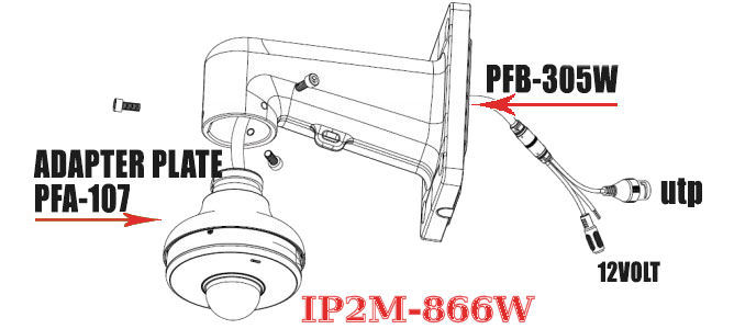

Dahua PFB305W Wall Mount Bracket
and Also PFA107 as the part to connect to the Camera. Then the 2 parts go together to make compete set.
Then if you do a Search on Ebay with out the Quotes you will find many options... "Dahua Aluminum Mount Adapter and Wall Mount PFB305W + PFA107"
Then those 2 items along with the Corner bracket Jack7 mentioned will give you a Total solution for Corner Mounting this Camera... More then enough area for wires to hide...
Re: iP2M-866W wall mount?
Here is a Picture with Part #'s incase others are looking to do the same thing. This way they know what they are looking for... Also Amcrest does have one with Camera and the Pole mount with Bracket for the ones that are looking for that type... They have one that is like 866W-PFB220-PFA107 and is like around 40more then just the Camera...
