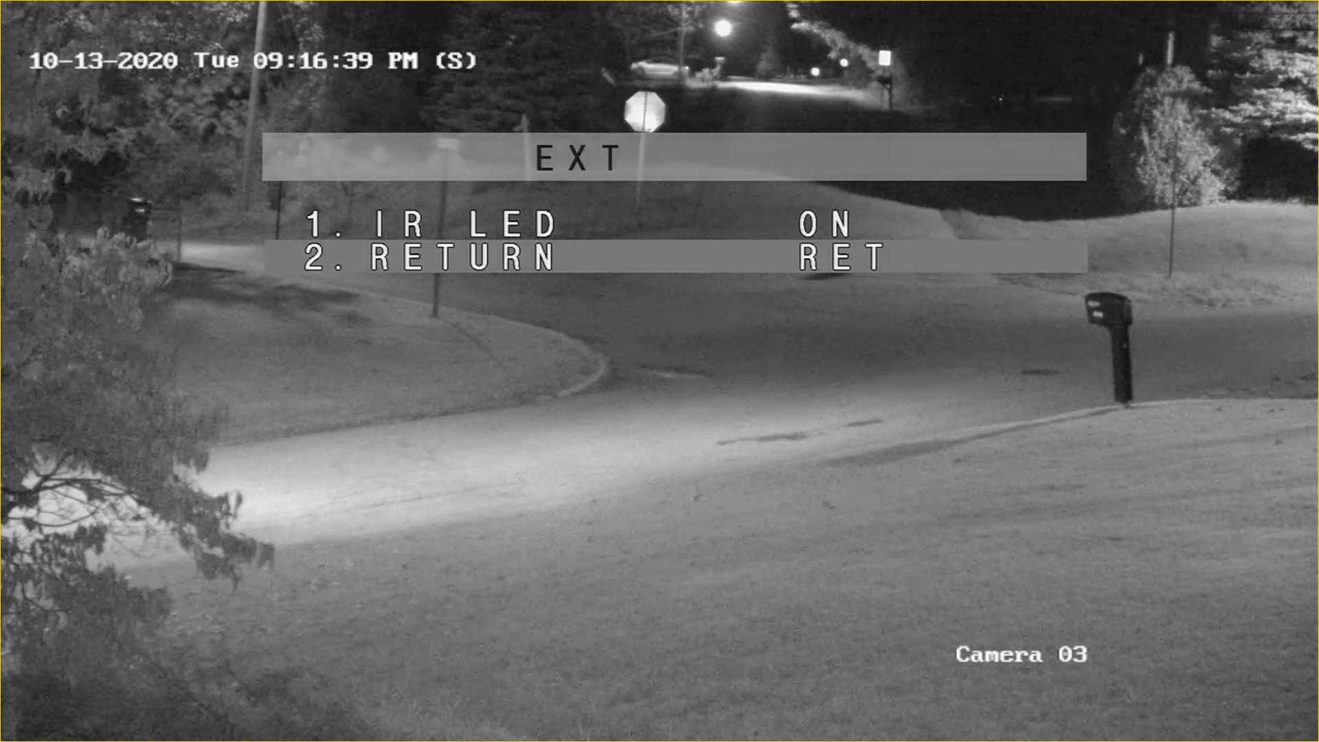

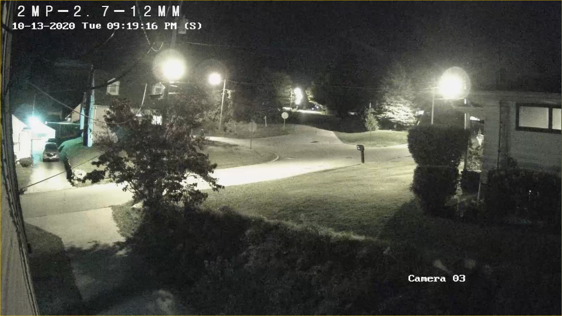

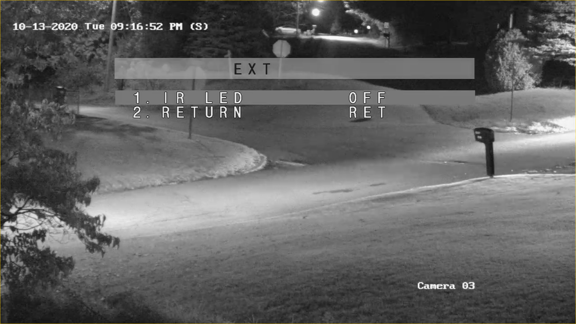

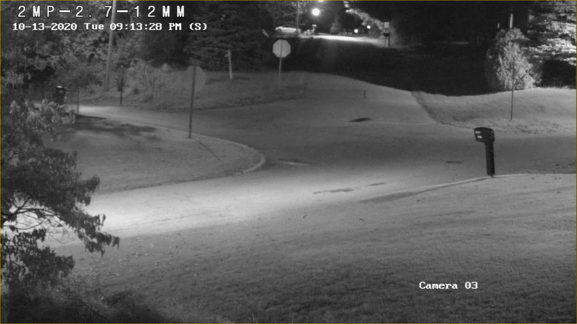

Mind you this isn't a 8mp and I paid almost as much for this camera as the one your looking at that will have better Picture Quality then mine will but to give you an idea Showing this set of pics so you can see the Speed sign with IR off it can be read when zoom in ir on no.. I have left out the Far out of focus in and out pictures because they are kind of large is size
Screenshot (62).png (1.32 MiB) Viewed 9478 times

Re: Hello all, narrow zoom poe camera?
By the way these are in 1080 format so if you want to see full size right click and open image in new tab to see full size picture forgot to mention

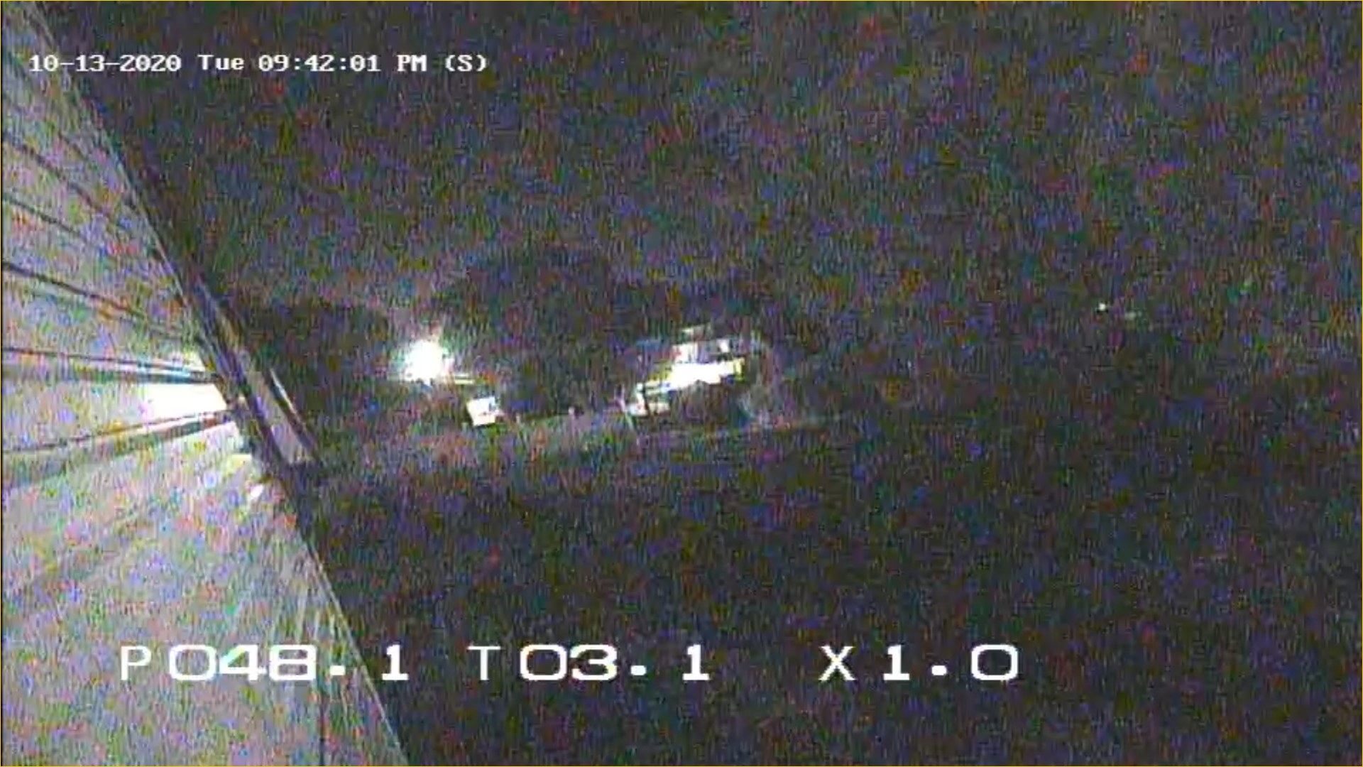

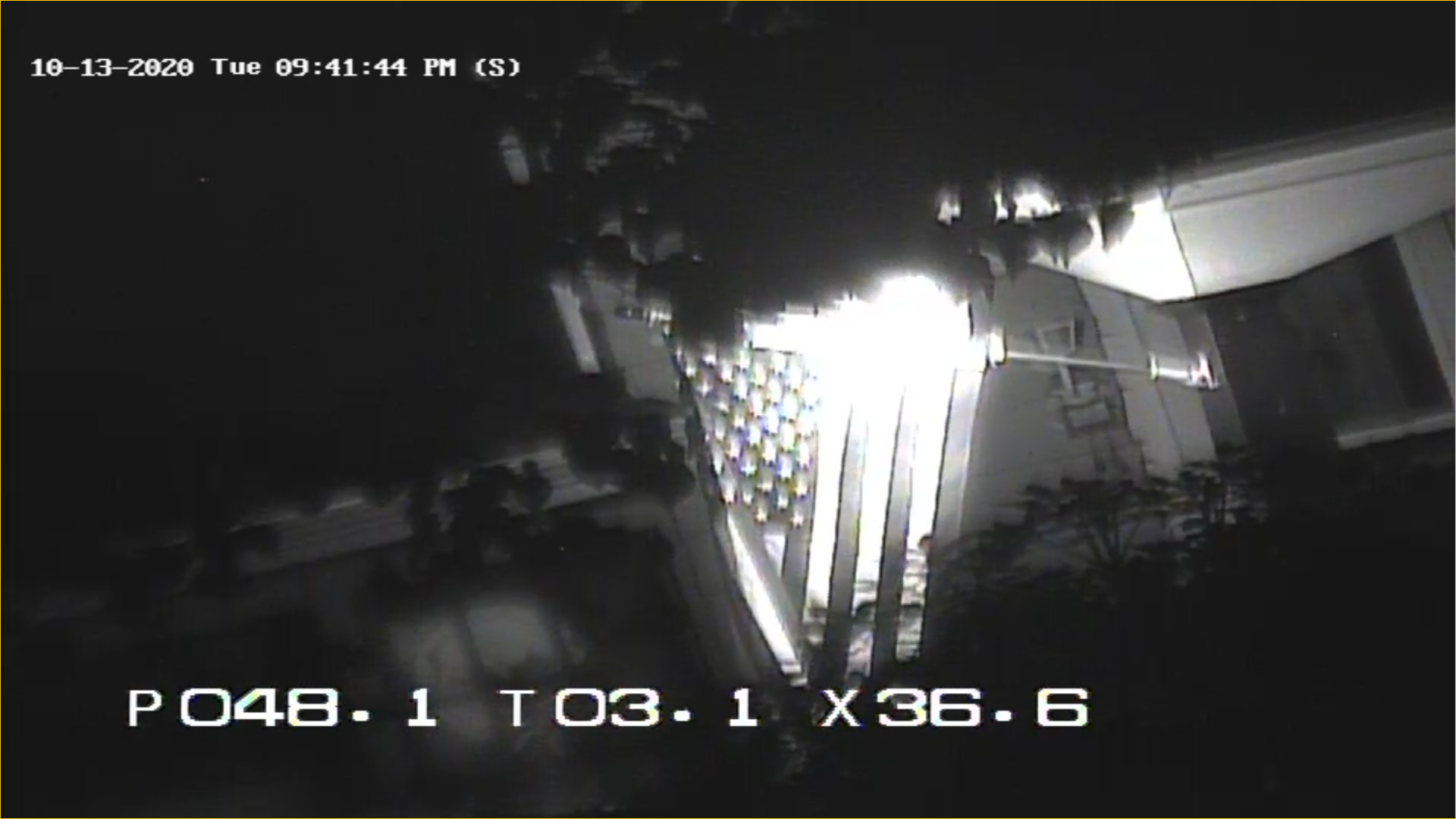

Oh thought I would post a Picture of what a 1400$ camera picture looks like from 2014 LOL 2 thing need to note here this camera is about 30' plus in the air and the Flag is about 300' away, It is though 2 back yards and 2 front yards to get there from this camera oh and across a Street as well... This camera is only 600TVL so it isn't even 1mp in quality..
After they are seen I will remove them because this is large in size and just to have an idea of OLD bad Quality Looks worse because it is going though Network image on screen of local device didn't look so degraded...
