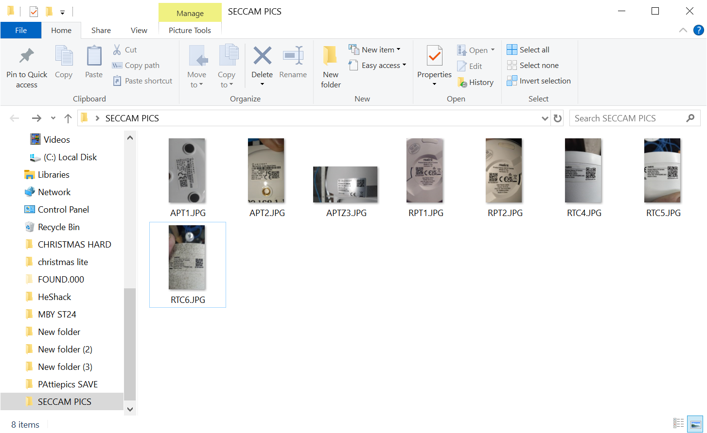

This setup, I am making a collection of a picture of EVERY cameras tag with the info and QR. I check them as I upload them from my phone to make sure they are legible to my eyes and an iPhone. I hope I never NEED them, but if I do it will be a welcome source of info.
Only on #10 now. It is absolutely miserable weather here today, so the outside cams are for a sunny day.
Thanks to reading your post, this is the CYA (CMA?
) folder I am making now for all the cams. ALL THE BEST with your system.
