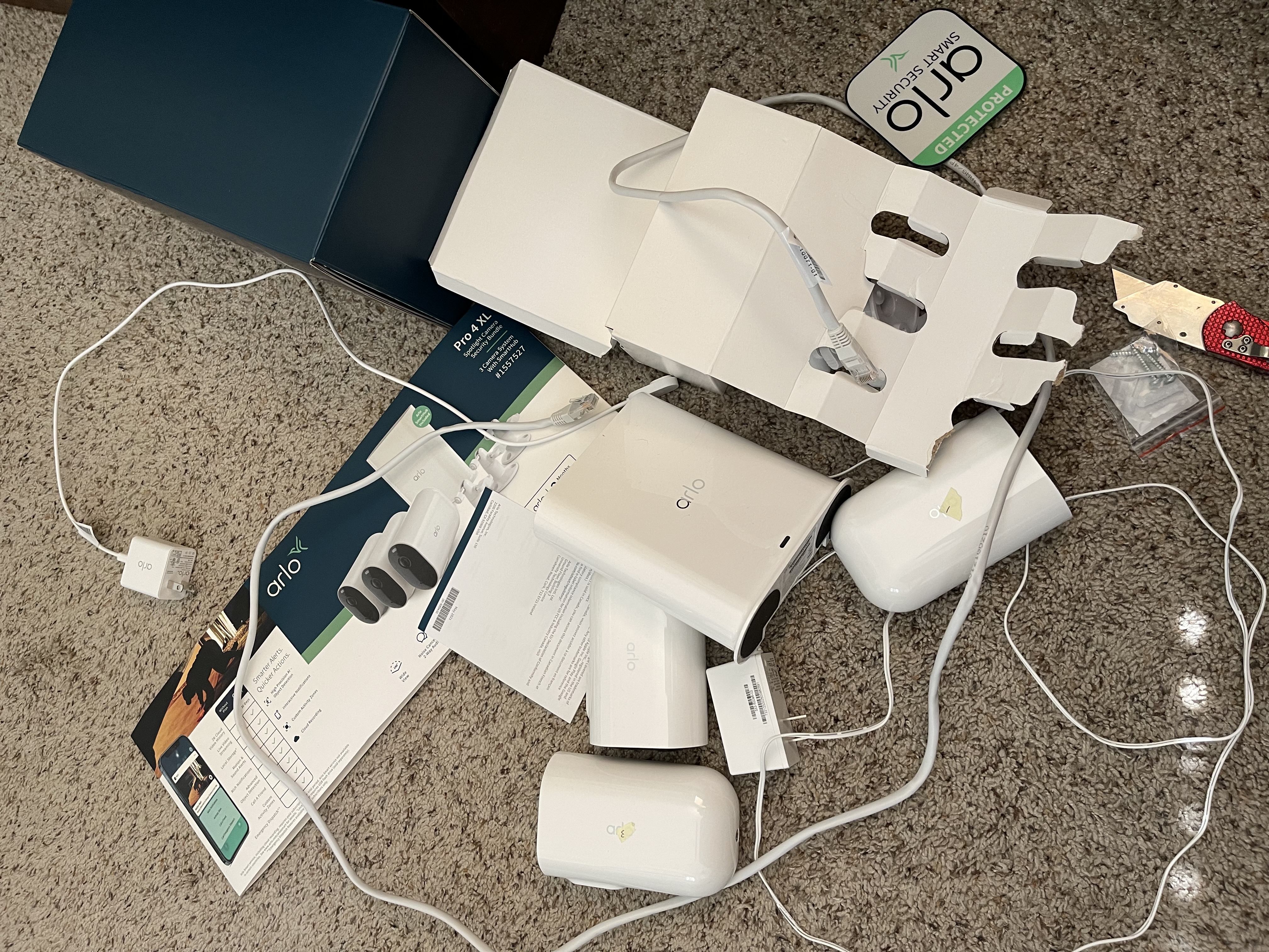

I'm looking to join this club, because the old one was trash.
I came across Amcrest after a few minutes of searching, and from what I'm seeing this looks awesome. What Amcrest systems are "comparable" to this Arlo setup? (Supposing the Arlo worked). I'm into ip if it works reliably with my mesh wifi system. If not... I can run cable.
Thank you. Russell
