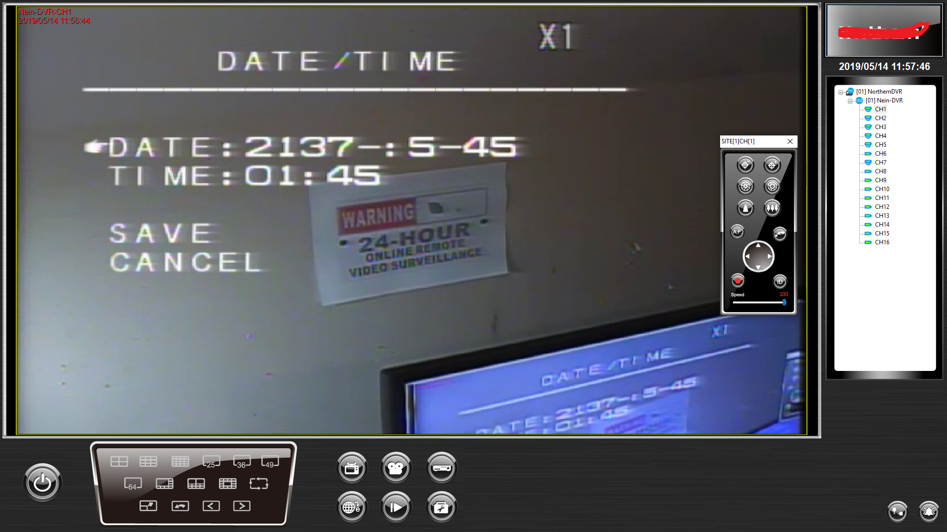

Hello sorry to hear the issue is constant. While I am not sure what the problem is and seeing it changes the date back to a date before the camera was even built seems really strange. Crazy thing is I had a camera from another company a very costly PTZ 37x that would set the time to some crazy time. Time that couldn't even be made because the format was wrong even lol See Photo below... Anyway in my fix for that camera I had to replace the battery that was on the PCB sadly it wasn't just as easy as pulling one out it was soldered in... Once changed out it works well keeps date and time and all settings as required...
For your problem I would maybe reach out to the Amcrest Support staff if it is in Warranty time. If you bought it used and out of warranty it could be the old owner might have tried to install something in the camera that has it messed up.. IP cameras and things with Firmware it is important for me to make sure I buy new from Rep Sellers.
Screenshot (313).png (696.33 KiB) Viewed 2429 times
Edit, Redid the Picture to take out the Logo of DVR as it isn't needed in picture
