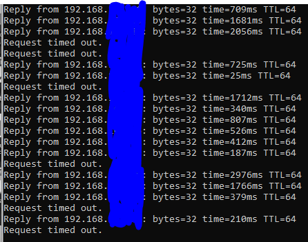

I installed a amc-ip4m-1028w outside and was working great for a while 6 months to a year, then I started getting network drops. Using 2.4 WIFI.

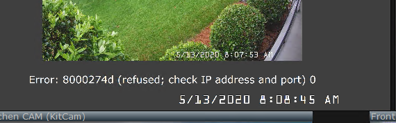

Sometimes this camera will display "ERROR: 8000274d (refused; check IP address and port) 0" Not sure what this means.
If I do a Ping -t, the camera sporadically times out for no apparent reasons.

- error
- cameraping.PNG (30.23 KiB) Viewed 247 times
- ping
- camerror.PNG (131.06 KiB) Viewed 247 times

Ok with all that said... Sadly I can not speak about other Cameras that you Own as I don't have any info on them and I am only going to guess that it is to be HONEST not fair to compare them to your Amcrest camera that is a Higher Quality Camera with higher quality features... So what that translates to me is that the Requirements for your Amcrest Camera Requires more Bandwidth then your other camera and as such could be an issue... When someone has issues with a Camera it is easy to suspect that the camera is the issue however for my system and I am only speaking about my system here.. I found that 1 of 10 times it is the camera and only know this after I have rebooted my Router(s) Most times I can get away with a router Reboot and issues solved
About your problem today... One of the things I found in my Setup again I am not there so I can't really say it is your issue but I have ahd this issue.. I had a Wifi Camera working without fail for months then bam issues after installing another wifi camera but was not right when I installed it but after... Funny thing is this camera is from another company and has lower network requirements so they need less bandwidth.. I thought the Amcrest Camera was failing but come to find out my other cameras were taking up even the little bandwidth was enough to make my router unhappy... Then it isn't only that...I mean if you have other things connected like your phones, TV, Alexa and all other things that might use Wifi bandwidth can make it so your Camera don't want to work...
