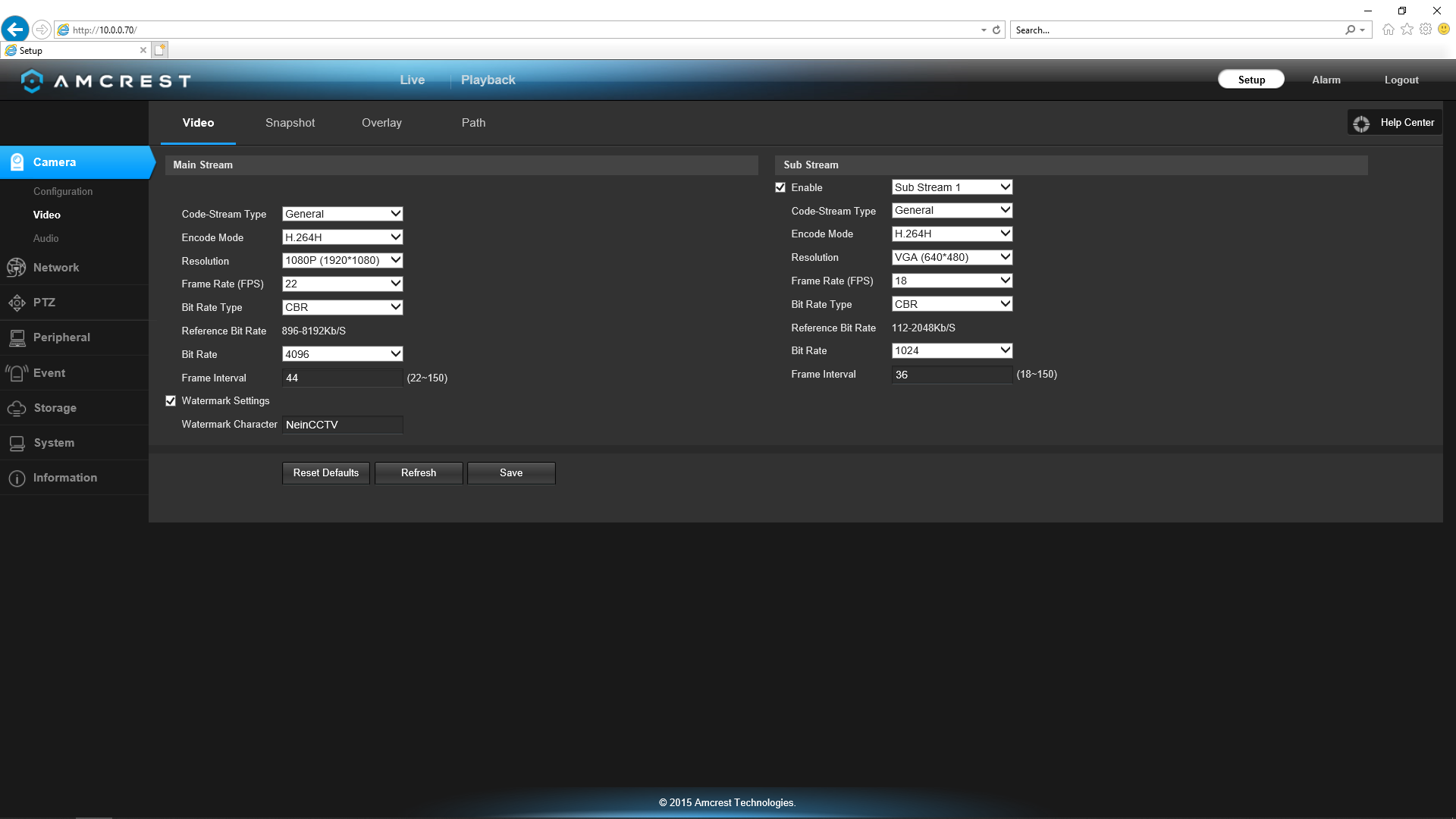

First I would double check that your Camera has a Sub Channel Turned on. If it is turned on I would double check that the Channel is within the Format that the Amcrest can run. Like. 640x480 or 704x480 as a couple of formats...
Taking a Picture of the Settings Screen of your camera would help some. For an idea of what I am talking about see picture Below.
So the 4116-A2 is new Higher Tech then most of my NVR's However it is on about the same type FW that I am running on most of my NVR's so I will try and break it down to what I think it might be..

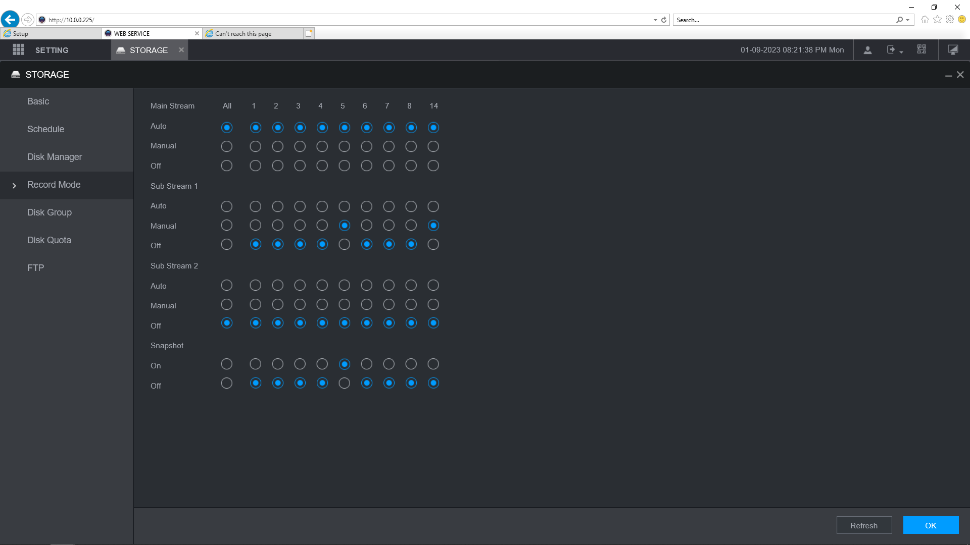

Personally not sure, I didn't even know the W6 could connect to a Amcrest NVR. Maybe your working on RSTP format as I didn't know the W6 had ONVIF. However I would connect with your cameras app and setup the Motion grid in the app and see if it gets pulled into the NVR? Not sure it will and in that case you would want to setup for Full time Recording and it does come standard that way so really I would change the settings if you didn't on the NVR to only work main stream as motion, alarm, and IVS.
Then setup on the NVR, Storage, Record, and for sub setup manual for the channels you want to record full time. This will record at the lower Encoding rate full time and the channels that are able to work with Motion will record at full encoding rate for them events.

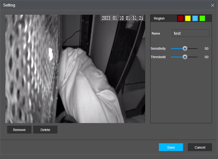

I'm rather certain the motion detection grid will not come up to set zones on the W6 and I do see a place in the wansview software where you can move a box around but... i really want to set it in the DVRl. Even my like 7-year-old Laview would do this sort of thing with grab-bag cameras.
Unless something is missing here I think this is going to be returned. I probably should have done my research on the camera compatibility issues.
The W6 has an option in the software to turn on ONVIF with or without authentication.
