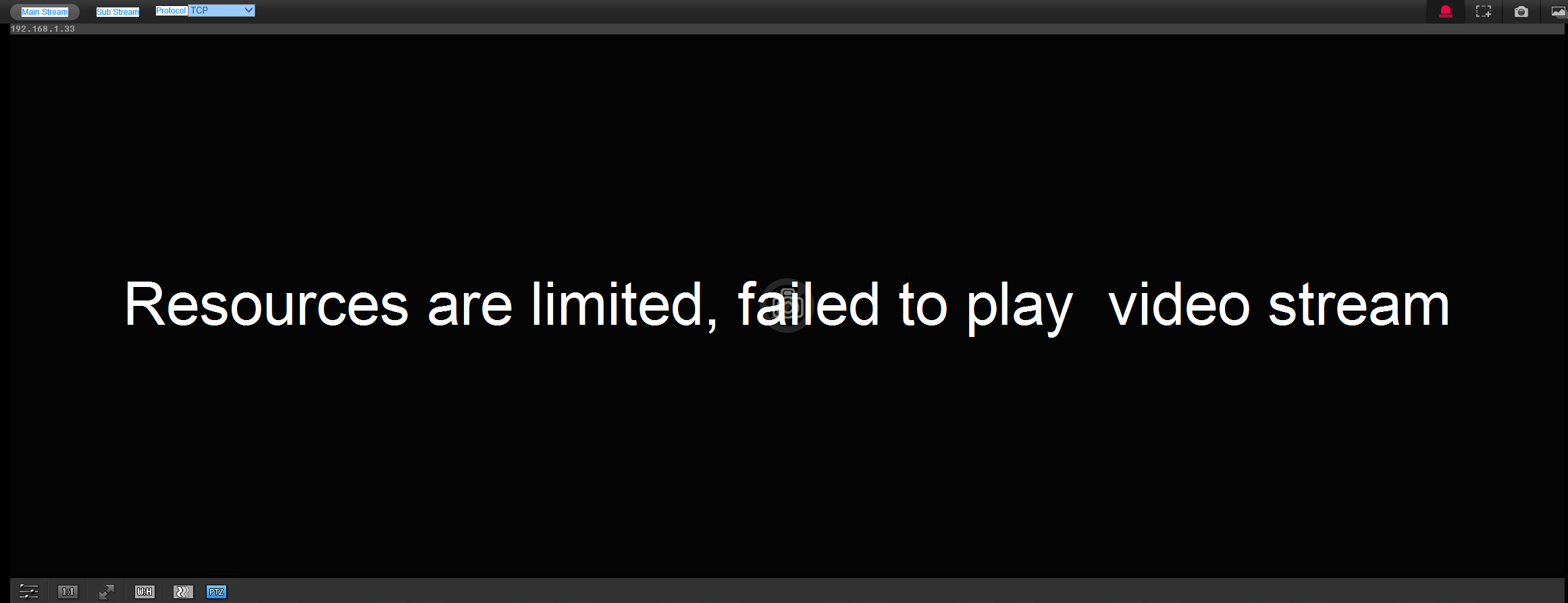

i just bought this camera over the weekend. As a Network engineer i take a lot of pride in the Enterprise grade devices in my home that support the connections that i care about. I had a foscam before this and was able to do 960p without problem. I get this cam and do a firmware upgrade before i do anything and i have encourntered bugs and very very laggy video with disconnects. My cam is wired in to my network so wifi does not play a part here. Are we really suggesting i do another factory reset to fix this issue? When will it be time to have the developers step in and release another update that resolves these issues? To tell you the truth i am one step from returning this device to the store and going with another similar product. Please help here!

I did a factory reset and the issue still persist. When i connect to the camera via HTTP i see the Limited Resource are available message which points to the OP statement about the latest firmware update taxing the resources to a loaded point which is causing this issue. This is quite sad actually as i just bought this camera 48 hours ago and i have yet to see it work correctly. I have attached an image to paint a clearer picture.
