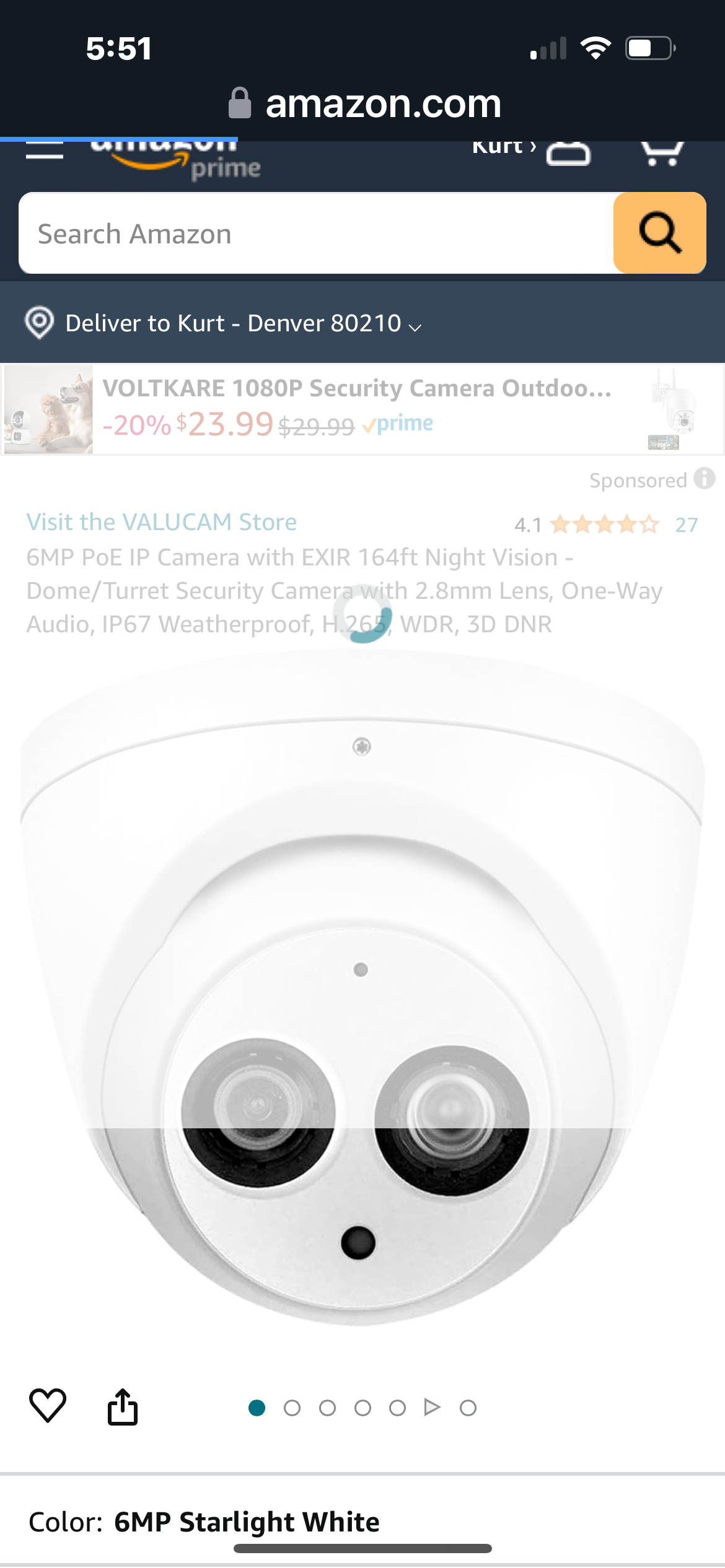

We recently bought a home with an arm rest nvr and multiple cameras. After resetting the NVR the two valucam 6mp cameras won’t connect to nvr. Status red

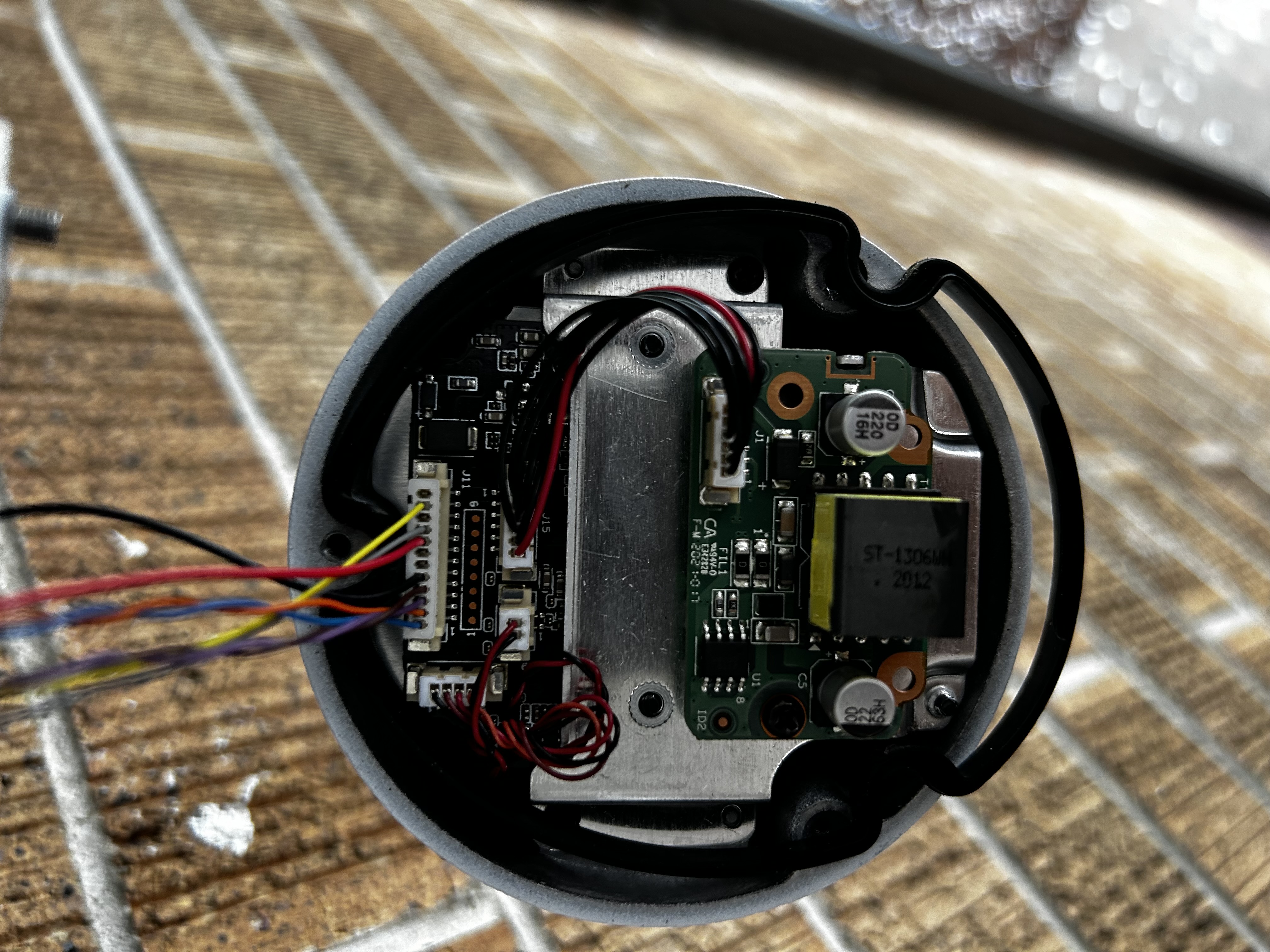

Unfortunately my camera doesn’t seem to have a SD CARD and I can’t seem to find the reset. I did pull it apart to show in case you see something

Okay, it looks like you might need to delve a bit deeper into the camera setup. The top board primarily functions as the power board, so you won't find the reset option there. If there's a concealed reset feature, you'll likely have to remove the two screws holding the camera board in place. Be cautious, though, as there are two mount pins helping to position it. It's important to verify this before attempting to remove it forcibly, as there could be additional fasteners.
Also, be mindful of a potential bushing securing the camera lens, preventing infrared leakage. Any force required for removal should be minimal. You definitely don't want to undo the screws only to find hidden ones further complicating things.
Before proceeding with disassembly, try using a flashlight to inspect the sides of the camera board for a mini switch attached to the PCB. It might be tricky to spot, but if accessible without removing the board, it could save you time.
Should you need to remove the camera from the housing, exercise caution, especially if you locate the reset switch. Powering on the camera will likely be necessary to initiate the reset process.
Examining the camera's connections, I notice four Ethernet wires, a pair of power wires (red/black), and two additional wires. It's worth double-checking if these extra wires might contain a reset mechanism, possibly in the form of a switch covered by a cap at the end of the wire bundle near the power and Ethernet cables.
Considering the camera's cost and its inclusion with the house, your options narrow down to contacting the previous homeowner for password, if feasible, or replacing the camera if no reset option is found.
To summarize, first, inspect the wire bundle for a reset button. If none is found, use a flashlight to search for any reachable switches without further disassembly. If necessary, proceed with disassembly to locate a reset switch or an area designed for one. Some Amcrest cameras even require a paper clip for resetting, so keep that in mind as well. Remember the most out facing board with the wires going to J1 is the Power Board there is no reset function on that PCB it is the PCB lower into the housing that would have a Reset if there was one...

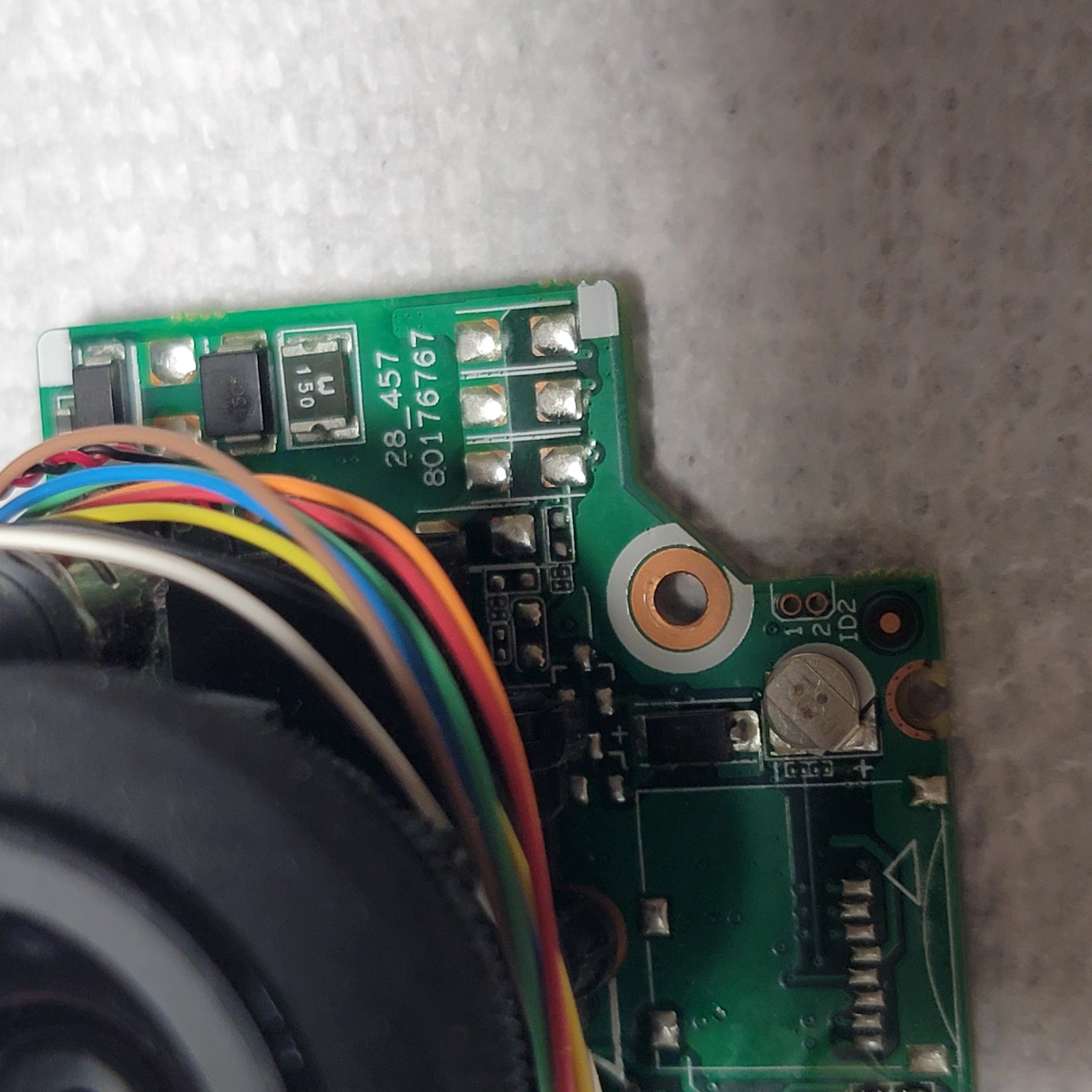

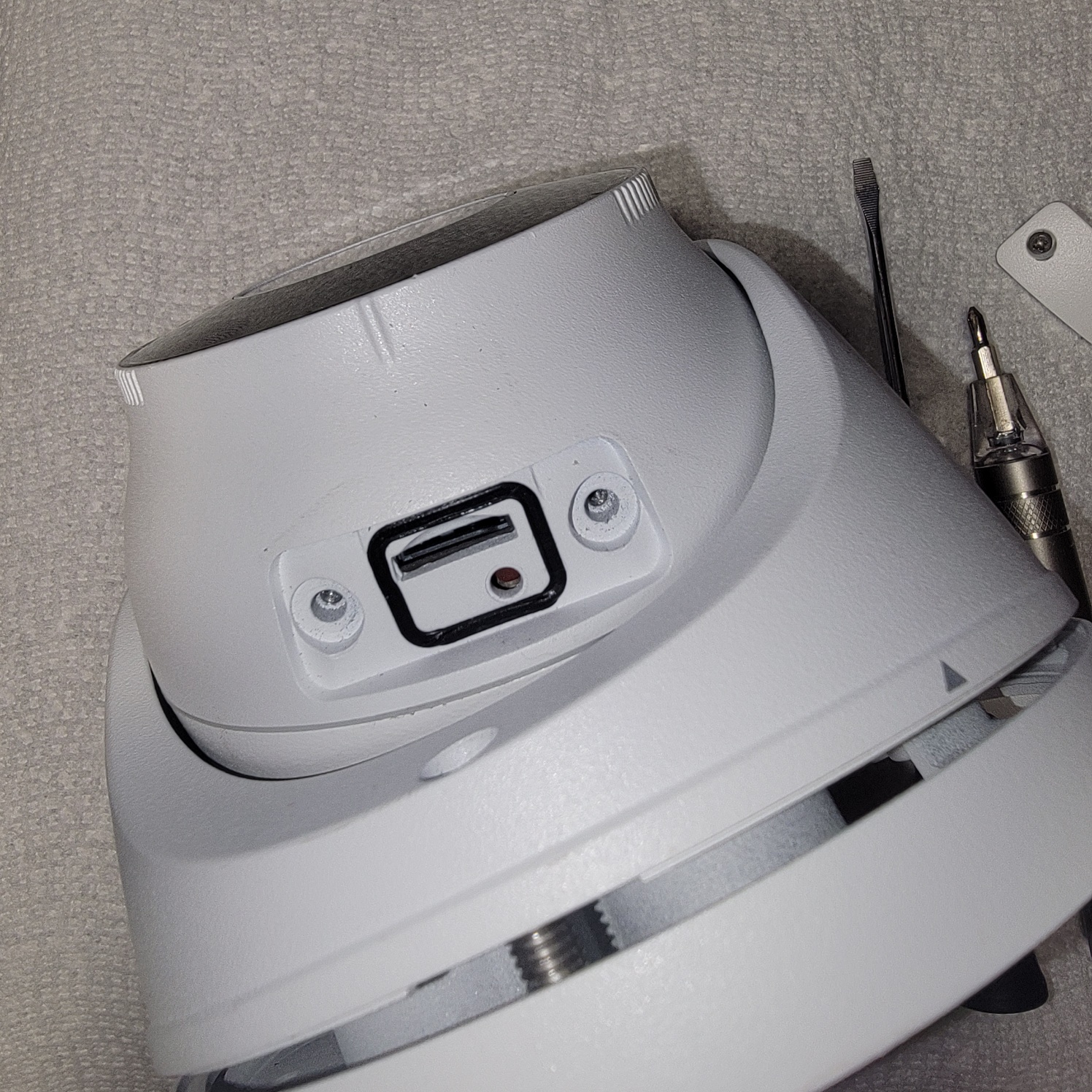

Thought I would show you what I am talking about. Have a camera here with same type of power board, this camera is a zoom camera that I now use as donor because power died in middle of update so camera dead in main chip. Anyway this camera had micro slot for SD that I pulled and put on a different camera that open area on left. But the reset for this camera is the 2 empty pads on right by id2. So to reset to factory on this camera would use tweezers that are able to pass current short the 2 pins and 5sec later it would reset.
