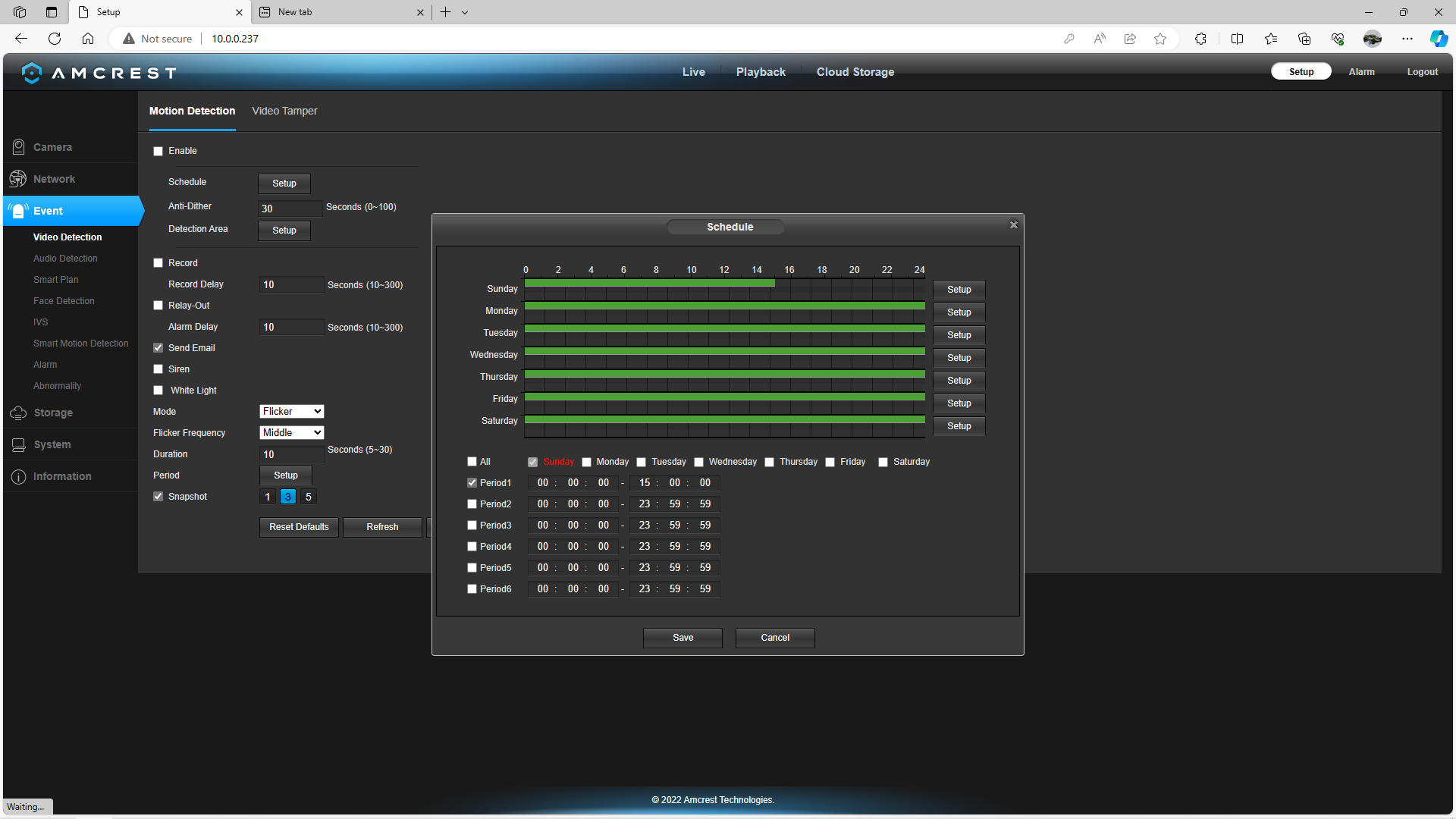

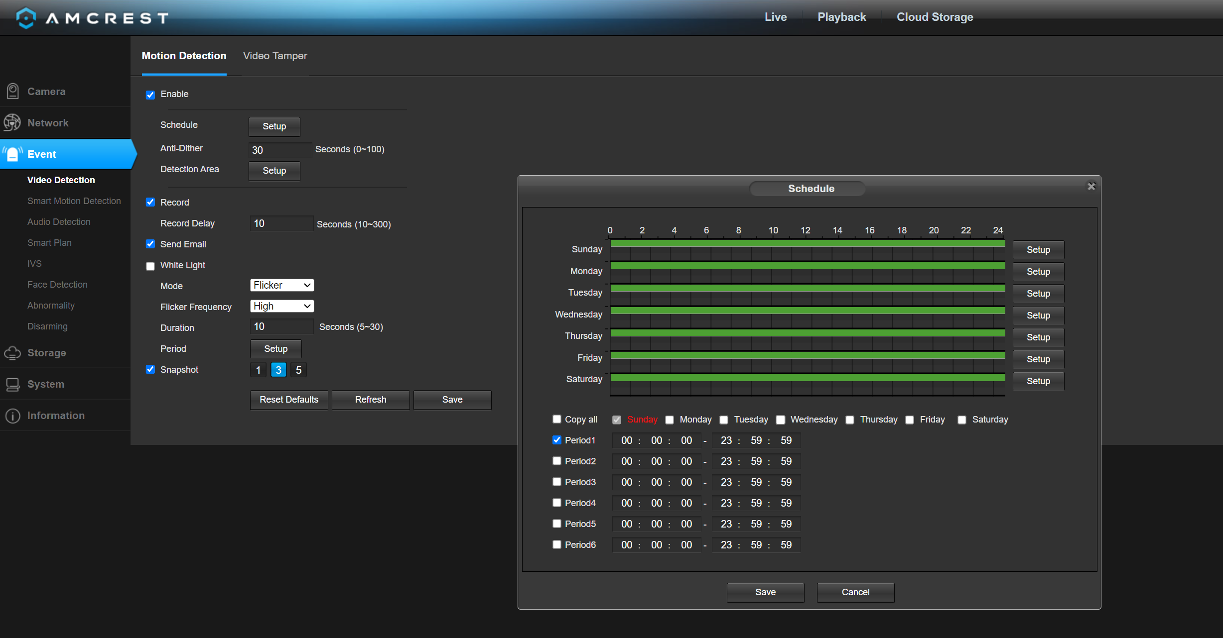

This is what I am seeing, before and after. Nothing I do from that API command is updating it
- Screenshot 2023-11-12 170417.png (264.64 KiB) Viewed 3686 times

table.MotionDetect[0].EventHandler.TimeSection[2][3]=0 00:00:00-23:59:59
table.MotionDetect[0].EventHandler.TimeSection[2][4]=0 00:00:00-23:59:59
table.MotionDetect[0].EventHandler.TimeSection[2][5]=0 00:00:00-23:59:59
table.MotionDetect[0].EventHandler.TimeSection[3][0]=1 00:00:00-23:59:59
table.MotionDetect[0].EventHandler.TimeSection[3][1]=0 00:00:00-23:59:59
table.MotionDetect[0].EventHandler.TimeSection[3][2]=0 00:00:00-23:59:59
table.MotionDetect[0].EventHandler.TimeSection[3][3]=0 00:00:00-23:59:59
table.MotionDetect[0].EventHandler.TimeSection[3][4]=0 00:00:00-23:59:59
table.MotionDetect[0].EventHandler.TimeSection[3][5]=0 00:00:00-23:59:59
table.MotionDetect[0].EventHandler.TimeSection[4][0]=1 00:00:00-23:59:59
table.MotionDetect[0].EventHandler.TimeSection[4][1]=0 00:00:00-23:59:59
table.MotionDetect[0].EventHandler.TimeSection[4][2]=0 00:00:00-23:59:59
table.MotionDetect[0].EventHandler.TimeSection[4][3]=0 00:00:00-23:59:59
table.MotionDetect[0].EventHandler.TimeSection[4][4]=0 00:00:00-23:59:59
table.MotionDetect[0].EventHandler.TimeSection[4][5]=0 00:00:00-23:59:59
table.MotionDetect[0].EventHandler.TimeSection[5][0]=1 00:00:00-23:59:59
table.MotionDetect[0].EventHandler.TimeSection[5][1]=0 00:00:00-23:59:59
table.MotionDetect[0].EventHandler.TimeSection[5][2]=0 00:00:00-23:59:59
table.MotionDetect[0].EventHandler.TimeSection[5][3]=0 00:00:00-23:59:59
table.MotionDetect[0].EventHandler.TimeSection[5][4]=0 00:00:00-23:59:59
table.MotionDetect[0].EventHandler.TimeSection[5][5]=0 00:00:00-23:59:59
table.MotionDetect[0].EventHandler.TimeSection[6][0]=1 00:00:00-23:59:59
table.MotionDetect[0].EventHandler.TimeSection[6][1]=0 00:00:00-23:59:59
table.MotionDetect[0].EventHandler.TimeSection[6][2]=0 00:00:00-23:59:59
table.MotionDetect[0].EventHandler.TimeSection[6][3]=0 00:00:00-23:59:59
table.MotionDetect[0].EventHandler.TimeSection[6][4]=0 00:00:00-23:59:59
table.MotionDetect[0].EventHandler.TimeSection[6][5]=0 00:00:00-23:59:59
table.MotionDetect[0].EventHandler.TipEnable=false
table.MotionDetect[0].EventHandler.Tour=0
table.MotionDetect[0].EventHandler.TourChannels[0]=0
table.MotionDetect[0].EventHandler.TourEnable=false
table.MotionDetect[0].EventHandler.Voice.AudioFileName=/usr/data/audiofiles/audios/alarm.wav
table.MotionDetect[0].EventHandler.Voice.PlayTimes=3
table.MotionDetect[0].EventHandler.VoiceEnable=false
table.MotionDetect[0].Level=3
table.MotionDetect[0].MotionDetectWindow[0].Id=0
table.MotionDetect[0].MotionDetectWindow[0].Name=Region1
table.MotionDetect[0].MotionDetectWindow[0].Region[0]=0
table.MotionDetect[0].MotionDetectWindow[0].Region[1]=0
table.MotionDetect[0].MotionDetectWindow[0].Region[2]=0
table.MotionDetect[0].MotionDetectWindow[0].Region[3]=0
table.MotionDetect[0].MotionDetectWindow[0].Region[4]=0
table.MotionDetect[0].MotionDetectWindow[0].Region[5]=0
table.MotionDetect[0].MotionDetectWindow[0].Region[6]=0
table.MotionDetect[0].MotionDetectWindow[0].Region[7]=0
table.MotionDetect[0].MotionDetectWindow[0].Region[8]=0
table.MotionDetect[0].MotionDetectWindow[0].Region[9]=0
table.MotionDetect[0].MotionDetectWindow[0].Region[10]=3584
table.MotionDetect[0].MotionDetectWindow[0].Region[11]=3584
table.MotionDetect[0].MotionDetectWindow[0].Region[12]=3584
table.MotionDetect[0].MotionDetectWindow[0].Region[13]=3584
table.MotionDetect[0].MotionDetectWindow[0].Region[14]=0
table.MotionDetect[0].MotionDetectWindow[0].Region[15]=0
table.MotionDetect[0].MotionDetectWindow[0].Region[16]=0
table.MotionDetect[0].MotionDetectWindow[0].Region[17]=0
table.MotionDetect[0].MotionDetectWindow[0].Sensitive=60
table.MotionDetect[0].MotionDetectWindow[0].Threshold=5
table.MotionDetect[0].MotionDetectWindow[0].Window[0]=3723
table.MotionDetect[0].MotionDetectWindow[0].Window[1]=4550
table.MotionDetect[0].MotionDetectWindow[0].Window[2]=4840
table.MotionDetect[0].MotionDetectWindow[0].Window[3]=6370
table.MotionDetect[0].MotionDetectWindow[1].Id=1
table.MotionDetect[0].MotionDetectWindow[1].Name=Region2
table.MotionDetect[0].MotionDetectWindow[1].Region[0]=0
table.MotionDetect[0].MotionDetectWindow[1].Region[1]=0
table.MotionDetect[0].MotionDetectWindow[1].Region[2]=0
table.MotionDetect[0].MotionDetectWindow[1].Region[3]=0
table.MotionDetect[0].MotionDetectWindow[1].Region[4]=0
table.MotionDetect[0].MotionDetectWindow[1].Region[5]=0
table.MotionDetect[0].MotionDetectWindow[1].Region[6]=0
table.MotionDetect[0].MotionDetectWindow[1].Region[7]=0
table.MotionDetect[0].MotionDetectWindow[1].Region[8]=0
table.MotionDetect[0].MotionDetectWindow[1].Region[9]=0
table.MotionDetect[0].MotionDetectWindow[1].Region[10]=0
table.MotionDetect[0].MotionDetectWindow[1].Region[11]=0
table.MotionDetect[0].MotionDetectWindow[1].Region[12]=0
table.MotionDetect[0].MotionDetectWindow[1].Region[13]=0
table.MotionDetect[0].MotionDetectWindow[1].Region[14]=0
table.MotionDetect[0].MotionDetectWindow[1].Region[15]=0
table.MotionDetect[0].MotionDetectWindow[1].Region[16]=0
table.MotionDetect[0].MotionDetectWindow[1].Region[17]=0
table.MotionDetect[0].MotionDetectWindow[1].Sensitive=60
table.MotionDetect[0].MotionDetectWindow[1].Threshold=5
table.MotionDetect[0].MotionDetectWindow[1].Window[0]=0
table.MotionDetect[0].MotionDetectWindow[1].Window[1]=0
table.MotionDetect[0].MotionDetectWindow[1].Window[2]=0
table.MotionDetect[0].MotionDetectWindow[1].Window[3]=0
table.MotionDetect[0].MotionDetectWindow[2].Id=2
table.MotionDetect[0].MotionDetectWindow[2].Name=Region3
table.MotionDetect[0].MotionDetectWindow[2].Region[0]=0
table.MotionDetect[0].MotionDetectWindow[2].Region[1]=0
table.MotionDetect[0].MotionDetectWindow[2].Region[2]=0
table.MotionDetect[0].MotionDetectWindow[2].Region[3]=0
table.MotionDetect[0].MotionDetectWindow[2].Region[4]=0
table.MotionDetect[0].MotionDetectWindow[2].Region[5]=0
table.MotionDetect[0].MotionDetectWindow[2].Region[6]=0
table.MotionDetect[0].MotionDetectWindow[2].Region[7]=0
table.MotionDetect[0].MotionDetectWindow[2].Region[8]=0
table.MotionDetect[0].MotionDetectWindow[2].Region[9]=0
table.MotionDetect[0].MotionDetectWindow[2].Region[10]=0
table.MotionDetect[0].MotionDetectWindow[2].Region[11]=0
table.MotionDetect[0].MotionDetectWindow[2].Region[12]=0
table.MotionDetect[0].MotionDetectWindow[2].Region[13]=0
table.MotionDetect[0].MotionDetectWindow[2].Region[14]=0
table.MotionDetect[0].MotionDetectWindow[2].Region[15]=0
table.MotionDetect[0].MotionDetectWindow[2].Region[16]=0
table.MotionDetect[0].MotionDetectWindow[2].Region[17]=0
table.MotionDetect[0].MotionDetectWindow[2].Sensitive=60
table.MotionDetect[0].MotionDetectWindow[2].Threshold=5
table.MotionDetect[0].MotionDetectWindow[2].Window[0]=0
table.MotionDetect[0].MotionDetectWindow[2].Window[1]=0
table.MotionDetect[0].MotionDetectWindow[2].Window[2]=0
table.MotionDetect[0].MotionDetectWindow[2].Window[3]=0
table.MotionDetect[0].MotionDetectWindow[3].Id=3
table.MotionDetect[0].MotionDetectWindow[3].Name=Region4
table.MotionDetect[0].MotionDetectWindow[3].Region[0]=0
table.MotionDetect[0].MotionDetectWindow[3].Region[1]=0
table.MotionDetect[0].MotionDetectWindow[3].Region[2]=0
table.MotionDetect[0].MotionDetectWindow[3].Region[3]=0
table.MotionDetect[0].MotionDetectWindow[3].Region[4]=0
table.MotionDetect[0].MotionDetectWindow[3].Region[5]=0
table.MotionDetect[0].MotionDetectWindow[3].Region[6]=0
table.MotionDetect[0].MotionDetectWindow[3].Region[7]=0
table.MotionDetect[0].MotionDetectWindow[3].Region[8]=0
table.MotionDetect[0].MotionDetectWindow[3].Region[9]=0
table.MotionDetect[0].MotionDetectWindow[3].Region[10]=0
table.MotionDetect[0].MotionDetectWindow[3].Region[11]=0
table.MotionDetect[0].MotionDetectWindow[3].Region[12]=0
table.MotionDetect[0].MotionDetectWindow[3].Region[13]=0
table.MotionDetect[0].MotionDetectWindow[3].Region[14]=0
table.MotionDetect[0].MotionDetectWindow[3].Region[15]=0
table.MotionDetect[0].MotionDetectWindow[3].Region[16]=0
table.MotionDetect[0].MotionDetectWindow[3].Region[17]=0
table.MotionDetect[0].MotionDetectWindow[3].Sensitive=60
table.MotionDetect[0].MotionDetectWindow[3].Threshold=5
table.MotionDetect[0].MotionDetectWindow[3].Window[0]=0
table.MotionDetect[0].MotionDetectWindow[3].Window[1]=0
table.MotionDetect[0].MotionDetectWindow[3].Window[2]=0
table.MotionDetect[0].MotionDetectWindow[3].Window[3]=0
table.MotionDetect[0].OsdTwinkleEnable=false
table.MotionDetect[0].PirMotionLevel=3
table.MotionDetect[0].PtzManualEnable=true
table.MotionDetect[0].Region[0]=0
table.MotionDetect[0].Region[1]=0
table.MotionDetect[0].Region[2]=0
table.MotionDetect[0].Region[3]=0
table.MotionDetect[0].Region[4]=0
table.MotionDetect[0].Region[5]=0
table.MotionDetect[0].Region[6]=0
table.MotionDetect[0].Region[7]=0
table.MotionDetect[0].Region[8]=0
table.MotionDetect[0].Region[9]=0
table.MotionDetect[0].Region[10]=3584
table.MotionDetect[0].Region[11]=3584
table.MotionDetect[0].Region[12]=3584
table.MotionDetect[0].Region[13]=3584
table.MotionDetect[0].Region[14]=0
table.MotionDetect[0].Region[15]=0
table.MotionDetect[0].Region[16]=0
table.MotionDetect[0].Region[17]=0Be Safe.
Re: Unable to adjust MotionDetect[0].EventHandler.TimeSection via api
This is from my other camera both are running Motion Detection V3 not sure if that is an issue for your camera or not but maybe something again could be an issue with your camera
Code: Select all
table.MotionDetect[0].DetectVersion=V3.0
table.MotionDetect[0].Enable=false
table.MotionDetect[0].EventHandler.AlarmOut=1
table.MotionDetect[0].EventHandler.AlarmOutChannels[0]=0
table.MotionDetect[0].EventHandler.AlarmOutEnable=true
table.MotionDetect[0].EventHandler.AlarmOutLatch=10
table.MotionDetect[0].EventHandler.BeepEnable=false
table.MotionDetect[0].EventHandler.Dejitter=5
table.MotionDetect[0].EventHandler.Delay=0
table.MotionDetect[0].EventHandler.ExAlarmOut=1
table.MotionDetect[0].EventHandler.ExAlarmOutChannels[0]=0
table.MotionDetect[0].EventHandler.ExAlarmOutEnable=false
table.MotionDetect[0].EventHandler.FlashEnable=false
table.MotionDetect[0].EventHandler.FlashLatch=10
table.MotionDetect[0].EventHandler.LightingLink.Enable=false
table.MotionDetect[0].EventHandler.LightingLink.FilckerIntevalTime=5
table.MotionDetect[0].EventHandler.LightingLink.FilckerLightType=WhiteLight
table.MotionDetect[0].EventHandler.LightingLink.FilckerTimes=5
table.MotionDetect[0].EventHandler.LogEnable=true
table.MotionDetect[0].EventHandler.MailEnable=false
table.MotionDetect[0].EventHandler.Matrix=1
table.MotionDetect[0].EventHandler.MatrixChannels[0]=0
table.MotionDetect[0].EventHandler.MatrixEnable=false
table.MotionDetect[0].EventHandler.MessageEnable=false
table.MotionDetect[0].EventHandler.PtzLink[0][0]=None
table.MotionDetect[0].EventHandler.PtzLink[0][1]=0
table.MotionDetect[0].EventHandler.PtzLinkEnable=false
table.MotionDetect[0].EventHandler.Record=1
table.MotionDetect[0].EventHandler.RecordChannels[0]=0
table.MotionDetect[0].EventHandler.RecordEnable=true
table.MotionDetect[0].EventHandler.RecordLatch=10
table.MotionDetect[0].EventHandler.Snapshot=1
table.MotionDetect[0].EventHandler.SnapshotChannels[0]=0
table.MotionDetect[0].EventHandler.SnapshotEnable=true
table.MotionDetect[0].EventHandler.TimeSection[0][0]=1 00:00:00-15:00:00
table.MotionDetect[0].EventHandler.TimeSection[0][1]=0 00:00:00-23:59:59
table.MotionDetect[0].EventHandler.TimeSection[0][2]=0 00:00:00-23:59:59
table.MotionDetect[0].EventHandler.TimeSection[0][3]=0 00:00:00-23:59:59
table.MotionDetect[0].EventHandler.TimeSection[0][4]=0 00:00:00-23:59:59
table.MotionDetect[0].EventHandler.TimeSection[0][5]=0 00:00:00-23:59:59

Your table information more or less matches mine, I am also on v3.0:
This is happening on all four of my cameras, so I'm not sure what else may be going on there. This is the only command I have not been able to send to it successfully so far.
I may go and try to reset one to factory, just to be sure that I didn't malform something and mess up the config, although I doubt that is what is going on here.
Full factory reset did not solve the issue. Not sure what else to go with this one.
If anybody else has something that I could try, please let me know.
Thank you!
Thank you!
Just to give a quick update. I still have not been able to get this working with the standard api. It simply will not take those commands.
After doing some searching here, I found this is not an isolated issue and found several other people reporting similar issues. So I am just going to assume it is a firmware issue.
However, I was able to get it working another way, using the web gui endpoint and payloads. Replicated the gui's login system and replicated it in code to get a session though RPC2_Login, and then passed in the entire payload to the RPC2 endpoint for changing the settings in Event => Video Detection. It works, although it is a little janky. It is, however, the only method that I can get to work at this point in time.
