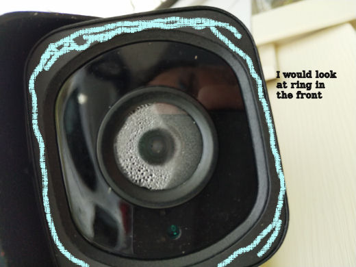

Here is a Picture of what I am talking about.. .I did take your Picture for reuse.. resized it and added some text and blue around what I am talking about... Hope this helps and this is really where the Entry point is, again this is a guess seeing it is a shaped camera it would be hard to have a screw on and off only

Well your picture is correct, under that ring are the screws to get the cover off. I was just gonna post a picture. I was too impatience and basically destroyed the camera to figure this out, before I saw your post. Oh well live and learn. Under that ring is four screws then the cover comes off.

Sorry to hear that... I tired to give all the info I could as fast as I could think of how things might be... Sadly I guess I was to late to the Table with my Idea about things I seen... It wasn't until I looked at your First picture I seen the part that I thought hummm wonder if that comes off and as soon as I seen that I thought I better share what I think it could be...

From the destroyed camera I learned that the face front ring highlighted in blue by the previous poster is just a sticker... so if you come at the face of it on an outer edge you'll easily get behind it and be able to peel the sticker away revealing access to the 4 phillips screws which hold the front on.
For my condensation filled camera I'm 99% sure that the rubber gasket wasn't installed correctly, which is how moisture likely got in. I was able to open it up and wipe out the condensation in about 2 minutes using nothing more than a small phillips screw driver, and put the sticker back so it appeared virtually untouched.
