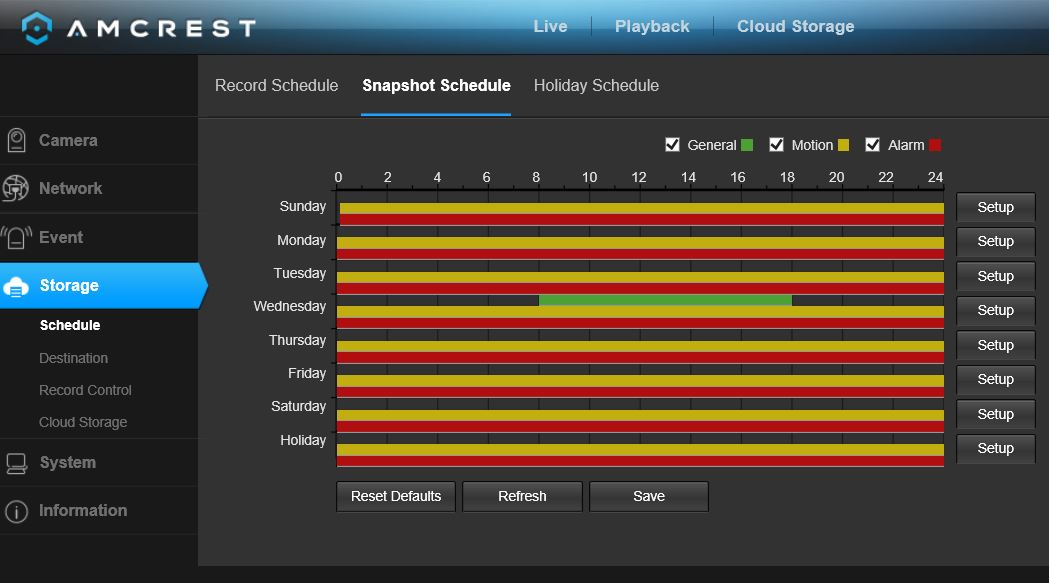

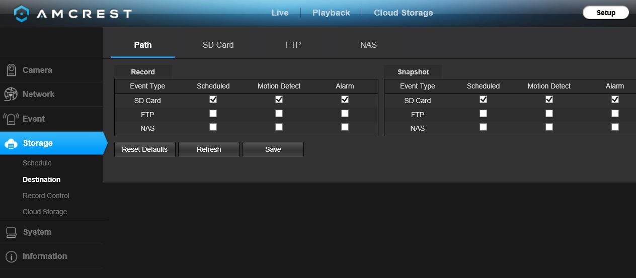

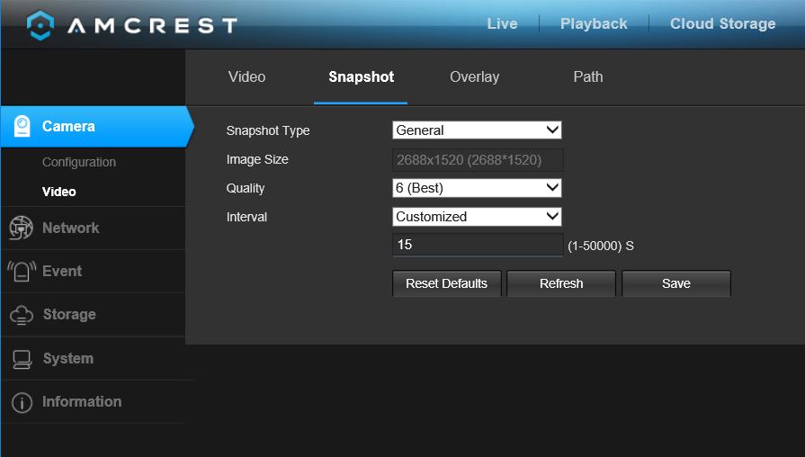

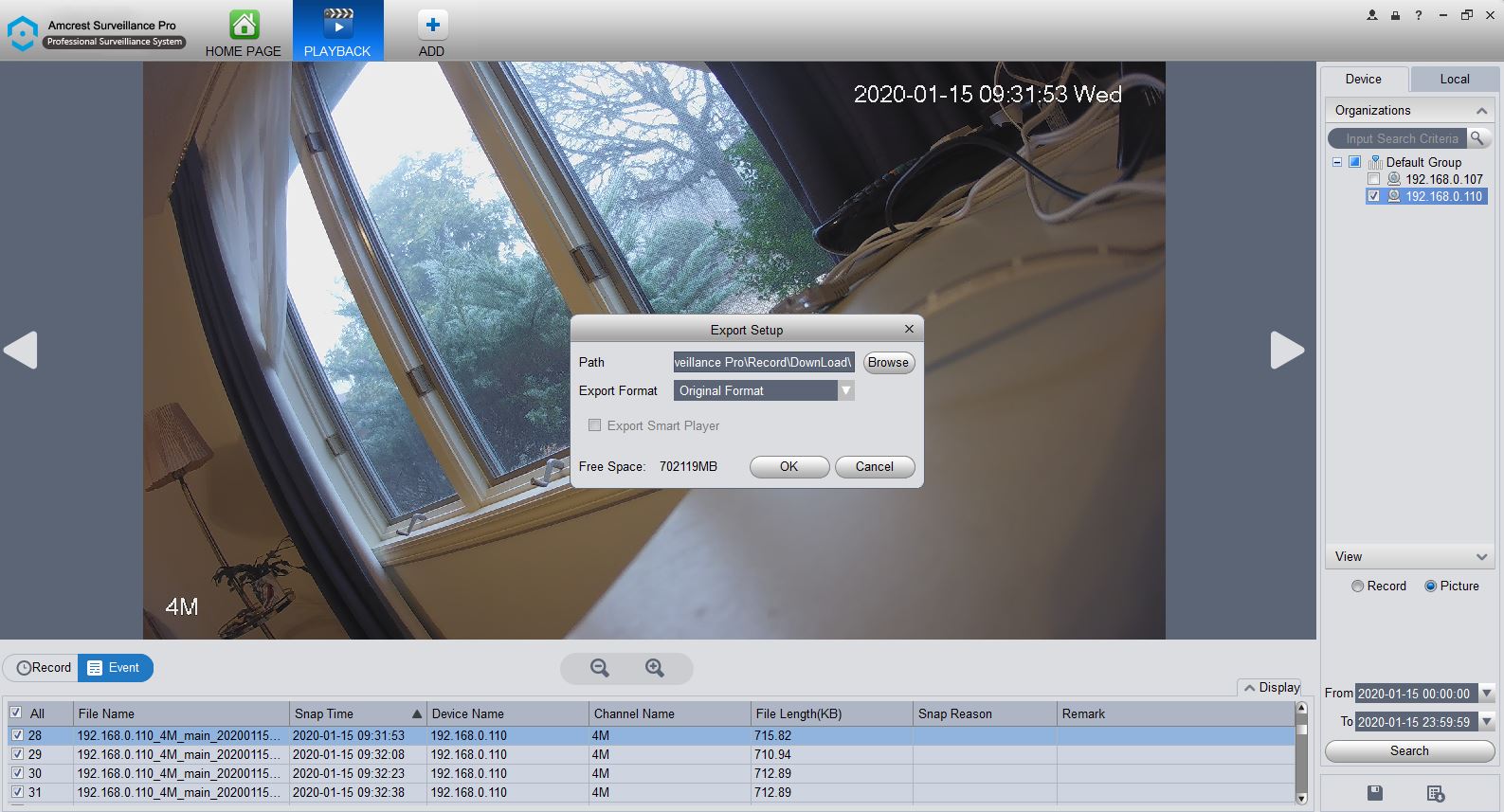

In camera Web UI: Set up General(green) time periods to capture snapshots in Snapshot Schedule. In Amcrest View Pro to batch export any or all snapshots from SD card to PC, go to Playback, click Event, click camera, enable Picture, select time frame, Search, select snapshots to export, click Export (1st icon at bottom right), and select folder to export to.

. The ASP screen I posted shows all the snapshots at 15 seconds intervals as I had specified. I just tried 1 second intervals for a while and then 5 minute intervals. Results looked fine. I am using a SD card. Perhaps your inaccurate results were because you were using FTP or NAS, or competing with other events recording on the same storage device. Just guessing...
