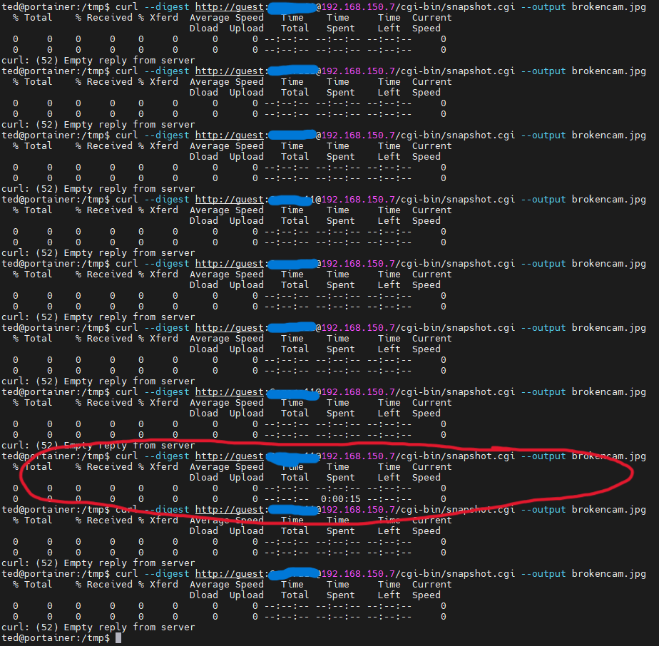

the T2499E has been a great camera. I placed it high up under my eves when we built an addition about 2 years ago. But recently I've been having issues. I contacted support but they have not had a response in 5+ days. (Request 443008, in case anyone from support is reading this.)
The issue is that I pretty consistently don't get an image. It seems to work most all the time using a browser UI. But using the android app, it fails to connect about half the time. But when I use curl to retrieve images, it fails the majority of the time. "Empty reply from server". So I assume that is similar to the response seen by android app... but hidden behind the scenes.

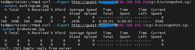

As you can see in the screen shot, I can try repeatedly and get failures the vast majority of the time. One one of the 10 tries worked in that example.
And just to show it's not a client (curl) issue, you can see it work on a different camera (192.168.150.14) at the same time it fails for this (192.168.150.7) camera.
I have flashed it to the current firmware. Power cycled it (by pulling plug on POE). And that's all I can do since the camera is physically 30 feet overhead on an ice and snow covered hill right now. So getting my hands on it is way difficult.
Short of the device simply starting to die of old age, are there any recommendations for troubleshooting or remedying this? If not, I'll just be making a single trip up the ladder to swap it out with a different camera instead.

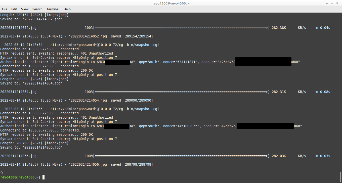

So I don't normally setup and use Curl however after seeing your post I thought I would setup a couple of different things from my Linux box and see what I get. For me what is odd on both a Curl and a Wget the camera gives only 1 image before it errors out. Now for my setup I get a Bad image in the folder and looking at the command I get 0 for the items that don't make it. So i moved my 8mp camera into the same line of my 4mp camera that I ran same Curl and Wget commands on and I get good pictures. So I thought maybe bad connections. Setup, Tested again and same results (Meaning no longer getting images.) I even changed the encoding down to h.264, changed from 8mp down to 1080 trying 6mp, 5mp, 4mp, 3mp and all of them get 0 images..
No the Wget I am not sure what the issue is. Maybe it isn't input correctly. I say this because for me I get 1 image right after I send the command however the next image no longer has my user and password it shows info from Digest and the command line auto changes to admin:password and then I get 500 error. I run command again I get 1 image, then error so I am going to guess it is something in my wget command that is wrong for format of Amcrest Camera.
However sending that same Wget command to my 1046EW-AI 4mp camera it makes an image without an error just fine, So I am thinking issue is camera related and not cable or port related that I first thought might be the issue for me.
I say this because while the 4mp still works on the Wget there is an Error that is 401 about Unauthorized, However the 8mp camera on this error fails from there on with the Wget command, it does show Auth info in the repeated command line from second on just no longer shows the real password it just says password in that area?
So when I first ran the Curl command I am using (different then yours) I got 1 image then fail from then on even changing locations. I even took a laptop that I have Unbuntu back to the Switch and ran the commands there as well thinking maybe I had network lag that was causing the issues and same results from both locations..

So I was wrong about what I posted above.. I looked at my camera again and thought I would see what my Snapshot settings are setup for 3600.. So I changed that to 1s and now I am able to get a snapshot every second as per my Curl command.
Just ran the Wget again and it does work as well even with the 401 error this time it no longer shows a 500 error..
So for my camera I changed to allow image every second, also already had it setup for full time image snapshot as I had it going to my email server..

So here is an image of my images being made after making that change in the snapshot setting area of the camera.

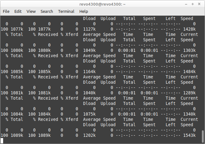

also thought I would post my command so there is no question to why or how it is working on a constant output incase there are others that are reading and wondering how or why
while :; do curl --digest -o "$(date +"%Y%m%d%H%M%S").jpg" http://admin:Password@10.0.0.72/cgi-bin/snapshot.cgi; sleep 1; done
For me this is a command I use when I want to make a time lapse of one of my cameras. I normally don't post things like this as others most times already know how to make commands better then I.
However incase other want to use it, just change the user and pass and the ip address of the camera.
I also use ffmpeg to format a time lapse after the fact and works well..
Here is the wget command I use also both work for my cameras
while :; do wget -O "$(date +"%Y%m%d%H%M%S").jpg" http://admin:Password@10.0.0.72/cgi-bin/snapshot.cgi; sleep 1; done
hope this helps anyone that is looking to take constant snapshots. I don't personally like having to use year month day format however seems to work best this way others might have better code this is what works for me.
Commands above will go on forever unless you hit ctrl-c however I am sure you already know this, trying to be clear as I can...
