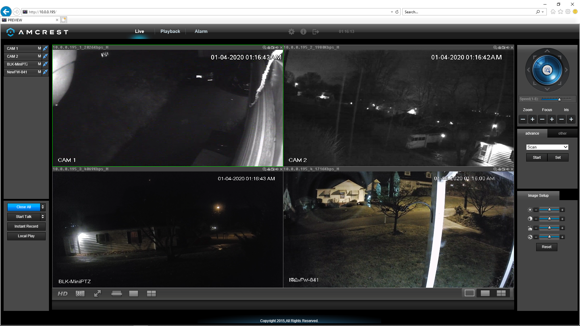

Hello... So I tried to Reboot the camera and even turned off the feature adding it back in and turned it back on and still didn't help
So Right now my New FW 841 as of today I noticed that it was acting strange and falling behind my other cameras in my system setup... I just delt with it because well sometimes it just like to act like a POS but normally fixes it self... Well tonight it isnt fixing anything and even after a Reboot, Modem Reboot, Computer Reboot, Camera reboot, DVR reboot, PC-NVR reboot this thing is just ticking me off lol...
So besides the Time falling behind by 20 seconds... It will stall at times and get back to about 40sec behind and then you can see it speedup but stays 20 seconds behind... I tell Computer to set time it does, I have my DVR sync time with all cameras and it does and yet this camera don't lol
I turned off PC-NVR, FTP, turned off my MSD by not recording to it at all. I deleted it out of my DVR and turned back on PC-NVR still don't want to sync with anything
However all in all it seems odd that all this issue along with some Strange Overlay issues as well... Last time Amcrest Logo came up this time that isn't the issue Today big issue and what I turned off and back on yet the poor camera is confused and that is IPC in the bottom left corner is Under what I had typed there NewFW-841 yet you can't make out the New or the IPC.... So I turned off the feature then took out and it just don't want to go away....
Good news is the Presets are still in and right lol...

Also an update on the one in the picture above... It still BROKE lol... Still has IPC and the Name Mixed together Geez.....
