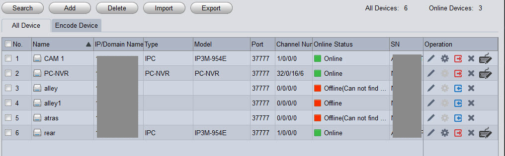

I am really fed up with this. It's a constant job to keep these things going. Things are always going wrong ALL BY THEMSELVES. No changes to the computer, nothing at all, and all of a sudden, I realize nothing is being recorded. Other times, I see the camera images, and realize I'm looking at a frozen image that hasn't moves for hours. Today, the PC-NVR is on the list, but it doesn't see the cameras that are on the list. All options on the PC-NVR are grayed out. I deleted it, I re-installed it, same thing. I can deleted the cameras, reinstalled them, same thing. For no reason at all, things are different today, than they were yesterday, and I CANNOT record because the PC-NVR is not working. Restarted the computer, restarted the PC-NVR application, rebooted the router. Nothing. And it's Sunday, so no tech help. This stuff happens often enough that it's more aggravating than not to be able to see who let their dog shit on your lawn. Time to try a different system, or hang it up.
The 3 devices that are marked as RED, were the same as the device called REAR. They all stopped working, and I had to re add them. Finally, the one called REAR decided it would stay put, not change IP address.
In this picture:
You can clearly see that all VALID devices are on and recognized, but NOT by the NVR.

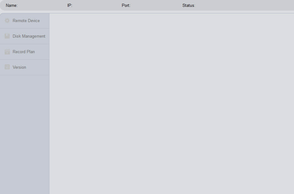

This is what the PC-NVR page looks like.
No cameras, not hard drives. Nothing. So fed up.
