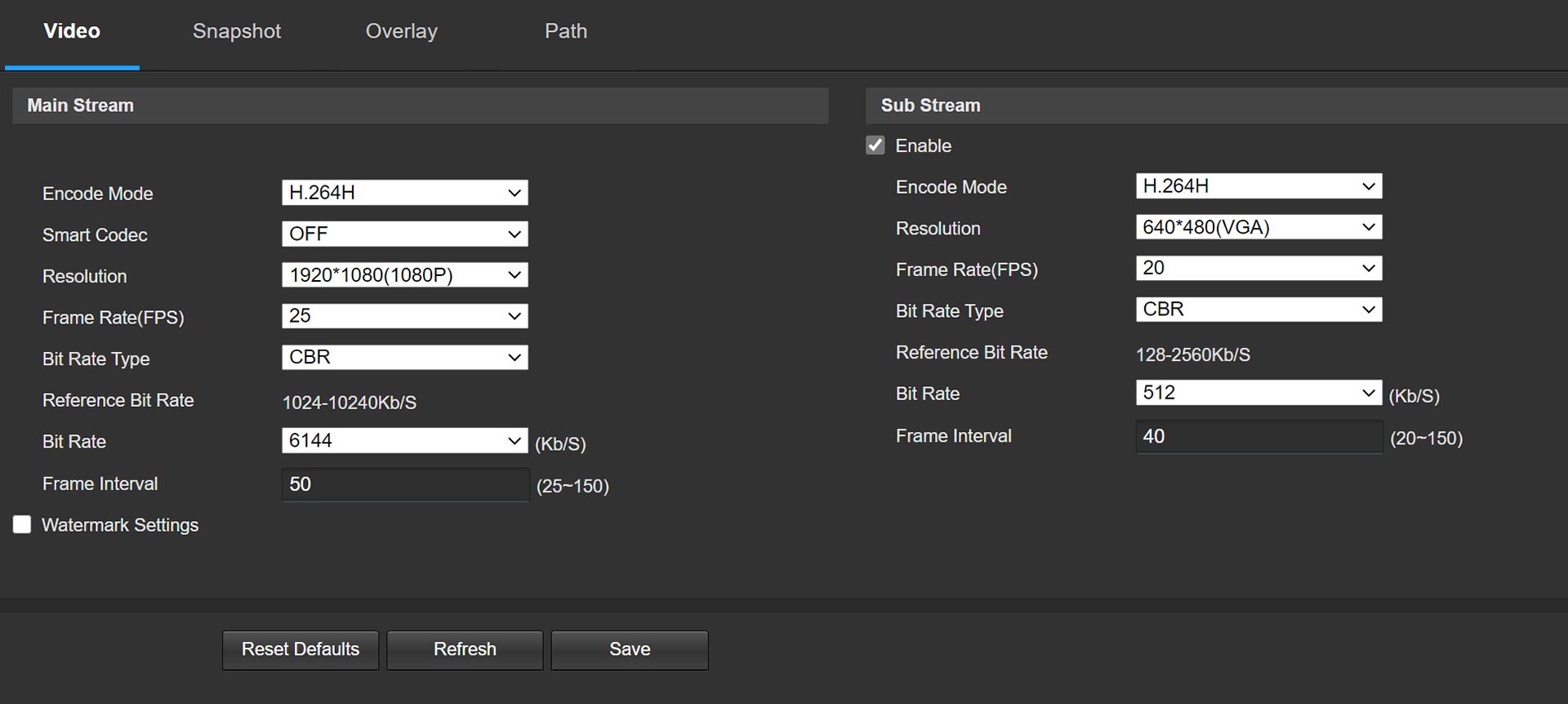

Found something:
I had the sub stream configured to use MJPEG. When I change it back to H264, then the snapshot.cgi works again!
Although, the snapshots are being taken from the main stream.
Now, I'll test how stable this is.

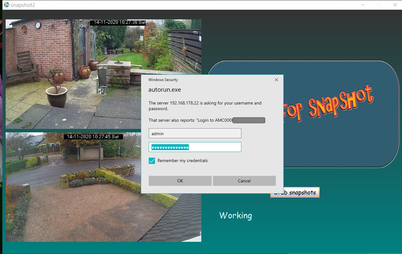

@sidamos - Your post brought me back to an old project which I had given up on. Bearing in mind what you said about changing the substream settings, I checked the video settings on all three cameras and set them all the same -
After 24 hours, I'm still getting snapshots every time so I've resurrected the app I was making to grab snapshots from my cameras and then ftp the images to my website. It's working except that credentials embedded in the http: call aren't accepted by Windows security and I have to click OK for each snapshot so I'm down to 4 clicks for the whole process -
Reducing the amount of data that the camera is having to transmit by changing the settings seems to have worked so, nice find

I don't think, it is the reducing amount of data. I just think, that setting the sub stream to MJPEG causes some issues with snapshot creation, although it uses the main stream. Glad it works for you now.
