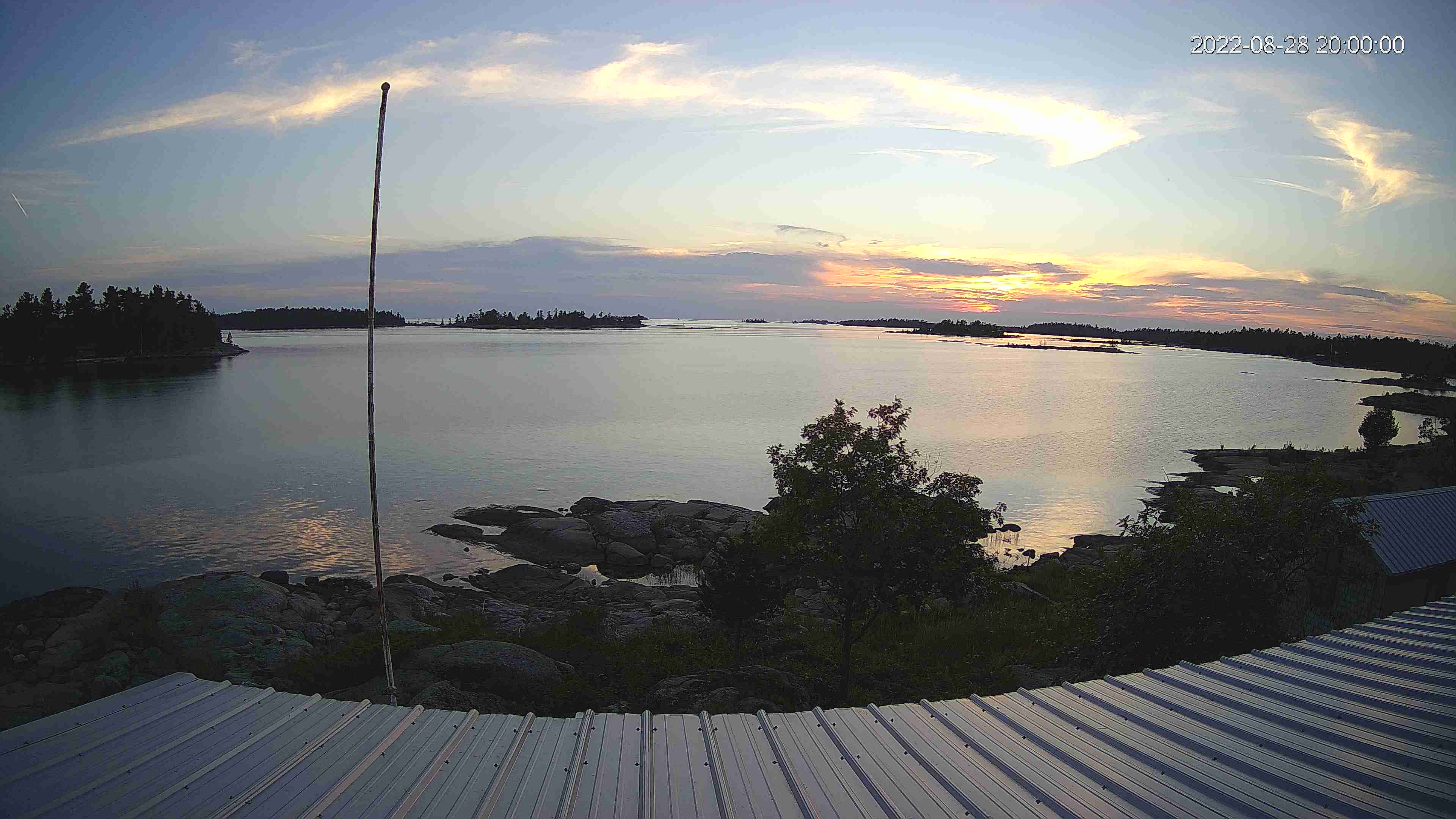

I definitely want timed, not trigger. Trigger is based on motion -- this cam is pointed out at the water, there's always motion. Timed is just what the doctor ordered. I absolutely adjusted the interval -- 300 for testing, 3600 normally. Cellular plan doesn't give me a lot of data, although its cheap enough I could increase it, but I'm not looking for anything close to real-time. Storage also won't support one second interval. I want one picture per hour for several years. I'll attach a picture below, so yo have some idea why I'm doing this. :D
I want one picture per hour... But I also wrote a script (will run on the cellular box) which figures out the time of sunset, and grabs a picture of that. It turns out right now sunset is near the top of the hour, but I don't have a single sunset picture in all of July, the last good one was in the middle of June. If I can get that script to work, I can also send an SMS to the cellular box for a "picture on demand".
If I'm understanding what you're saying, interval being set above one second causes the camera to only take a snapshot that often, no matter what. Explains why I see a new picture via FTP any time I change that setting.
If that be the case, it would seem like my life will be a lot simpler if I completely disable FTP on the camera, set the interval back to 1 second, and use the script to get all the pictures rather than only on-demand. That would also mean I can control the directory structure, and get rid of 001/jpg/ and sane filenames. (the camera does have an SD card, I could let it do motion snapshots or something, and check them out next year when I'm there).

Well it is a very nice Scene. It is very busy and if your only going to look at data on the camera 1 time a year there are a few things you will want to do to keep your camera going the whole year.
