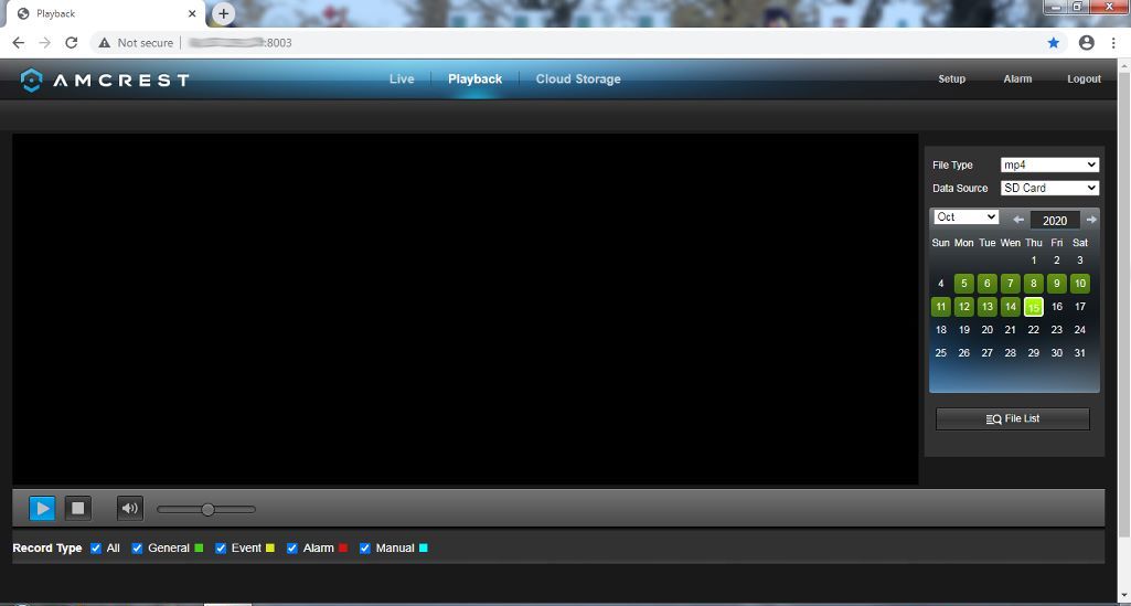

Is there a way to do a simple playback of video from an IP8M-T2499E with the later Oct 2019 firmware?
...without having to first download a big block of video?
The playback screen has a PLAY button that does nothing, making me think Ive overlooked something obvious...
Simple playback

You need to click the "file list" button after selecting the date, double click the file you want which will load the video.
Re: Simple playback
That actually worked, thank you!danwithacam wrote: ↑Fri Oct 30, 2020 4:59 am You need to click the "file list" button after selecting the date, double click the file you want which will load the video.
There was no indication that was possible (like a mouse-over reaction, or decent documentation), just the download arrow to download the big file.
