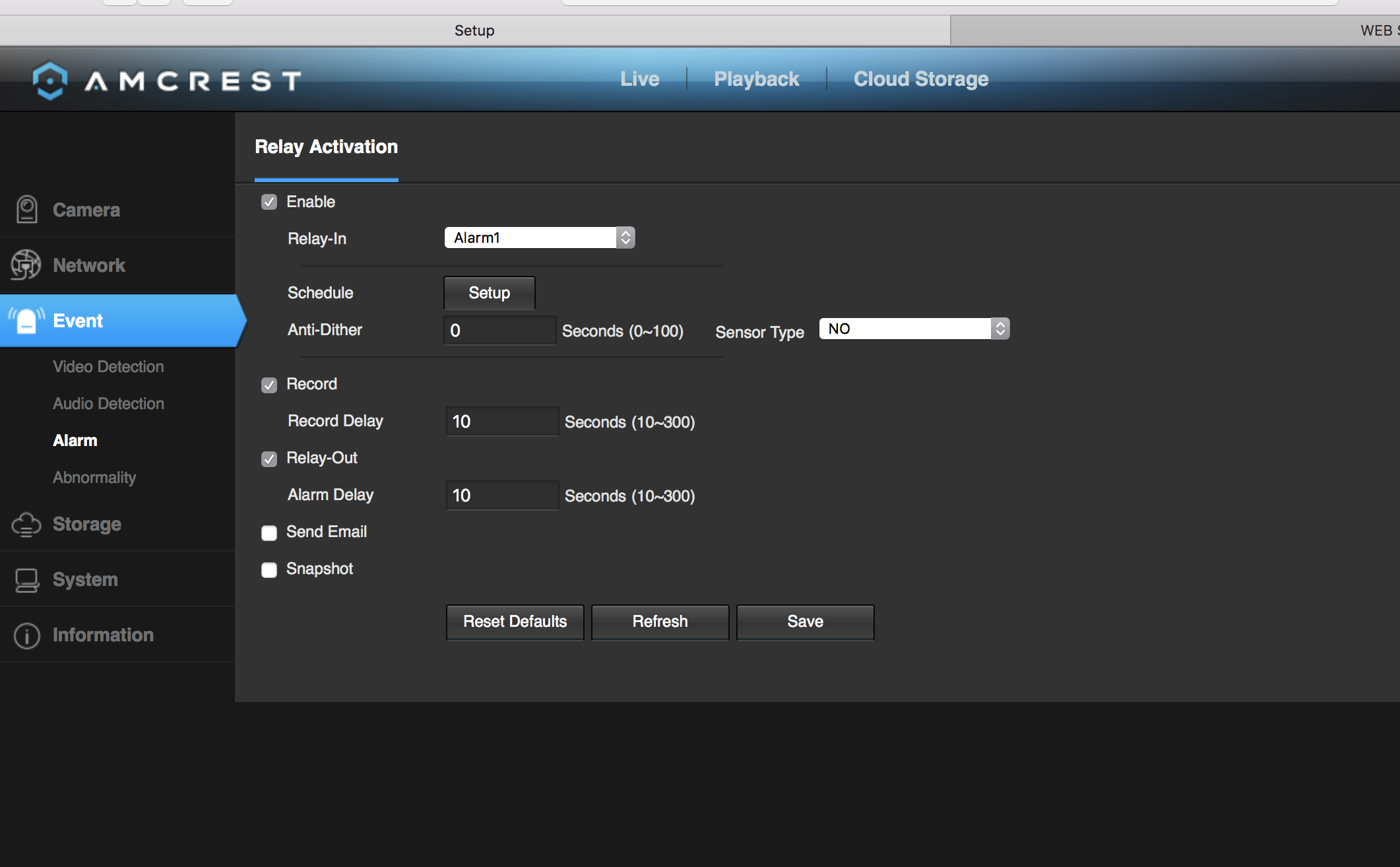

Here is the 'alarm' portion. But, I don't think it matters in this case. You aren't using the "alarm" feature. Isn't it a plugin for a window or door alarm? Vs "motion detection". So. Yea... Disregard the 'alarm'. Here is mine for what it's worth:
Screen Shot 2018-04-20 at 9.57.56 AM.png (322.57 KiB) Viewed 1972 times
