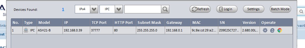

i just got these 2 ip cameras model ash21-b cameras. i found the ip config software and for some reason, it will not let me change the ip address i use .0.01 for the router and the router chose 0.39 for the camera ip address and the username shows up ad admin and xxxxxx port is 80 but it will not logon
i closed the ip cam config program and reopened it and it showed the camera as you see in the att. but when i try to log on i get incorrect username and or password. so what might i have done wrong in the settings? i do not think i have to change the port just yet to see the camera inside my network, only if i try to see it outside the network.
so does anyone have an idea i might try? in the setting i have start ip and ip number and i have no idea what to put there default user name is admin and the password is xxxxx and it tells me incorrect un or pw. i did do a reset on the device and it did not change anything.

- amcrest ip camera-1.jpg (37.87 KiB) Viewed 3576 times

So the ASH21 is not a locked device that I know of? I could be wrong..
So you need to use the Smarthome App from Amcrest. It is not a IP camera it is a Smarthome Camera that works like an IP camera.. In other words (Have to be clear so others don't Correct me) I say it isn't an IP camera because it don't have a WebUI.. IP cameras have WebUI's...
This camera will work with DVR/NVR, ASP, Blue Iris, and other 3rd party devices after it has been setup using Smarthome app..
So if the camera is setup already, You will want to slide the head up so the lens is facing the top in that area next to the Micro SD slot is a Reset button. It is a Cut out looking area that will have reset on it. Click it and hold until the camera changes to red (I hold until it flashes to red 2 times) once it does it will reset the camera back to factory. Then log in the camera using SmartHome app and setup there should be no lock unless it is a V2 or V3 that now has that feature (I hope they don't) If they do and that person is no longer on earth or no one watching the email account for you to request them to remove their account from it then they are paper weights.. However if it does reset like my V1 does and most of my other Smarthome devices besides my Battery Camera.. Then it should be able to be reset by switch (Button) and then setup again without an issue..

ok i did that and then nothing works the camera show but i can't do anything in the account it will not let me enter the devices it will not let me delete the device it will not let me delete my account. i just spent an hour on the phone with a hard to hear girl she did her best but nothing worked. she had me delete the app then go into the app and delete the data and chashe and that failed she had me try to reinstall it and that failed
the ipconfig pc program saw the cameras but would not let me change anything but if it is not a pc camera i guess that explains it.
