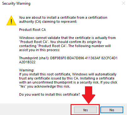

Did the entire process start to finish. Everything went as the tutorial stated, up until logging in HTTPS.
It will not log in secure. Gives me this (strikeout doesnt work here.. ) - https://192.168.1.108/
I reset to factory, and did it all again. The only thing missing was this:
Which I imagine is because I installed a certificate once, so it will accept them now as it says.
After the second try, I am stumped. Pretty sure I did all the steps, both times.
