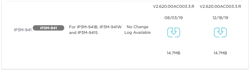

The problem is worst with the IP3M-941B's so as a first step, I thought I would make sure I have the most recent firmware on those cameras :-
Hmmm.. well that doesn't help at all, apparently two versions with the same filename that is until you have actually downloaded them and see that the release date has been used as part of the extended filename for the binary file. The most recent version is 12KB smaller than the old one so yes it is different and common sense would tell me that the difference would be detailed in the change log if only there was one.
Anyway I updated both cameras to the latest version then factory reset and set everything up again.
Whatever was done to the latest version, it had nothing to do with saving files to a NAS :roll:

Yeah I updated one of my 841 to the 12-19ver then didn't find anything thinking humm no change in feeling of the camera I don't see anything added back or anything new.. Then thought maybe added fix for PT and this camera I updated never had issue so I updated the 2018 camera and down graded my 2015 camera back to the 8-19 ver still stable and the 2018 camera is still unstable even with the 12-19 so again I don't know what changed and don't see anything that was taken away giving back or any PT control over what it was so I am at a loss of what the 12-19 update fixed.
