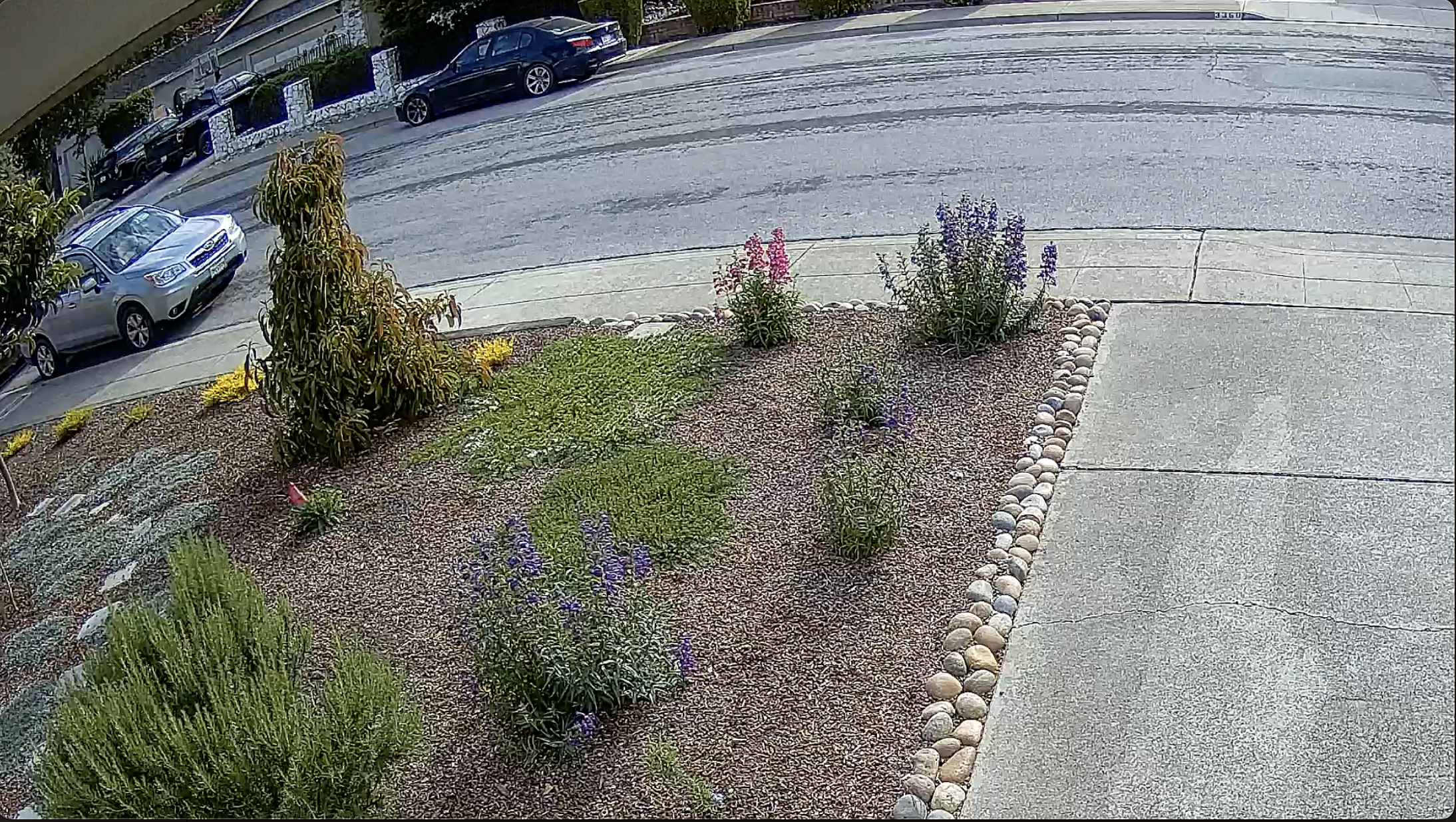

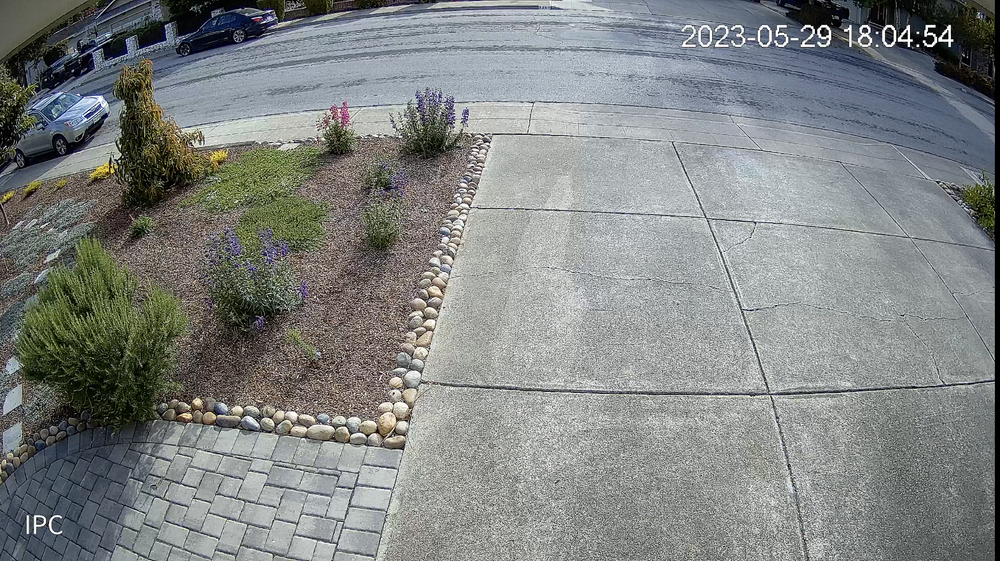

When I log in to the camera http address and click on LiveView, I see a wide angle view of the street (see attached).
When I stream through RTSP using openRTSP, with the below command, I get a narrow view angle (see attached):

- Narrow angle from RTSP
- Screenshot 2023-05-29 at 6.06.29 PM.png (6.02 MiB) Viewed 5579 times
- Wide angle from HTTP
- Screenshot 2023-05-29 at 6.05.54 PM.png (4.89 MiB) Viewed 5579 times

So I am not sure what camera you are using. When i look at your 2 pictures one is showing 2.7mp format or at least that is what the y x z is and then on HTTP is says it is 2.1mp
At the top of the page on the webui please press the picture of a camera to take a snapshot to upload so I can see what the true size of the camera is. The 2 pictures neither of them look like a 5mp setting? Now the WebUI can be setup to stretch the view to fit the window however if you take a snapshot with the tool as stated above it will take a true picture as you have it setup in the cameras encoding page..

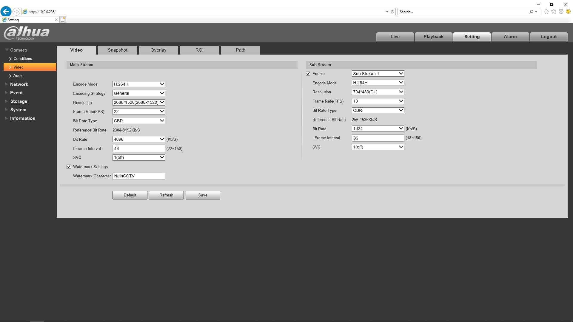

Logging into the WebUI, going to Setup and camera, Video, what does your settings show your camera is setup for? This is a picture of my current opened camera. While it is only a 4mp camera I just showing for instance of what settings I am looking for?

Also down at the bottom of the page for your WebUI. There might be a thing that says WH and if it is setup for Adaptive you will want to set on Original.

A 4:3 (narrow) aspect ratio is stock for a 5MP camera. Reducing the resolution to 2560x1440 (4MP) will provide a 16:9 (wide) ratio.
Other methods can manipulate the 4:3 image to appear as 16:9 at the expense of a certin degree of image distortion -- primarily as a squashed or cropped look depending on the method being applied.
RTSP will stream the resolution of the camera stream selected. The means of viewing is how you would manipuate it otherwise.

Re: RTSP stream not wide angle
Apologies for not reviewing the images before responding. (They were only links initially.)
The displays both appear to be 16:9 with one simply being a zoom of the left portion of the image. Again though, a result of the viewer, not the stream.
