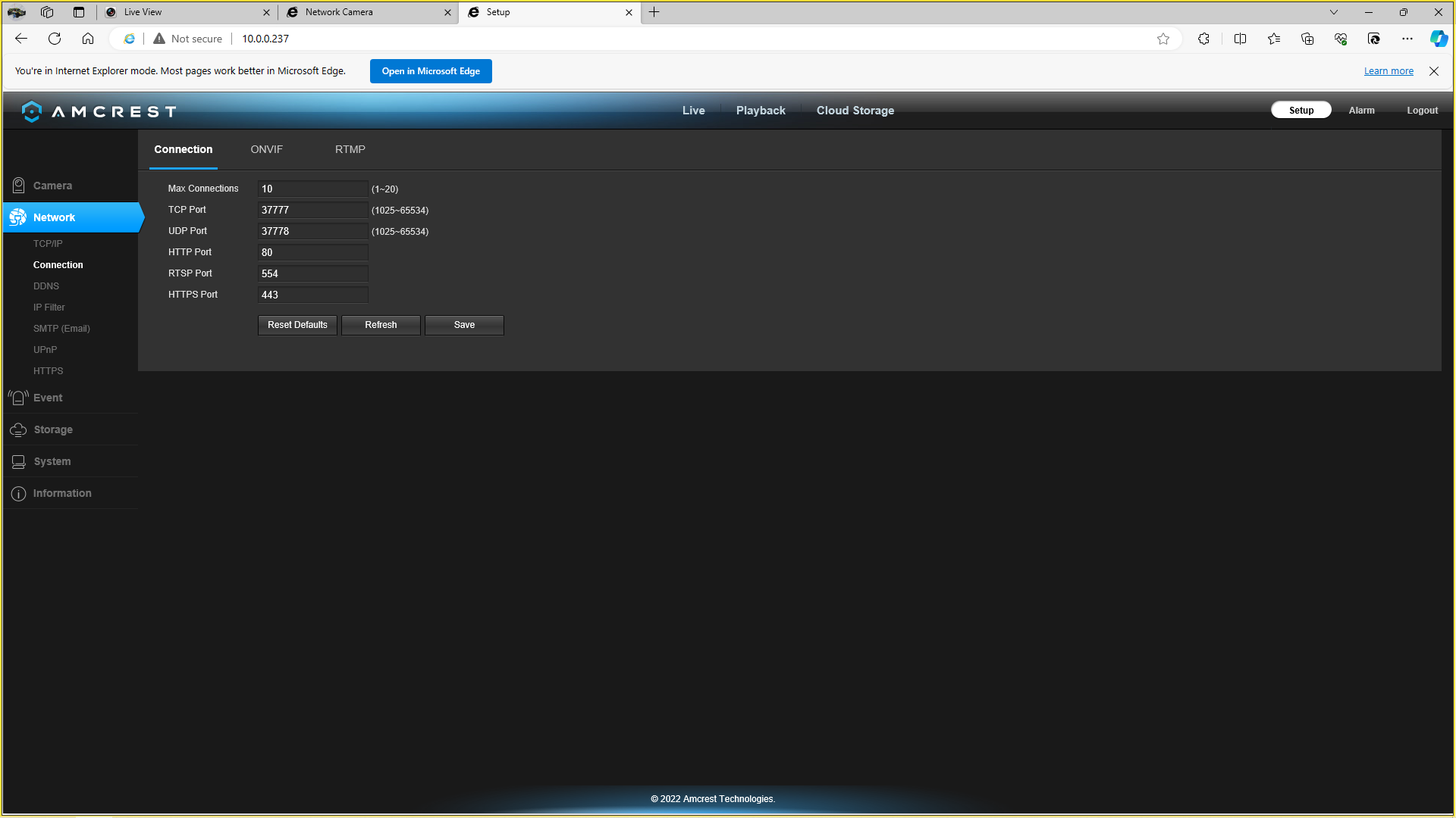

In the web configuration page (see attached) the port shows open on 554. I have several other Amcrest cameras and have not seen this before. An update of the firmware didn't have any impact.

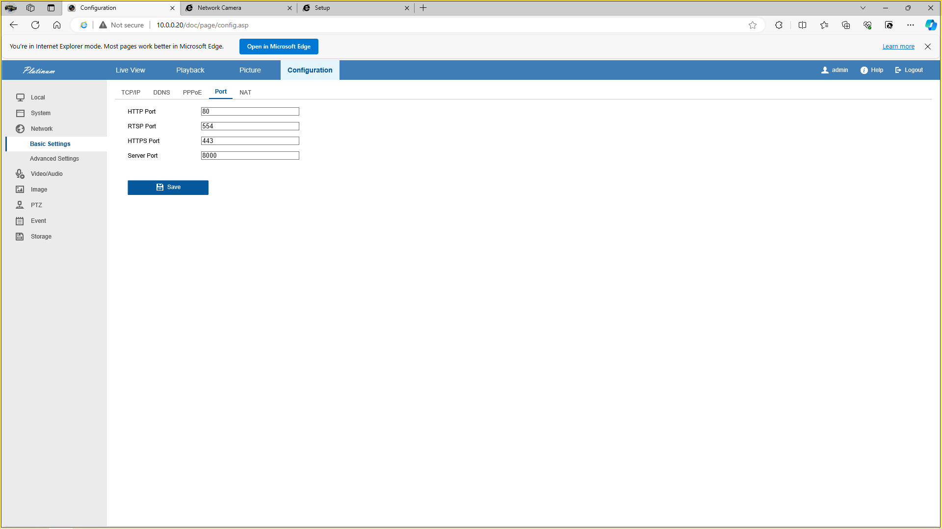

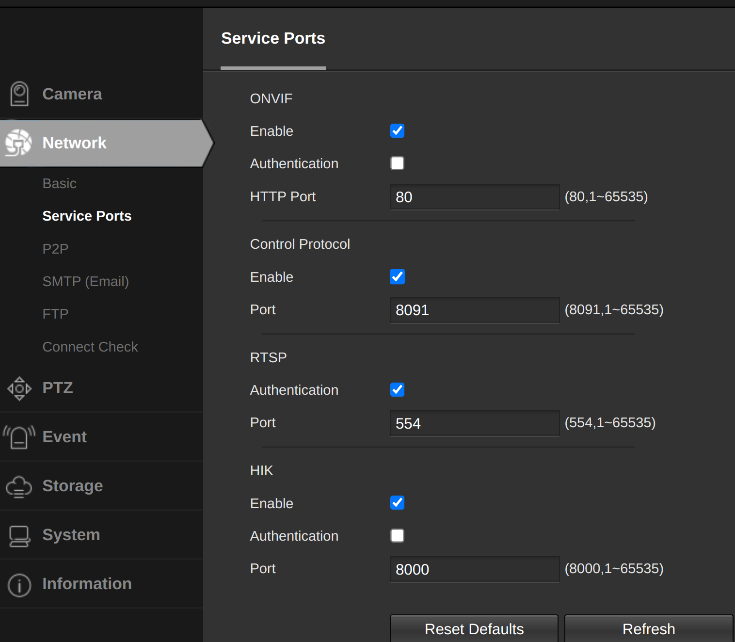

1 Last thing I don't understand is why would an Amcrest device aka your 2493 POE camera have a Hikvision Server port programmed in a Non Hikvision camera?
Amcrest Camera Hikvision Type Camera Older FW of OEM Hikvision IP camera with 8000 on Server port, Newer FW it does say Hik on one of my other cameras different location.
