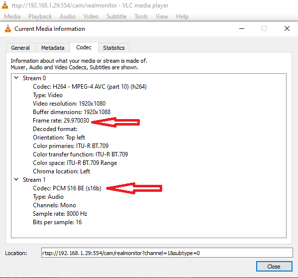

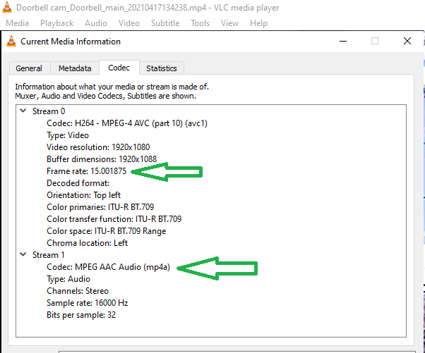

NVR and PC VMS software see the streams provided by the AD110 correctly (15 fps video and AAC audio).
RTSP codec info (as observed via VLC) shows 29.97fps and PCM audio. The framerate is trivial to my concern, but without the correct audio codec in the header, I get no sound from Monocle.
I've checked the HTTP API getConfig output, and the channel & stream config settings reflect what the NVR and PC VMS see, not what is reflected in the RTSP streams.
Any suggestions for how to overcome this? If there's an RTSP relay daemon that can change the stream global header info to specify the AAC codec, that would be ideal.
