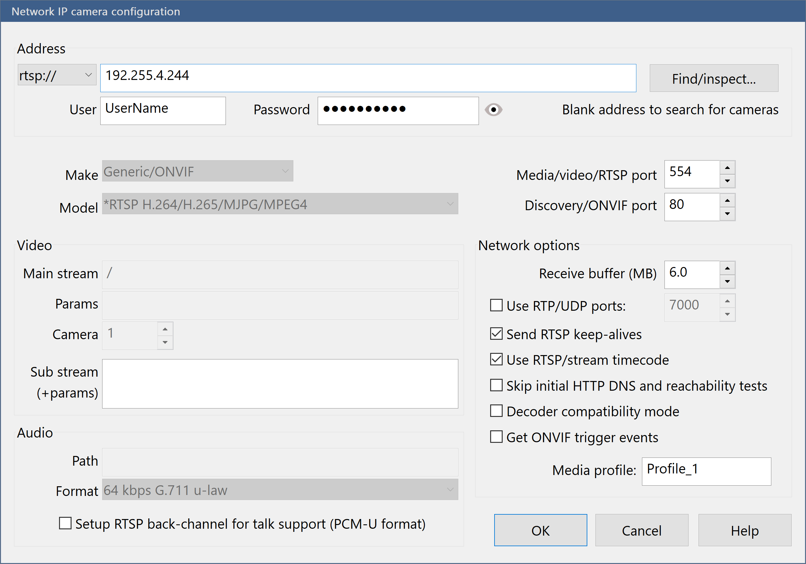

Do you have any experience with Blue Iris? On the configuration screen it has a place for UN/PWD. I am curious if I need to include the "user:password@" part of the line above.
BI Config.png (122.02 KiB) Viewed 27249 times
Re: RTSP for Main Stream and Sub Stream
If your in the listed item then no only if it was to be run without the area for it..

Never mind. UN/PWD was not needed in the address proper.
Thanks for the help, that was what I needed!
