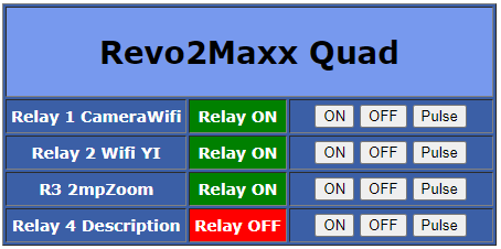

Some of these issues could be cured with a Cameras Power Cycling. Personally if your not manning your network I would for sure have a Remote access power like a WebRelay see picture below. If you have access to your network then you could make access to a Relay power supply to remove and restore power if needed to see if that cure issues of Network or MSD..

Oh sorry there are cheaper things out there that was pointed out last time I mentioned it. I guess some type of Wifi IOT plugs can do same thing and can access over your cell would be much cheaper route...
