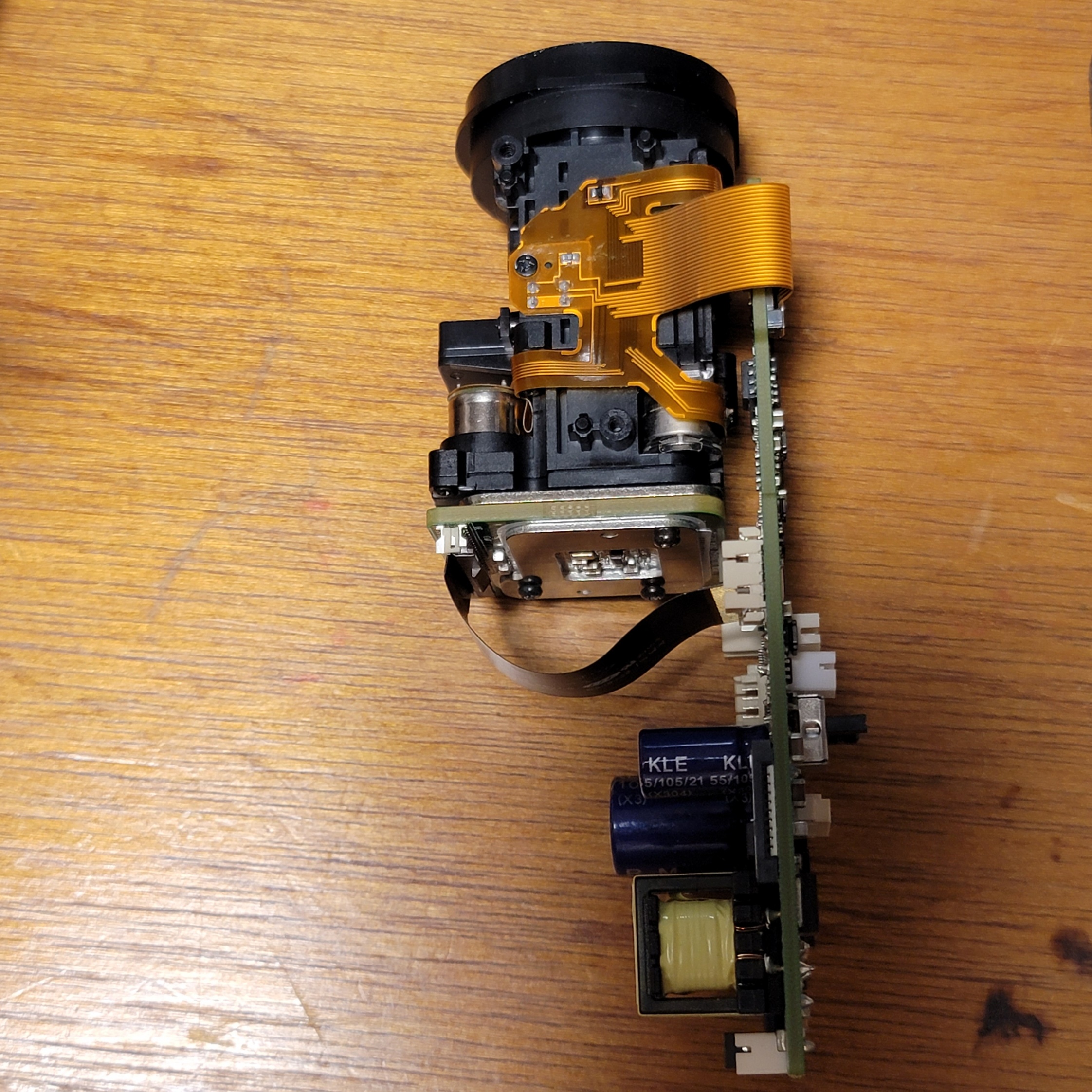

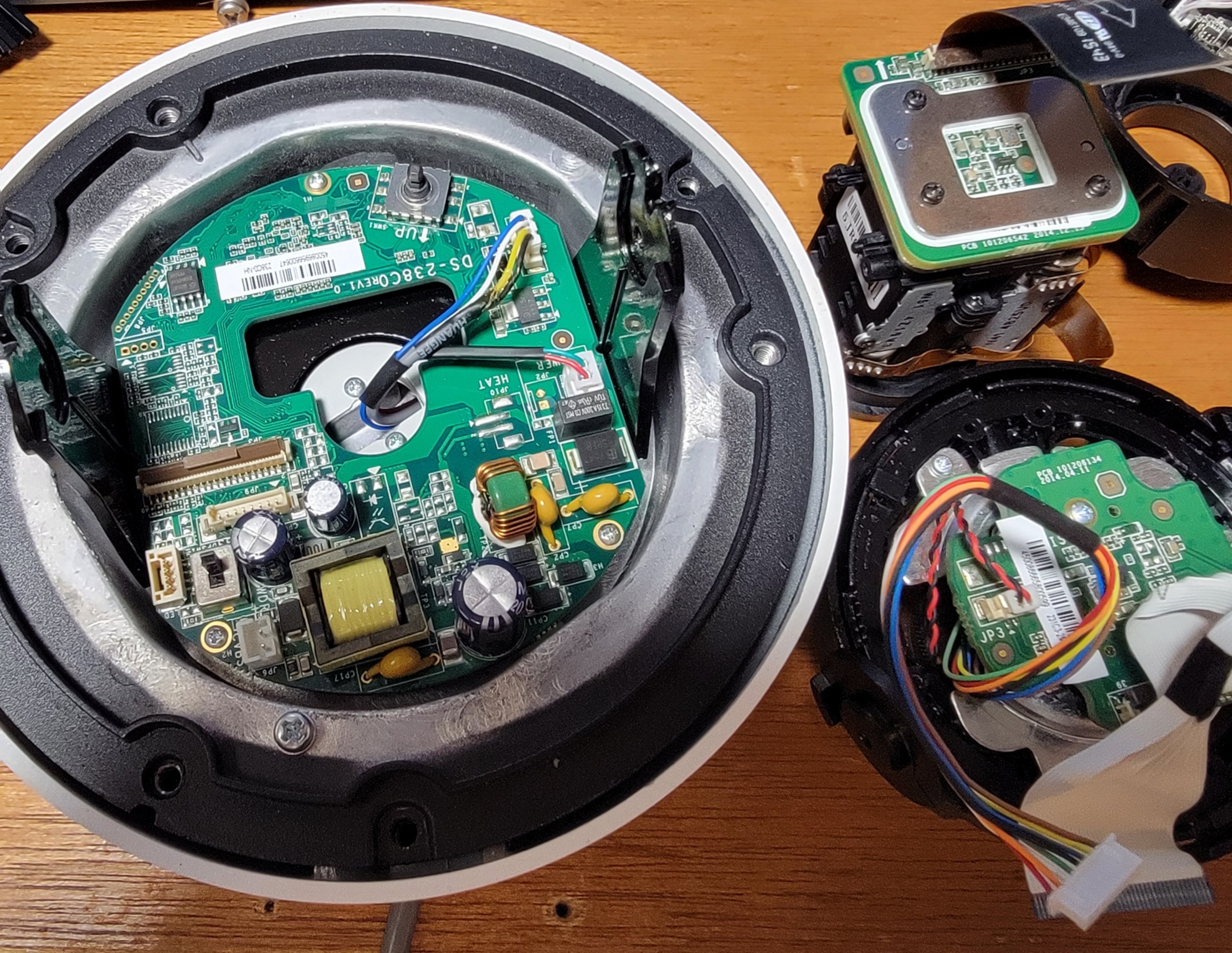

So here is some things that may or may not help in others trying to fix things. Here are 2 pictures. In the top picture taken today from a 10x zoom Bullet camera 2mp from 12-2014 so this was really sold in 2015. The Dome camera is also 2mp however it is only a 4x zoom camera and if you look at the 2 cameras they are different only in the Zoom format. One has normal cable (wires) where the other is the Ribbon type. That is because the 10x zoom camera was static to the PCB for the main board where the dome camera the Zoom lens is on a mount off the main PCB and needs to be able to move right left and up and down for setting the camera position on install.
However what is important is that these cameras were on the same format, TVI and that they both have a 40 pin camera connection again different type of cable but same type of connector for them..
So if you have an issue with one of the cameras working on the PCB it comes with then you can confirm if the camera is damaged at the sensor or if it was PCB for system. While testing this way you can see if the camera works at the sensor level however function of the zoom is only cable and motor and not normally an issue anyway but this will open the camera and let it see that it works if it didn't then you know there is no need to Repair unless you work on CMOS or CCD sensors. (Not in my pay grade)..

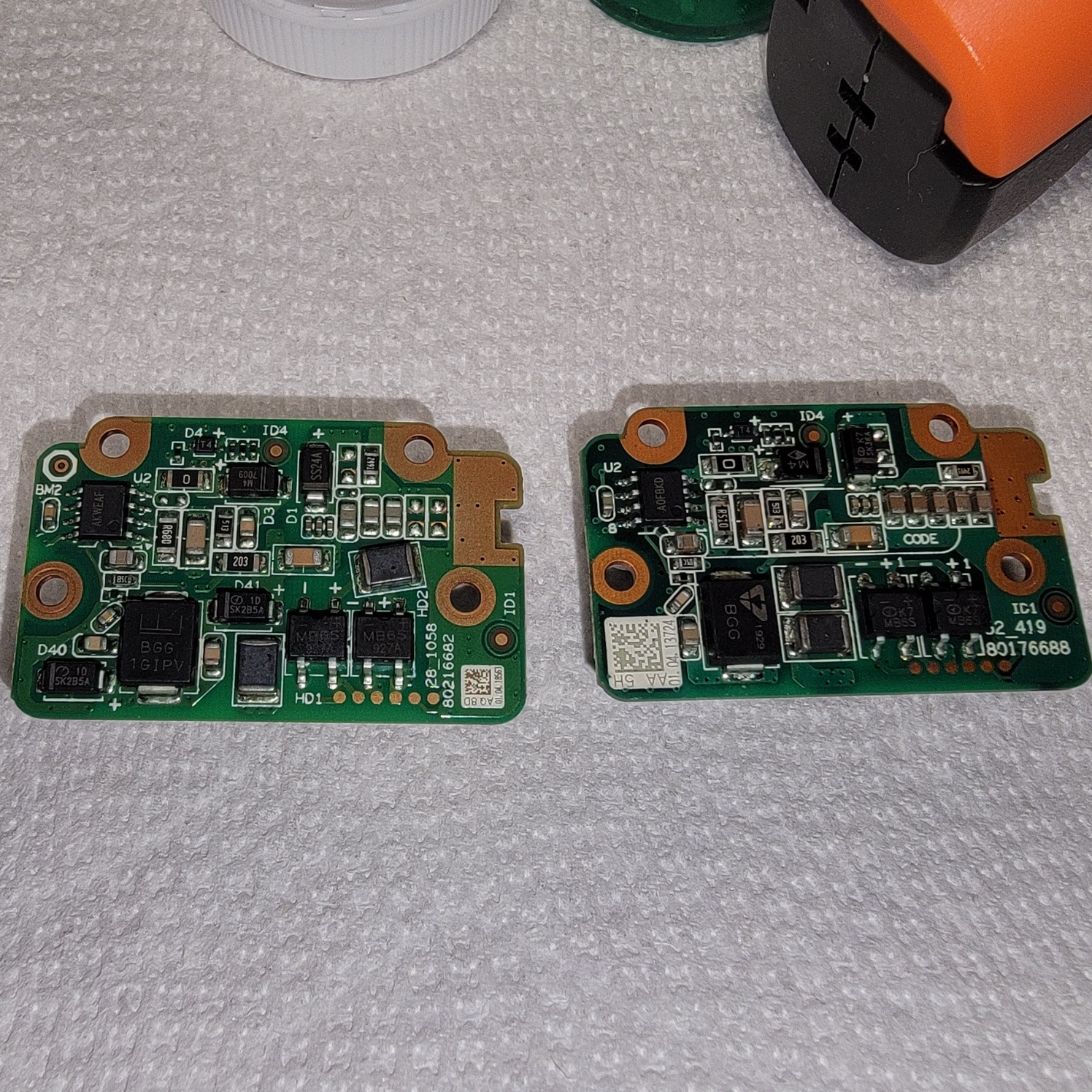

Then something I wanted to point out in Second picture. This is back side of the main power board of 2 different IP cameras. One is 2mp and other is 4mp and both are Bullet style cameras with zoom lens. What matters is at times if you have a camera that isn't working and you think it is the Power Board then one even from different companies might have same power board. what is important is that they are setup for the same connection. Then testing with new board will tell if it is Power board related issue or camera level issue.
Re: Repairing old IP cameras.

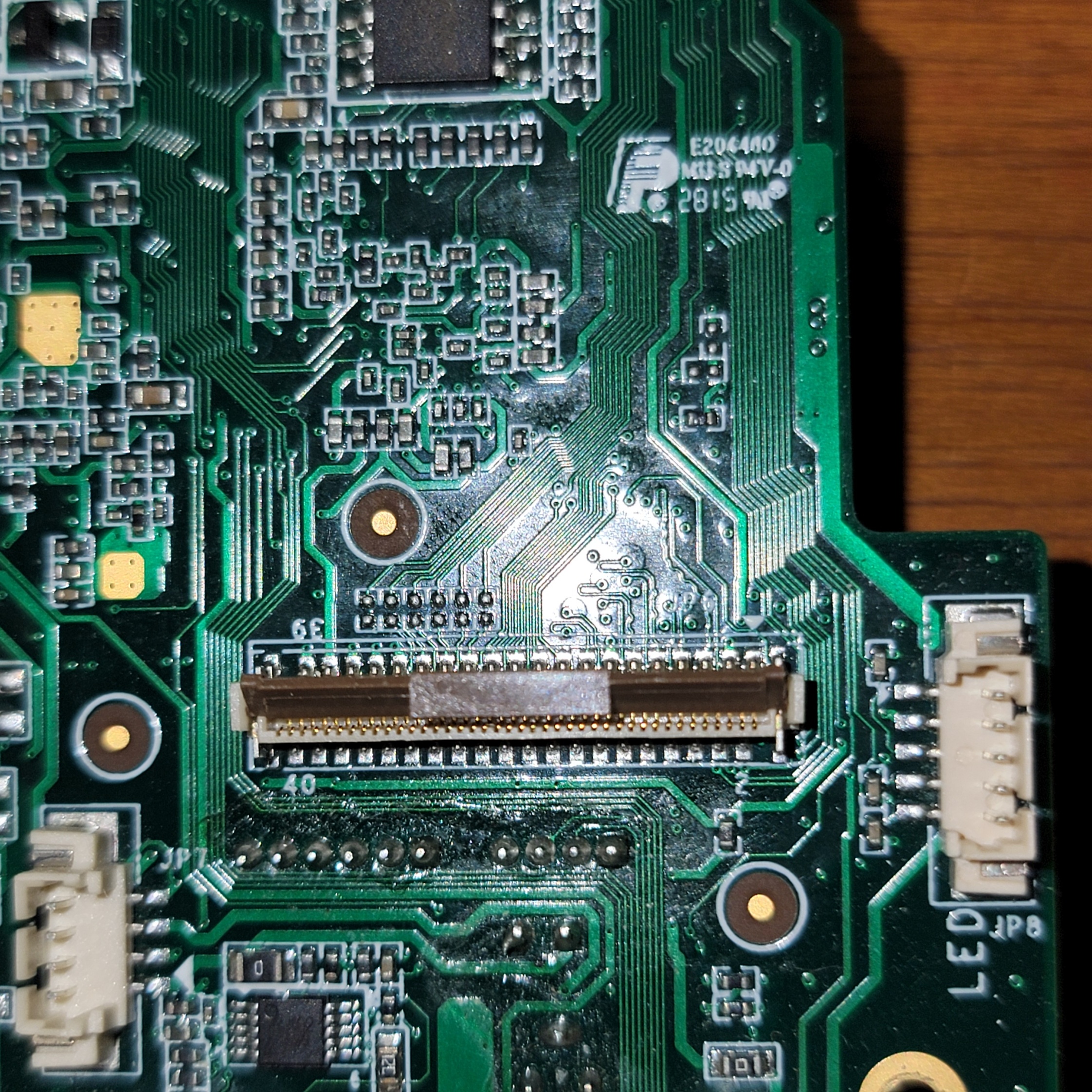

So I thought I would also put in the Bullet board. One of the biggest difference between the 2 cameras is 1 is with heater where in the end 180633 picture you can see on the PCB the heater connection and Circuit for it along with the Opto-coupler is missing from the Dome. The Bullet has the heater. I have another one of the domes at one of my other locations where I added in the heater circuit and the little heater mats that I found online from Omega Silicon or something like that. Also thought I would upload a close up of the connector before someone says it didn't happen lol. While on one side it says 39 it is a 40 pin connector as you can see on the other side of it.. So the Dome and Bullet use the same camera connector and was why I was able to test the one with the bad PCB on the dome PCB.
This is the way the bullet camera is connected and you can see in the first picture the ribbon cable connects to the bottom of the Bullet PCB. Where the dome one is as I said before with wires and is the connector right below the camera connector marked JP9 in the first picture above. Then the second picture here is of the connector on the bullet PCB close up to show 39 on 1 side and 40 on the other.

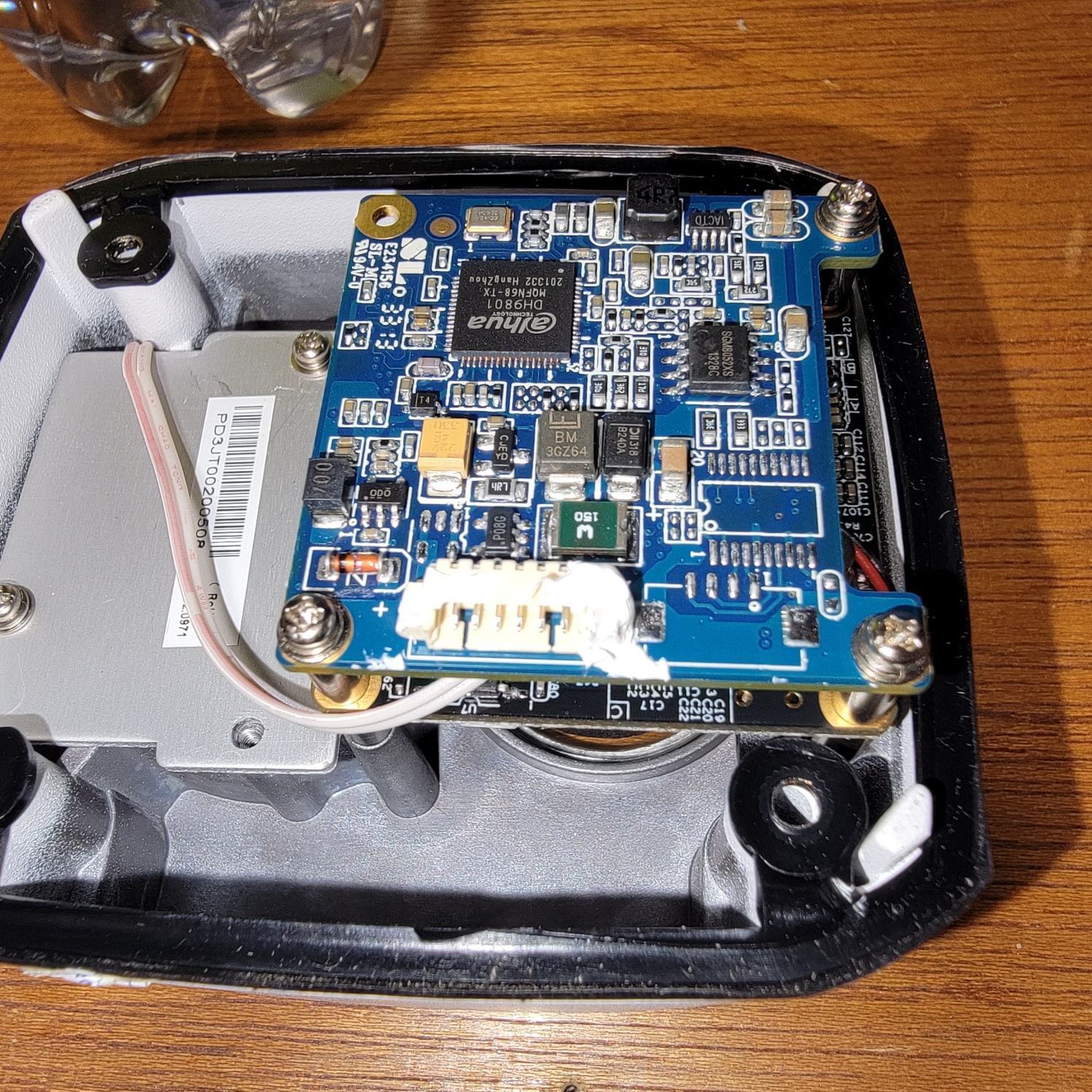

I appreciate all the input and generally understand the redneckery involved with mixing and matching stuff just to isolate a problem to a given area of a device. Problem is, I don't have anything remotely similar to the Dahua power board even for just a quick and dirty test of the camera.
The one thing I do know is the camera would drag down a 4-way 12v supply to nothing when plugged in. Same thing with the power board all by itself with no camera connections. I think you're right about the first diode being involved as it tests shorted to ground from either end in continuity mode and shorted shut in diode test mode.
You mentioned pulling that diode as a test. What's involved besides pulling the diode? Just jump across the contact points with a piece of bus wire and plug it in?

Answer no a Buss wire would not work. That would be a Short to Ground if you were to place it on a Diode spot on the PCB.. So something to look at. If the diode is dead to ground and is pulling your system offline when you plug in, 1 I would use a Fused line in for testing. Resetting fuse for best results. However follow the line where that diode you think is dead. Check to see if there is anything on that line that could be pulling the system to ground. What is odd is that your fuse hasn't shorted and if it did then it to might have shorted to ground but that would be interesting to see in the cameras. Normally as they intend it would blow open and not short to ground.
Anyway something I thought I better ask. Did you test this with the PCB unplugged from the cables in. I ask because one of the first things I do while testing cameras that are not working is I tone out the wiring for the camera. (Unplug the cameras wires from PCB and make sure there is no short in the cable) It happens more then people think. Some times it is a Short open. However there are times where the camera has heated the power wires and the 2 wires have fused together.. So that could be an issue as well..

But here is something that I want to say. I took this camera and with my soldering tweezers I shorted out the TVS diode that starts with LF in my picture next to the green Fuse. Once I did that causing the camera to clamp that voltage to ground the camera went offline once I removed the short (No damage was caused to camera or diode) the camera and voltage from my Power supply returned and camera came back online.

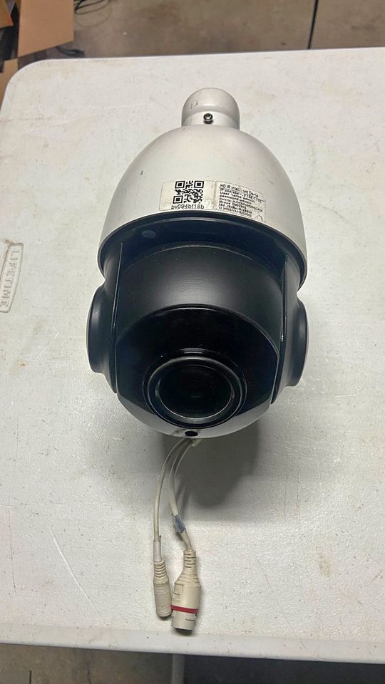

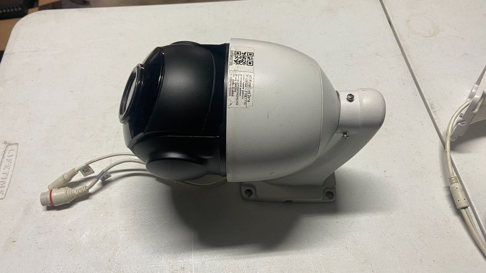

Look at all familiar? From what I've been able to track down from the info included with the listing on Face Book it would seem to be a Hik OEM rebranded as IPOSTER 5MP PoE PTZ w/18x zoom (plus 30x digital) and a pretty formidable camera if working properly. The guy has it listed for $25/parts only -- "powers up but won't maintain network connection". Messaged him and offered $10. He's pretty vague about answering questions just saying "all it needs is a new network board." Really? Then why don't you just put one in it and have a nice little $180.00 camera for yourself then?
So would you happen to have "a network board" for this thing just laying around or know where parts might be sourced?
