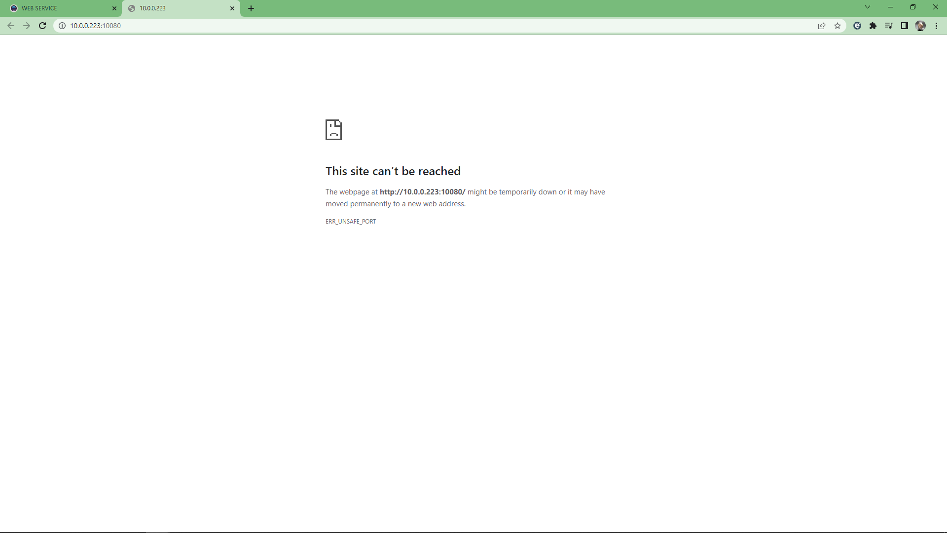

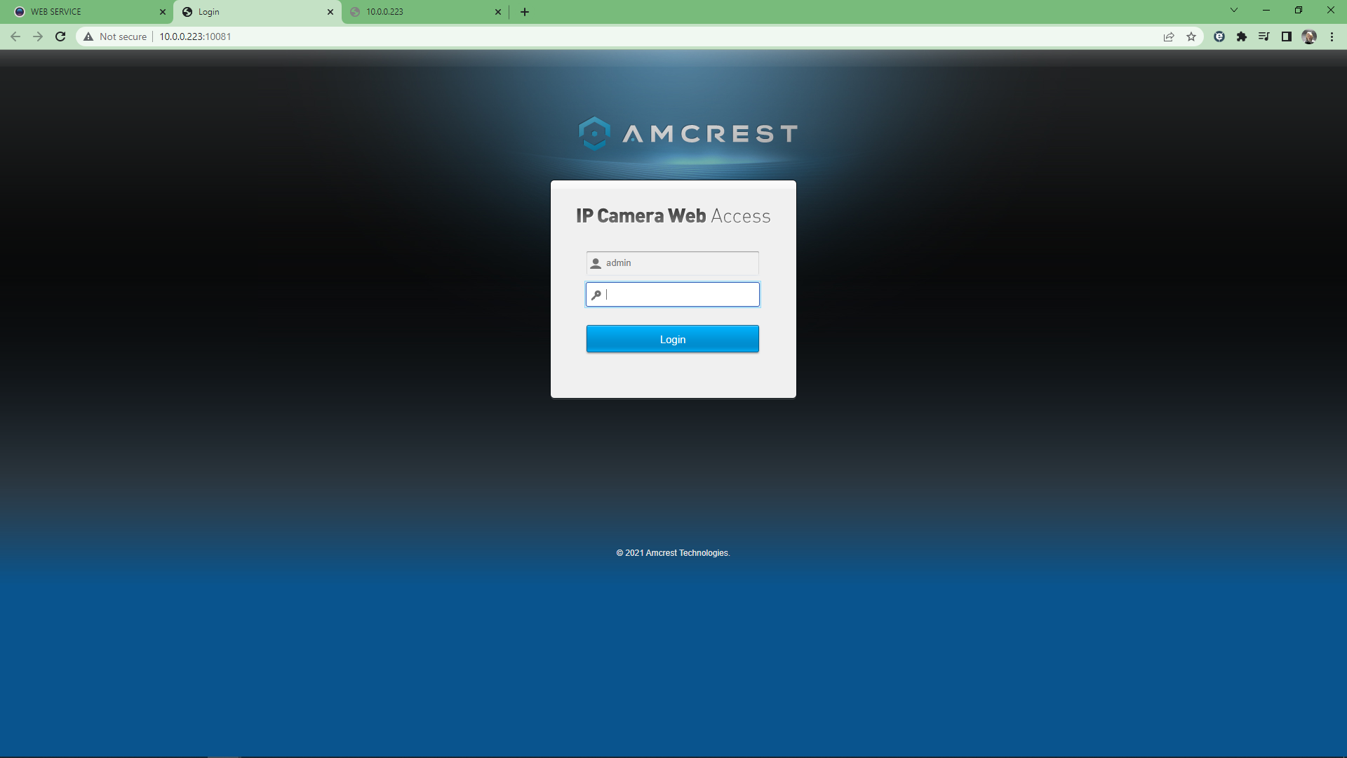

If the feature is there and just can't get to it because it is sitting on your POE NVR port, I would double check that your NVR has Virtual Host box that needs to be enabled. If it don't then I would log into the NVR's WebUI. If your using Edge or Chrome I would click on a different camera for the first time because it will say that your computer is blocking the first port.. Then click the camera that you want to edit using WebUI. It should open port of the second one in 10081 10080 is blocked for some reason in Chrome..

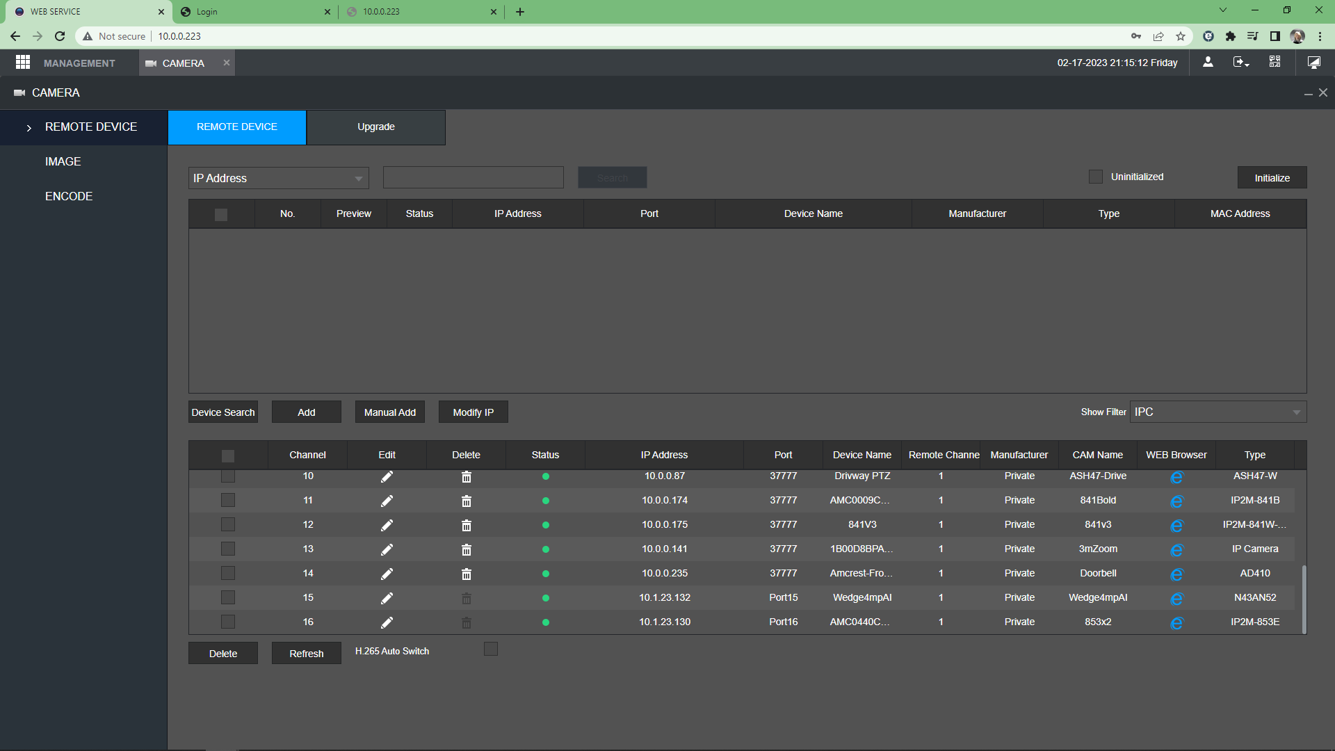

In the last picture you can see where you would want to click on the e in your NVR's WebUI, under Management, Camera, Remote Device and the e at the items next. I click on 15 and gave the error in first picture then click clicked the e on ch16 and you can see in that picture it is at the log in for my Amcrest Camera on port 10081.. If you look at the Trash can they are Greyed out because they are POE cameras on the PORT of the NVR and not IP of the local area network you can still click the e to have it bring up the log in of your local camera as well just pointing out that the ones on PORT will have no access to the trash can..

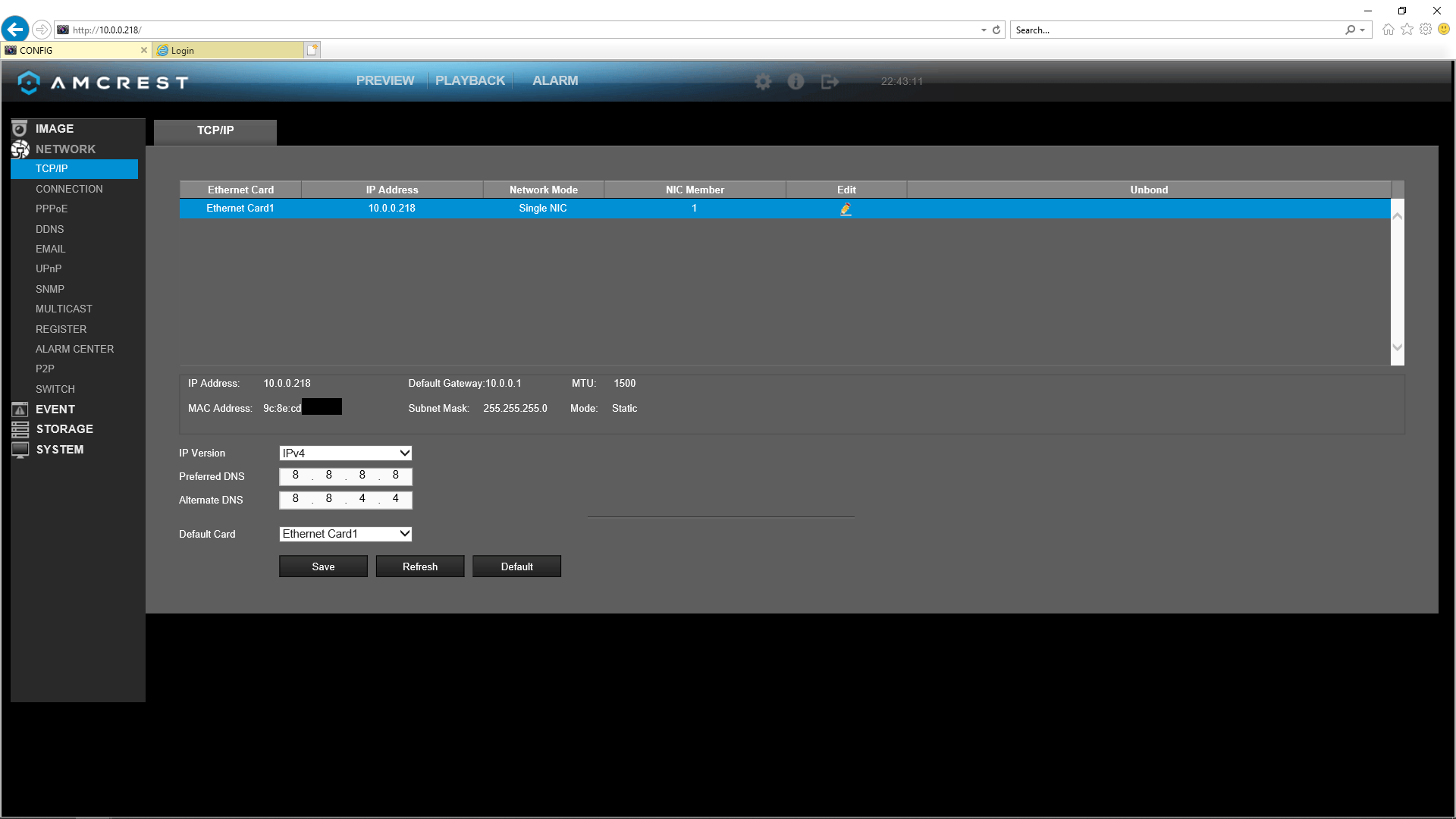

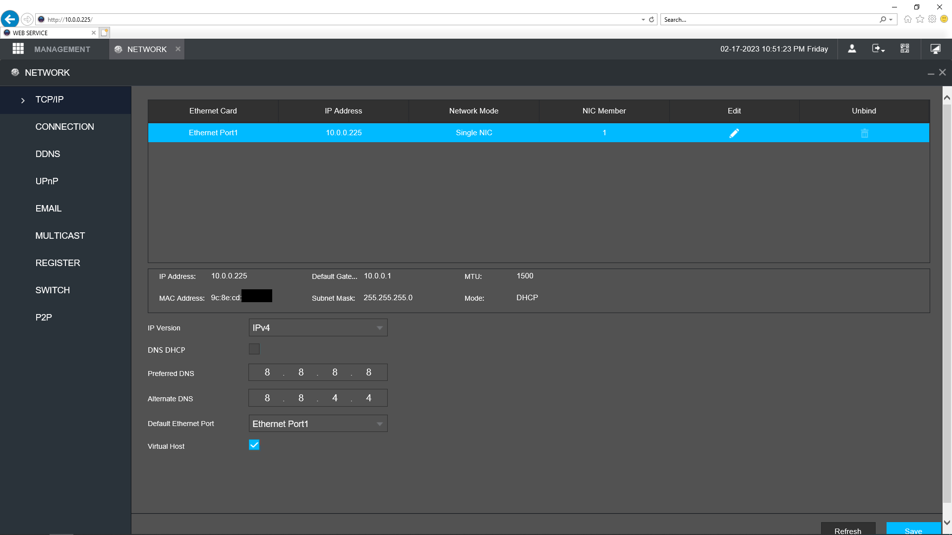

So in my pictures above that is using my 4216E-AI NVR. That don't have the option to turn on a Virtual Host. Then here is 2 more of my systems. One a 4108E-HS on older FW. As you can see on the Network page there is no need to turn on the Virtual Host. However on my NEW FW 4116E-HS and 4108-HS not sure why the Non POE has the option but it also has Virtual Host Button that can be Enabled.
My guess is that you might have a new FW POE NVR and if so I would double check in your NVR's Network area if there is a box that needs to be turned on Virtual Host..
