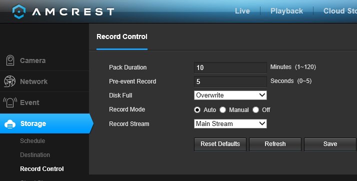

I just saw a comment by lubowsky - "I also changed the "Pre-event Record" to 10s, which is the maximum,"
The maximum I can set is 5 seconds -
- screenshot.jpg (32.45 KiB) Viewed 4389 times
