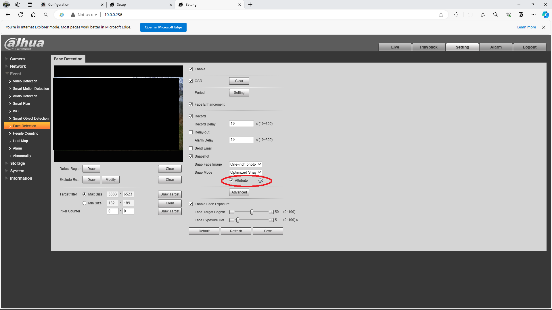

Re: Question about IP8M-TD2685EW-AI Face Detection Event API
While i have that camera, I hate to say that is not one of the features for the camera model. You will need to buy a higher grade camera that has that feature built in. If you look at the picture below from one of my Dahua cameras. You can see where it is marked. This area is where I can pick what I want to show like Mack or Beard. Age Gender and so on.. However nice the 2685 is. That isn't a feature of the camera..
Screenshot (1612).png (115.85 KiB) Viewed 2099 times
