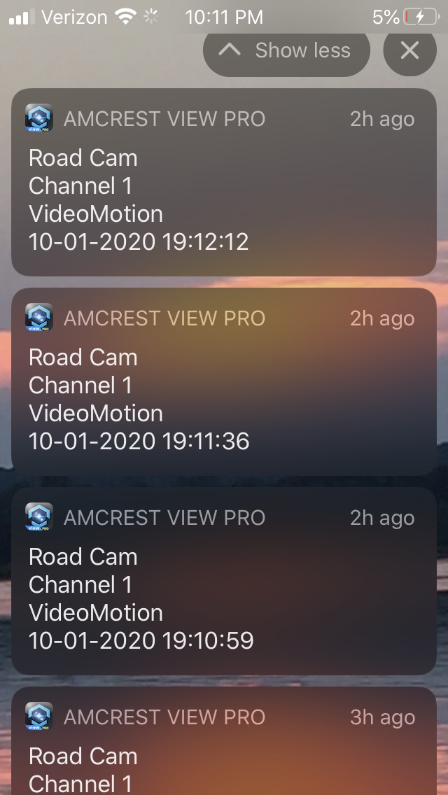

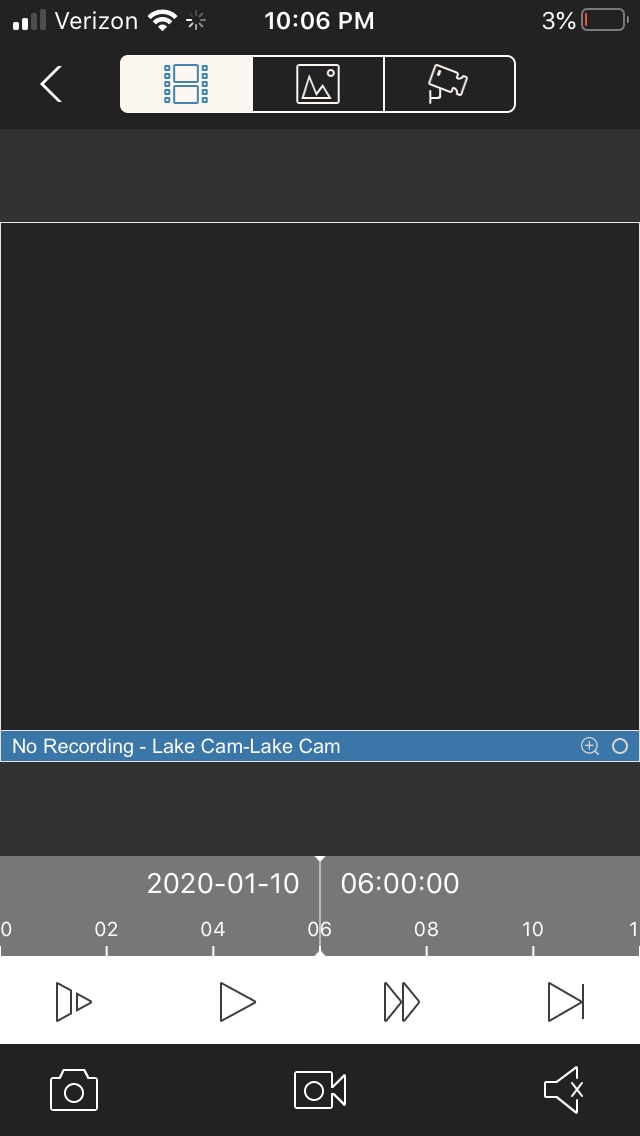

Hello - looking for some help. Recently had a power outage. Cameras back online - can live view and get motion alerts. When I try to view the alert, app opens and see “No Recording”.
Have had these camera for some time with very few issues. As of now the same issues with every camera - Push Notification comes but it shows no video.

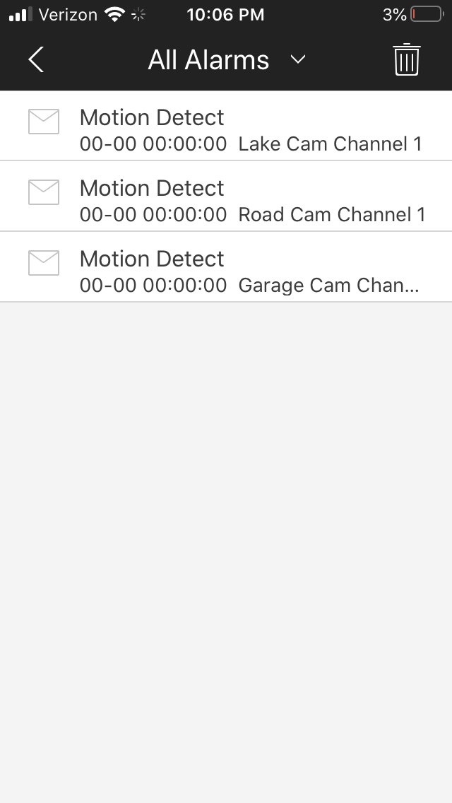

One difference I can see is that the alerts are no longer creating a list in Push Notifications/Event List. Additionally, the time stamp is “00-00 00:00:00”. I get push notifications for motion with a good time stamp but the list does not grow - there remain only 3 on the list (one for each camera with the 00-00 00:00:00 time stamp).
Pics attached.
Cameras I have are: IPM723-W IPM721-B, IP2M-741
Appreciate any feedback!

Hello...I have reset routers, camera's, app, etc...No Change to the issue outlined above. I do not think it is related to any kind of network lag or traffic as I have no issue pulling up a live feed at any time. Looking for any other options, thanks!
