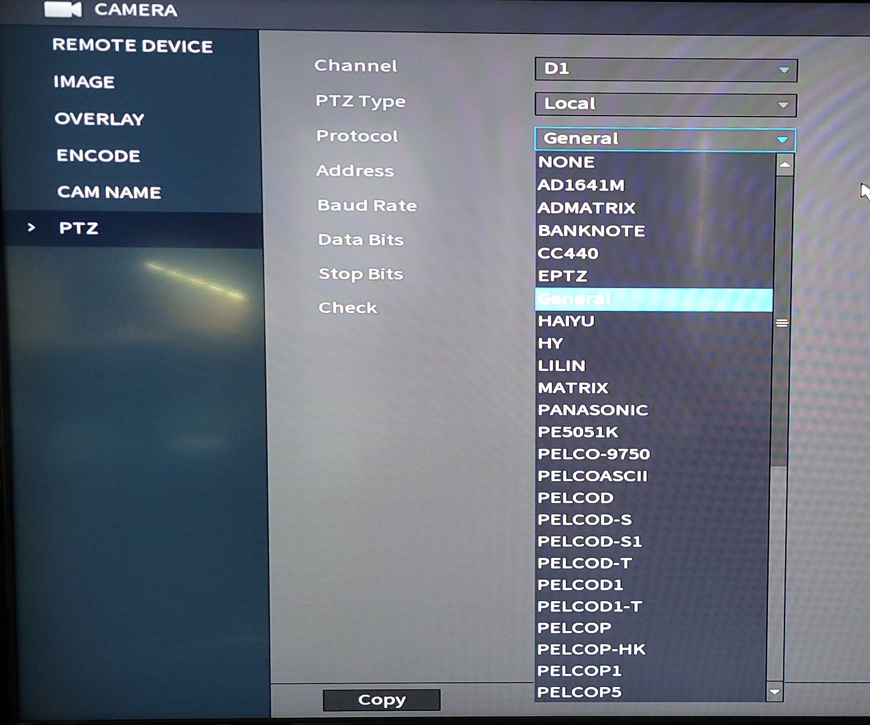

Can someone tell me which protocol the PTZ Amcrest cameras use? I have 2 PTZ's and neither work (cannot move cameras, but everything else works) through the NVR or Amcrest Surveillance software, but connecting one directly to the network and log in through the IP address the ptz functions fine, so I must have something wrong in the NVR settings. It used to work fine, but something happened and they both stopped working at the same time.

Sorry not sure what machine your trying to connect your Cameras up with. However it is hard to understand why it isn't working when you setup the camera to the Recorder. Is it an Amcrest recorder? I mean all of mine will auto pull in the Devices PTZ config from the device. I will admit that if I happen to pull in a PTZ camera from a different DVR/NVR I will need to reboot my machine for the camera to work from the new recorders PTZ commands.
So then info about your camera it self, I would double check what your camera is working on at the camera level to be sure 100% however if I had to guess it would be something like DH-SD1 or DH-SD3..
You would want to log into your Cameras WebUI at the cameras-ip address log in using your user and password, then click Setup in top right are of the viewing page, then click PTZ and there should be something that says Function. Clicking that it should say what it is setup for at the camera level. Then you will want to find that in your DVR/NVR..
All the ones you have listed in your photo would be the normal Analog type PTZ cameras that normally would be connected with a RS-485 connection.

As I stated in the original post, the PTZ works fine when I connect through a browser, It does not work when going through the Amcrest NVR. The PTZ functions on 2 different cameras stopped working at the same time, but I forgot what was happening at the time. I may have messed up the settings myself.
There's way to many protocols to sit there and try each one to figure out what I should be using.
All of my cameras are POE+ on Cat6. There is no info within the camera settings that state what the PTZ protocol is.
I just need someone with an Amcrest system (NVR and PTZ cameras) to tell me what the stock protocol is for AMCREST PTZ's.

Your best bet is Remove the Camera from your NVR (I looked on all my NVR's can't find one that has PTZ under camera on the GUI or NVR's WebUI) as I said all of mine Pull in the Cameras setting from the camera.. Anyway after removing your camera, I would then reboot your DVR/NVR, Log back in as you normally would and add your camera back either clicking the Channel you wanted it loaded in clicking the + or under camera remote device, top pane search for cameras, then click the one you want to add that comes up, If the password is the same as your NVR then your camera should come online without any other input. However if password is different then in the bottom window area of the Remote devices, click on the Pencil for the added camera and put in the right user and password for the camera. (Once you do this it should pull the cameras PTZ info from camera.. That is the best way..
Swore at least one of my NVR's had that page in your picture however looking at all mine even a much older one with last FW added from 2013 didn't have the PTZ settings page.. Sorry I wasn't any help..

Finally fixed it, decided to just do a factory reset. First I saved the config and exported to USB stick. Went through setup again and looked at PTZ settings to find out what was wrong, then reloaded original config and went back into PTZ settings and fixed what was wrong. Works perfect again and now I have a complete config backup incase I ever have stupid issues like that again!
