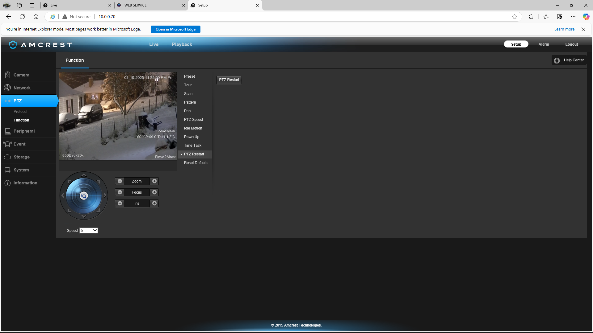

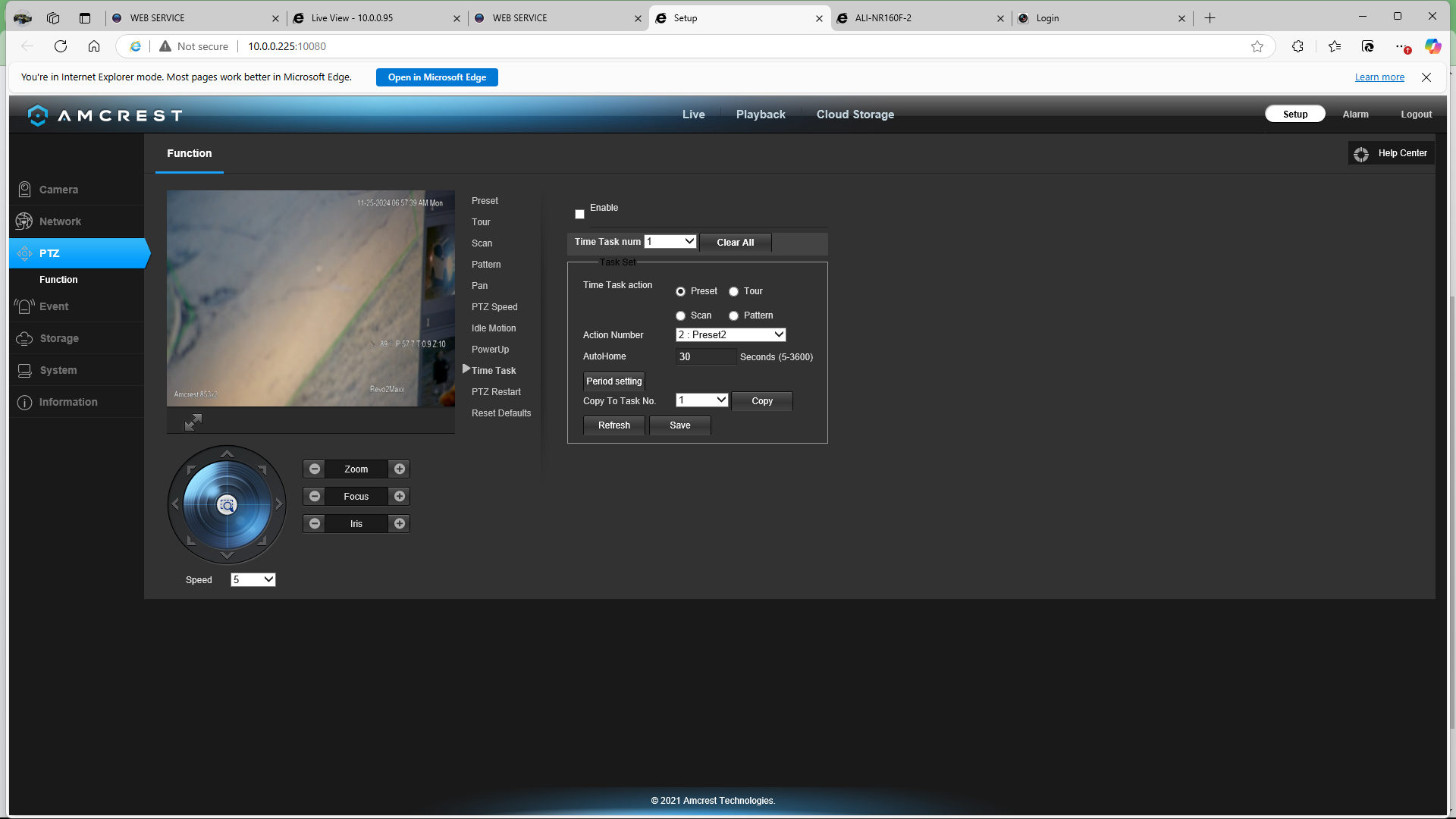

So I am working on one of my PTZ getting it ready for the next couple of years of life. So I am changing out Gel Packs and because of some health issues this year I am running far behind my normal schedule lol. But I thought I would put it up and show in one of my Amcrest PTZ what I am talking about. I these pictures on the PTZ page of the camera. This is connected to one of my POE NVRs so the IP address is for my NVR and the port is how one can access POE connected cameras. Just explaining why the IP looks funny if someone seen.. Anyway had to access over the NVRs Virtual Host. So anyway here are a few ways that a PTZ camera can get things all messed up. Keep in mind that if your camera is really at fault. Looking over the list of things here, If your system isn't enabled or setup for them keep an eye on the camera over the next hour or so. If the camera don't move on its own within that hour. Remove the power to the camera and then add it back.. I mean I have my cameras do a Reboot every night so if you do as well it might be that the issue is after a reboot so if you reboot camera by taking power and giving it back it could go back where it hides..
There are many other reasons but here are a few to try to work through for now. Doing a Reset of the Camera back to Factory Default, You don't have to climb the ladder always to do them some cameras do have factory reset in the WebUI.. Also on my camera if you look between the picture and the function you can see all the different things in the PTZ function area of this camera. Each of them could be the problem area for your camera if you happen to have them features in your camera..

Ok sorry I have to ask. But have your changed/setup your power up option in the PTZ menu? ON my higher end PTZ cameras the camera has some options for Guard and it kind of sounds like maybe your camera on a reboot is defaulting to that location because that is the natural start up position within the cameras settings..
If you log into your NVR, go to the Management top left, then click on camera, then in that area at the bottom there should be an e click the E as long as you are not in chrome if you are in chrome then click the e of a different POE connected camera to get the This isn't secure and blocked blah blah. ONce you get that click the e of the one you want now it will open in different port. IF it in IE mode best option of working with cameras and NVR.. You don't have to worry about the first e click issue..
Once you click the e log into the camera, then click on setup, then PTZ Menu. Then go to start up and set a preset that you want the camera to start in.. There are some other options that are after idle and a time where to send the camera click preset and where you want it to work most the time.. ONce you do this.. Go to the area of the menu to reboot your camera and double check that it now goes to the preset you setup..
By the way most cameras that are connected to Amcrest NVR aka with Amcrest camera all things from camera are translated into the NVR and or just off the camera it self.. Unlike my Alibi PTZ camera and NVR where they don't like each other very well lol even though they are same brand and same Vigilent series lol Making a preset in the camera makes a new preset in the NVR lol.. Even if you were in the camera to just update preset 1 you know the one I have as my Guard Preset settings.. Well if I update that preset in my camera it will just make a new preset in the NVR what a POS..

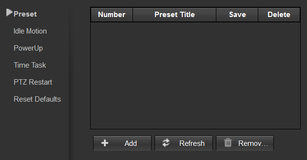

I've now left it for 24 hours after confirming that there are no presets set in the camera:
and it's still exhibiting the problem, at some point it moves the camera so that it's pointing into the weeds rather than where it should be looking.

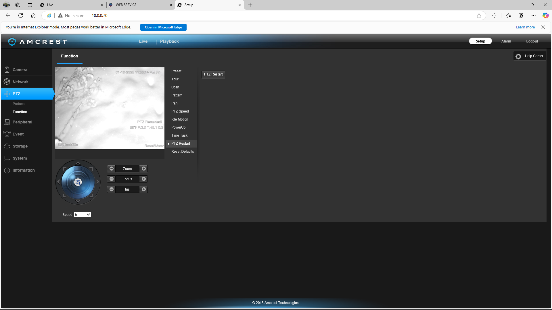

One thing I've found while playing with it is that manually doing a PTZ restart results in it pointing into the weeds at that exact location, so it looks like something is forcing a PTZ restart at random and that's what's causing the problem.

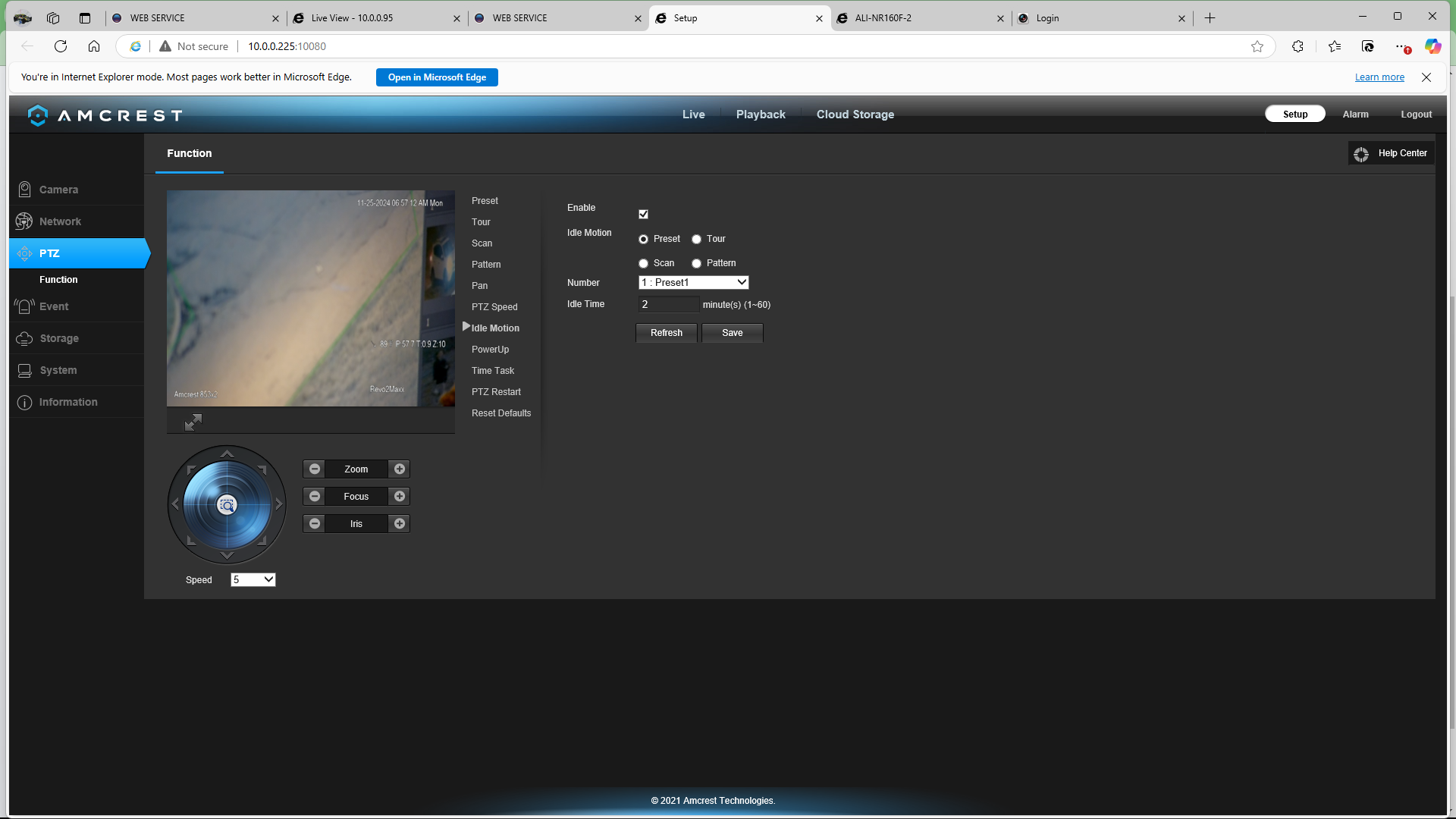

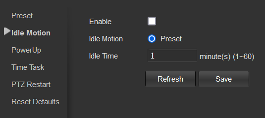

That is why I setup a Preset and have Power Up and Idle Motion setup to go to the Preset 1 that I have setup as being my main area of interest for my PTZ cameras.. Some of my older and or other brand PTZ cameras call them Home and Some call them Guard Position.. My guess is that the Position is the cameras Natural Start up state.. There are some camera that you can setup with what is called North and that is where it would form then on start the camera up at.. But for ease of use. Setup a Prest where you want the camera to always go to as your Main area of interest and setup Power Up and Motion Idle to go to that Prest.. Then it will always go there after a reboot or *Power Loss* and after you move the camera and get called away it will return to home position..
Re: PTZ Camera won't Maintain its Orientation
So to give you an idea of what I mean. Here is my 850EB from years gone lol. Anyway have a couple of these and a few other PTZ in many different areas.. But in the first picture after a PTZ Restart with all the Power UP and Idle turn off this where it loads.. Second picture with Idle and Start up turned back on. I mean just as easy as enabling the feature again.. After the Start up it auto goes to home preset 1..

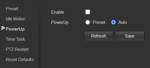

It looks like it's finally sorted, in its out-of-the-box/factory settings there's a setting in the System config to reboot at something like 4am. This presumably triggers a PTZ restart which leaves it pointing off into the weeds. Disabling the 4am reboot leaves it pointed to where it should be.
So if anyone else is having this problem then, from the factory-default settings go to PTZ > Function > PowerUp and disable it, then go to System > Auto Maintain and disable Auto Reboot.
