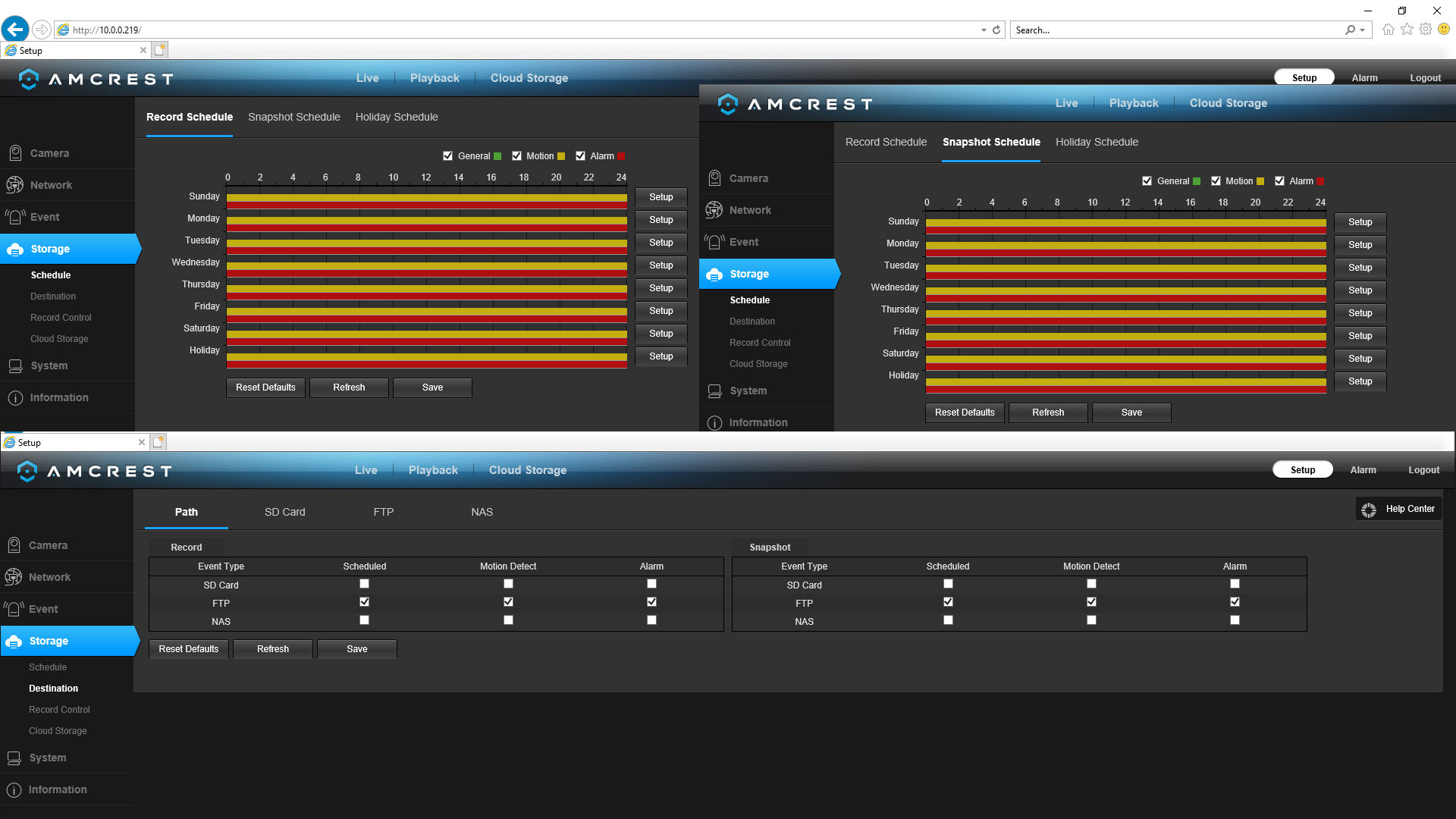

I am sorry I am lost... When setting up FTP there has to be a Schedule of some action either it be full time or snap shots.. Once one is updated it can move all things back to factory depending on the FW and how Written not always but maybe that is the issue? Sadly I don't have all Amcrest hardware to Test things or I would try and test out why and what is going on to see if can get it to do the same on mine...
So because I am a PAIN and like to make myself Crazy I just reset my 2116-HS back to Factory lol (Dumb Move) While I know this is an NVR I go to my FTP and on my first page to setup I add all my info for my FTP, then what Change I want, then it is asking days so I pick all channels and all days and then next it is asking for what type of FTP Alarm, Motion, or Regular and my Camera say the same thing... Then it gives me time periods in my NVR 1 and 2 and I can set any 1 or all 3 of the options for Alarm, motion, Regular...
I will put 3 pictures into 1 and upload what my FTP for one of my cameras looks like without doing something for a Schedule I am not sure how it would be setup to record full time on FTP as mine after a reset only was set with Motion and alarm This is after I did a Factory Reset and Setup my FTP server but didn't make any changes inside of the Schedules
Re: Problem: FTP upload snapshot
By default, after a reset, schedules are set to be motion and alarm all the time, every day from 0-24hr, just like in your screenshots. I never set anything different, not on the camera that is working, and not on the camera that isn't working.Revo2Maxx wrote: ↑Mon Aug 03, 2020 5:06 pm Sorry it is hard at times to give ideas of what one I would do if I was in this problem..

Yeah I don't know sorry i can't see what you have on your screen and I don't know why it would or seem like it is working when it isn't...
However seeing it is setup for Motion and Alarm..
What is the color of the lines when you do a search for playback or in the listing I am not sure if yours is list only or playback bar as some are different in way they are setup... Green Red or Yellow?
So I just setup a camera that has loads of traffic, I setup only motion and I setup to FTP when I look at the Recording I have full days worth recording as I set this yesterday and have full folder of images and full folder of videos and is beause it is on a constant motion
If you had something like this I am going to guess that is why or what is happening.. While you think it is full time Recording it isn't the issue is that it is getting something in Motion and making a recording... Also what did you setup for Delay of recording? and Anti Dither? How long do you have your system setup for recording? that don't matter really unless it is set up for full time recording as only thing that matters really is Anti Dither and Delay when it comes to the motion recordings?
