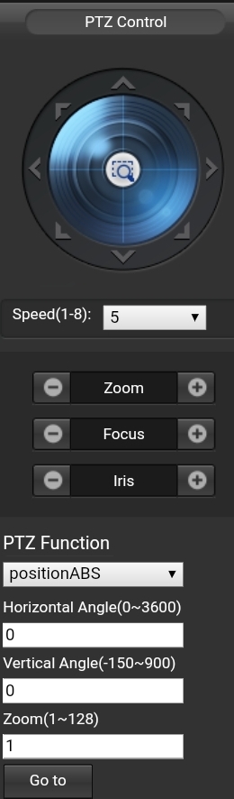

You probably need a higher function PTZ camera like an IP2M-858 that even has that function in the Web UI.

I am going to guess as Jack7 has mentioned that you will need a PTZ a True PTZ camera that has the OPTION built into the camera..
a 1051b is a camera that features a Pan and Tilt with limited Digital Zoom however isn't a true PTZ camera as one would think..
You would need a different Camera for that feature to work
LIke a 1053, 853, 858, or other true PTZ camera an 866 might have the option but not sure really. Also an 848 if you could find one but others like the 721, 841, 941 or 1051 line of camera is not going to have that feature or the V3 of said cameras.. There is no ETA to fix as that is an option that isn't in the Cameras software to start..
