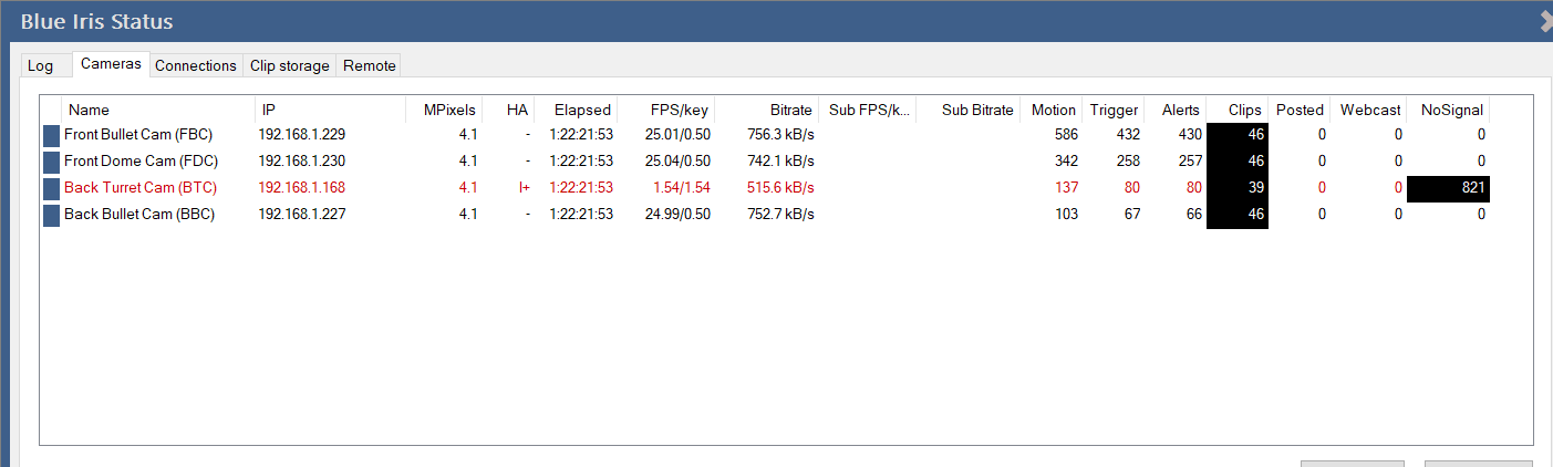

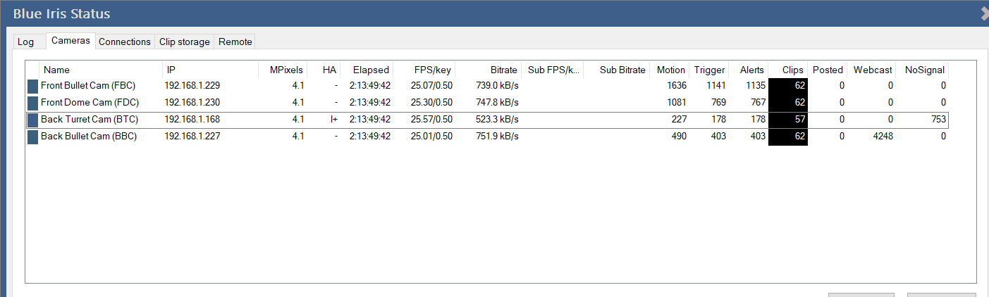

No body has lose of video signal with this camera? Mine is the only one? I find that hard to believe, this camera just goes out randomly BI5 shows the cam as connected and working properly just no video signal, I'm totally disgusted with this camera. I wish this happened while it was still under 30 day warranty I would have returned it but now I'm stuck with this paper weight.
EDIT:
Found a couple screen shots showing this camera with no signal.
Blue Iris Status 5_18_2021 8_30_30 AM.png (23.75 KiB) Viewed 2506 times
Blue Iris Status 6_3_2021 7_48_37 AM.png (23.4 KiB) Viewed 2506 times
