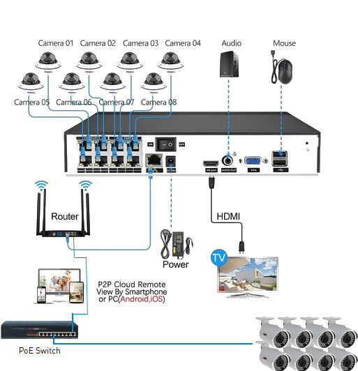

So Put here is how it should look like from a network standpoint I am going to guess...

One more question. Out of the 8 POE ports, there is one empty, I want to plug into that one.But don't know how to make it live. Is there some type of direction how to. Like I said ,this is the first time with a nvr.
Re: POE Bullet Camera set up.
Should be able to make a Connection to a POE camera and it should work unless there is something wrong with the PORT... What I would do is look at your NVR under the cameras and look at see what IPs are already in Use in there... THen when you are making your Changes over the WebUI you can stay with the Same theme as you have them now...
