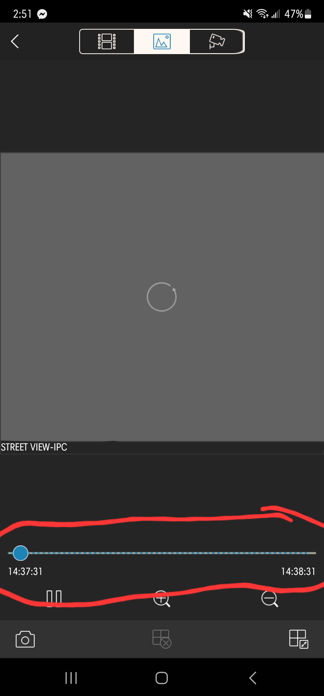

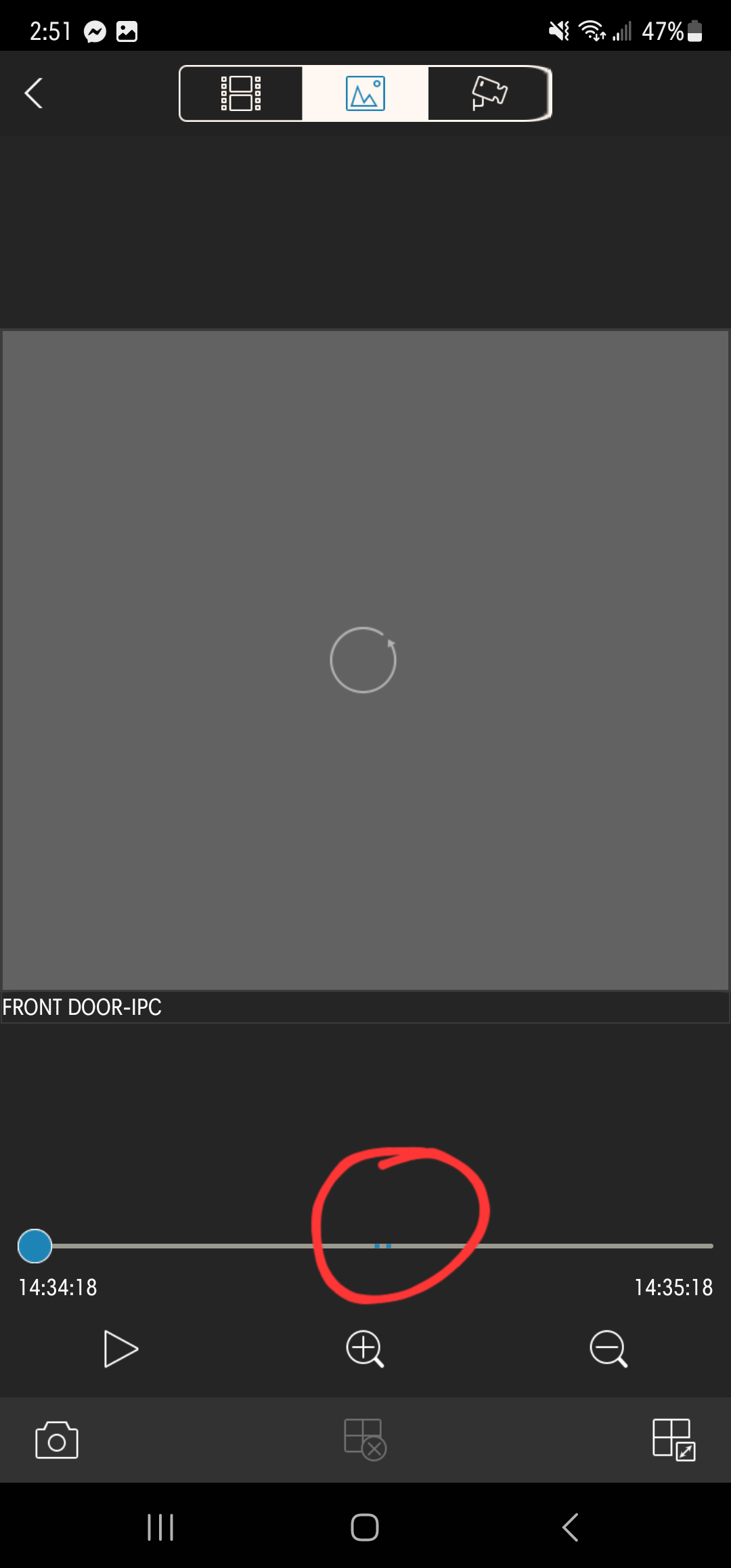

I have 2 ip camers over poe, I have made sure to get the motion settings the same for both, and my problem is once I go into event list and click on a motion alarm on my (front door camera i get a few second image preview) but when I click on my (street view camera it gives me the whole minute video) which settings can i change to make it the same as my front door camera few second preview I do not like waiting the full minute to see the motion detection?

I would reset it but I just got a delivery of a 3rd camera and out the box I tested the "push type image notification" and it did the same thing gave me the 1 minute snapshot video instead of the few seconds I want 🫤 I'll have to check the settings for snapshot when I get home, also anti dither, sensitivity and all that are the same for both cameras

went onto amcrest web UI , camera - video - snapshot and messed with those settings in there and it fixed my problem thank you for the information !!
