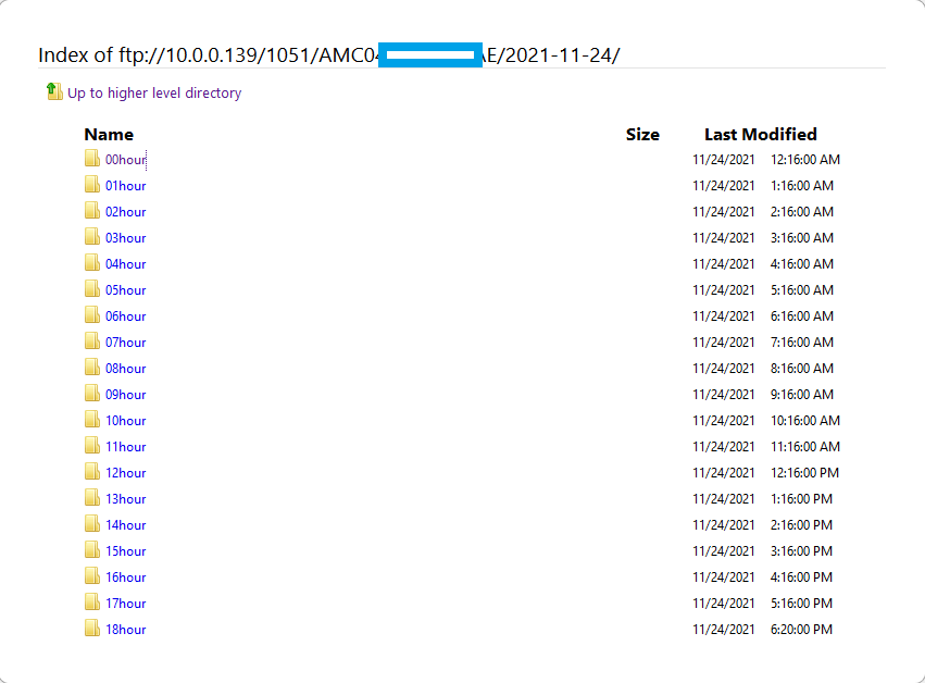

Aww I just looked at my FTP server I noticed that yesterday I changed my every min Snap to once an hour and looking at the data from today only time I had 1 that was not 1 hour after the last was the last hour and that was because that camera just went though a weekly reboot that I have it setup for and was 4 min late for the upload but still did that upload after the system was online after the reboot. As I said this camera don't have a mSD installed right now so it is purely on its own accord. What I mean is some of my other devices with MSD will or can save as backup to the mSD card and once the connection to my FTP server is back online it will upload that data to the FTP server could be even the whole day.. So for the 1051 it is a Real time event..
