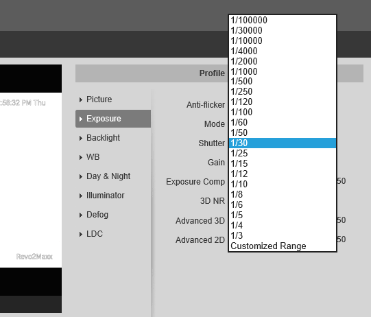

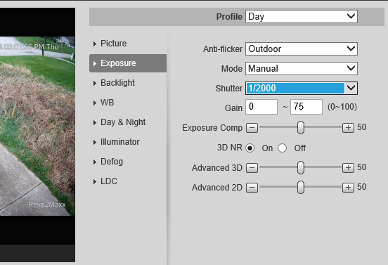

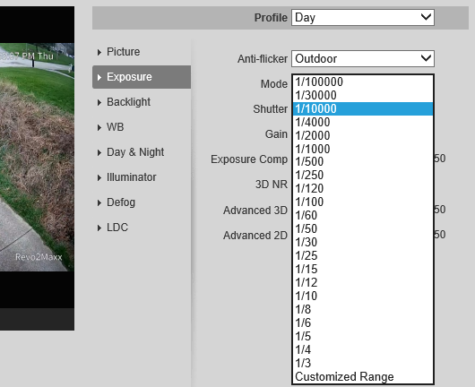

So I thought I would expand on my answer a little to help others that might end up reading this.
For best results the camera in an area without enough lighting should have day/night setup rather then using just the Auto Day that the cameras normally come setup for. Then in the Night time settings there are some areas that you can make adjustments to the camera to help. First I would have Smart IR off, Then on the Illuminations area I would setup the IR to full 100%. That is because the camera can take a little time to adjust for brightness changes at a slower pace then other changes that are made in the cameras settings. Next on Exposure time. I would say that if you are going to use the camera at the highest FPS like I think 15 in this case on other cases it would be higher like 30fps. In this case it is best to use 1/30. However if that setting don't work well enough you might need to change the settings to meet your needs. Main reason behind making sure you have Day/Night setup is in the picture below. At the current day time level at the time I took these pictures 1/2000 was best however just a few seconds later because of the light level change from sun/clouds that wasn't as nice a picture so Auto for day is best and seeing that isn't where the issue is I am just explaining about Day/Night and reason behind. Looking at the one set at 1/30 you would be looking at a white image in the day time. Picture below..
