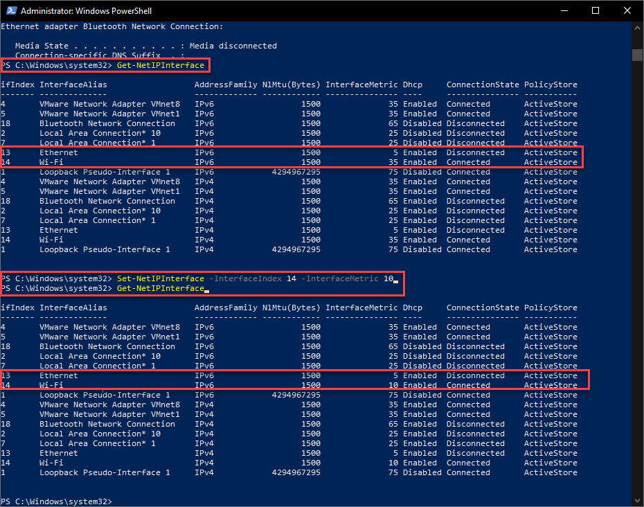

Solved, but it's a little technical. It comes down to changing the binding order of your network adapter(s) such that Ethernet and Wi-Fi adapters are the lowest: Ethernet is 5 and Wi-Fi is 10. The lower the number, the higher the priority. I had to change my Wi-Fi adapter from 35 to 10, and now PC-NVR is not greyed out.
It's easy if you follow these directions:
https://www.windowscentral.com/how-chan ... powershell
