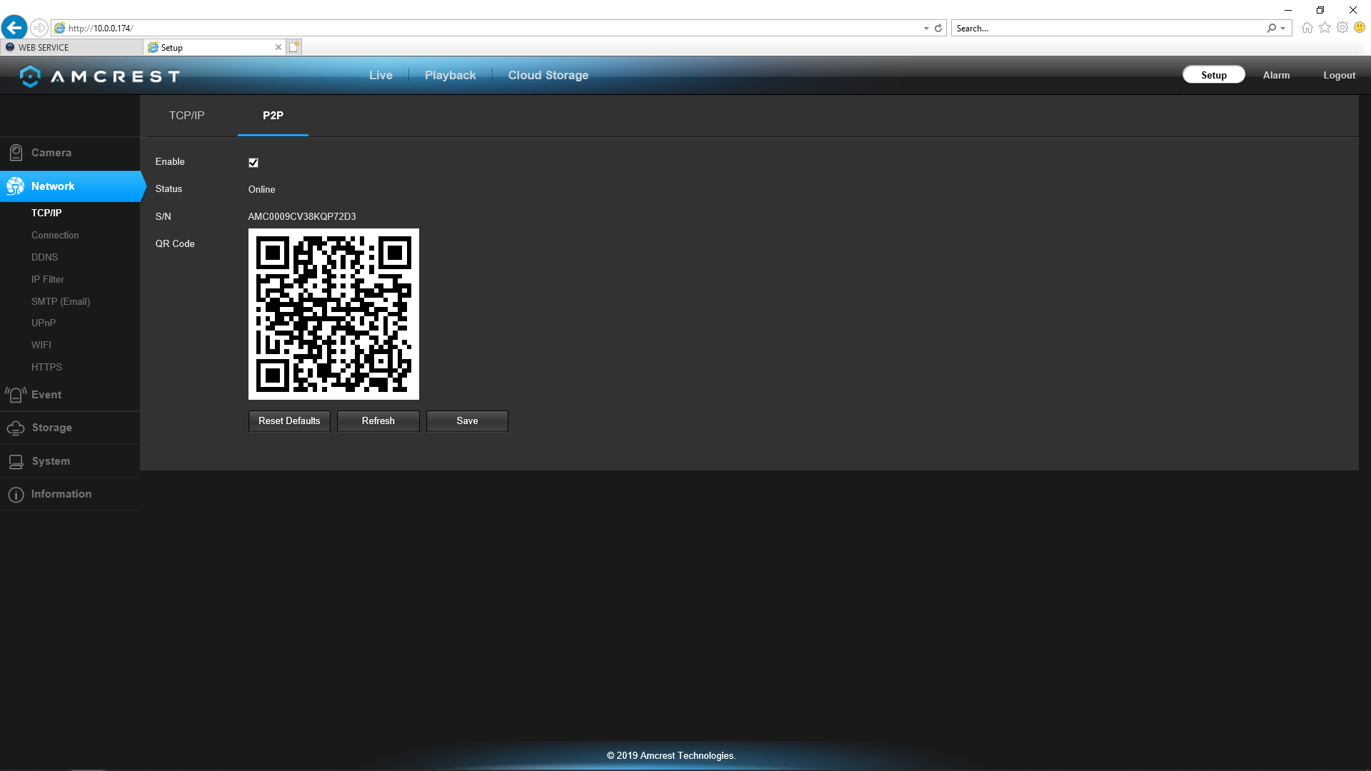

However there are somethings that maybe you could try. Here is a picture saved from one of my 841's WebUI Network, TCP/IP and then P2P tab you can see it offers the QR code to scan from your desktop. You can see mine shows status of Online. If there is an issue with the connections it would show offline.. I personally would try to use P2P it is Free and works for me very well even able to access my cameras over P2P on ASP.. Less of a headache..

Mine is showing as offline. I did find one problem with my settings. My DNS settings were pointing to my old pihole, which I'm not using for DNS. But changing to my other DNS settings (1.1.1.1, 8.8.8.8.). Looks like I had a conflict between the wired and wireless settings. Bumped the wired IP address out of the reserved range and got it to show the camera as online.
Still wont connect through the app, though. Tried the P2P QR code, too, and thats not working either.
