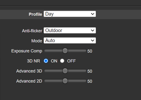

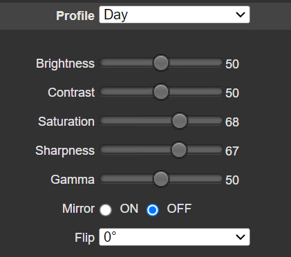

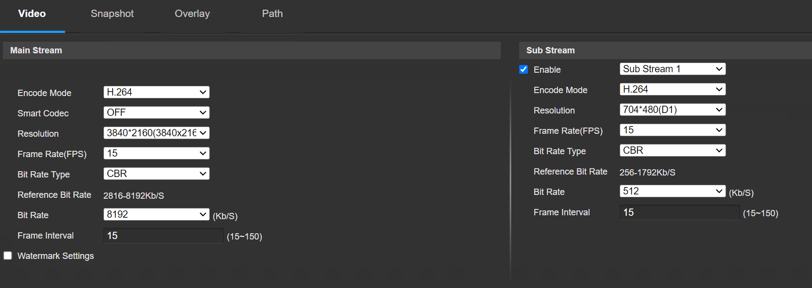

I'm using the latest Blue Iris update as well as the latest Code Project AI. When we have a vehicle passing in front of this camera it creates a blurring effect that goes away after the vehicle has passed down further. All my settings are as follows.

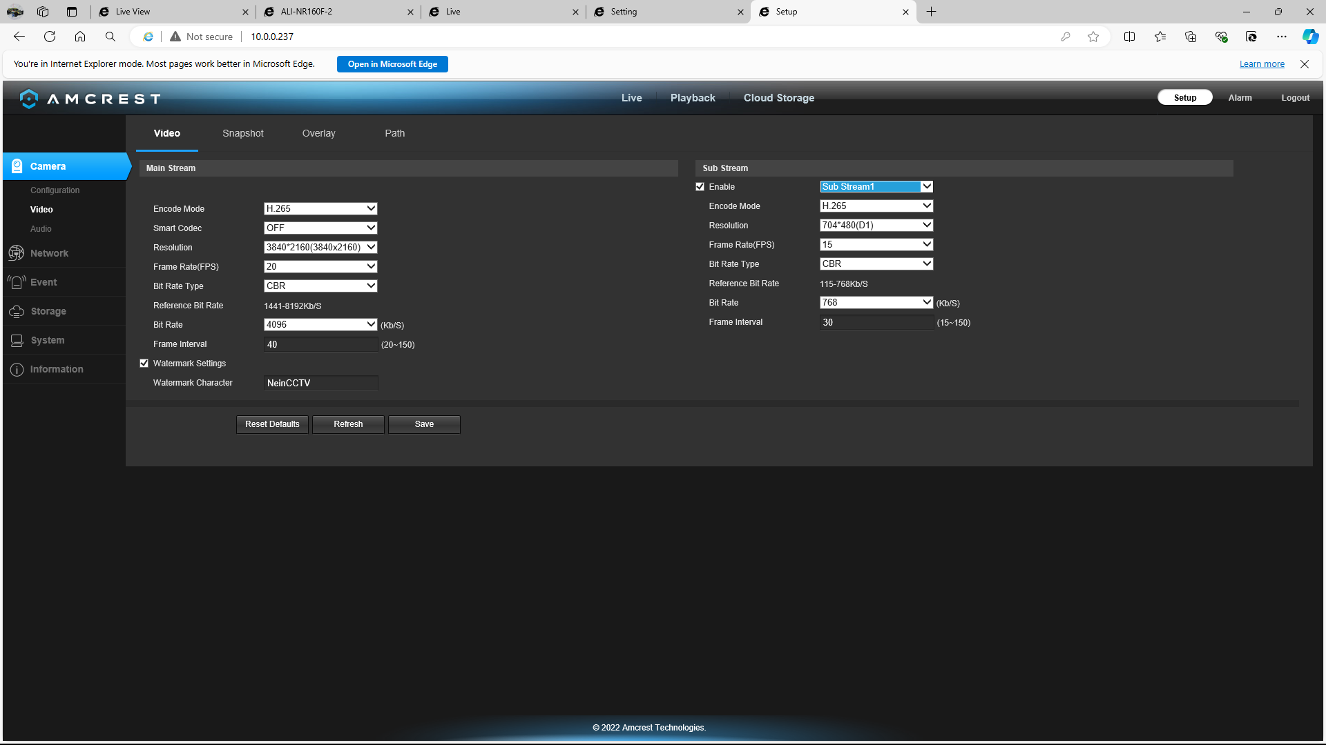

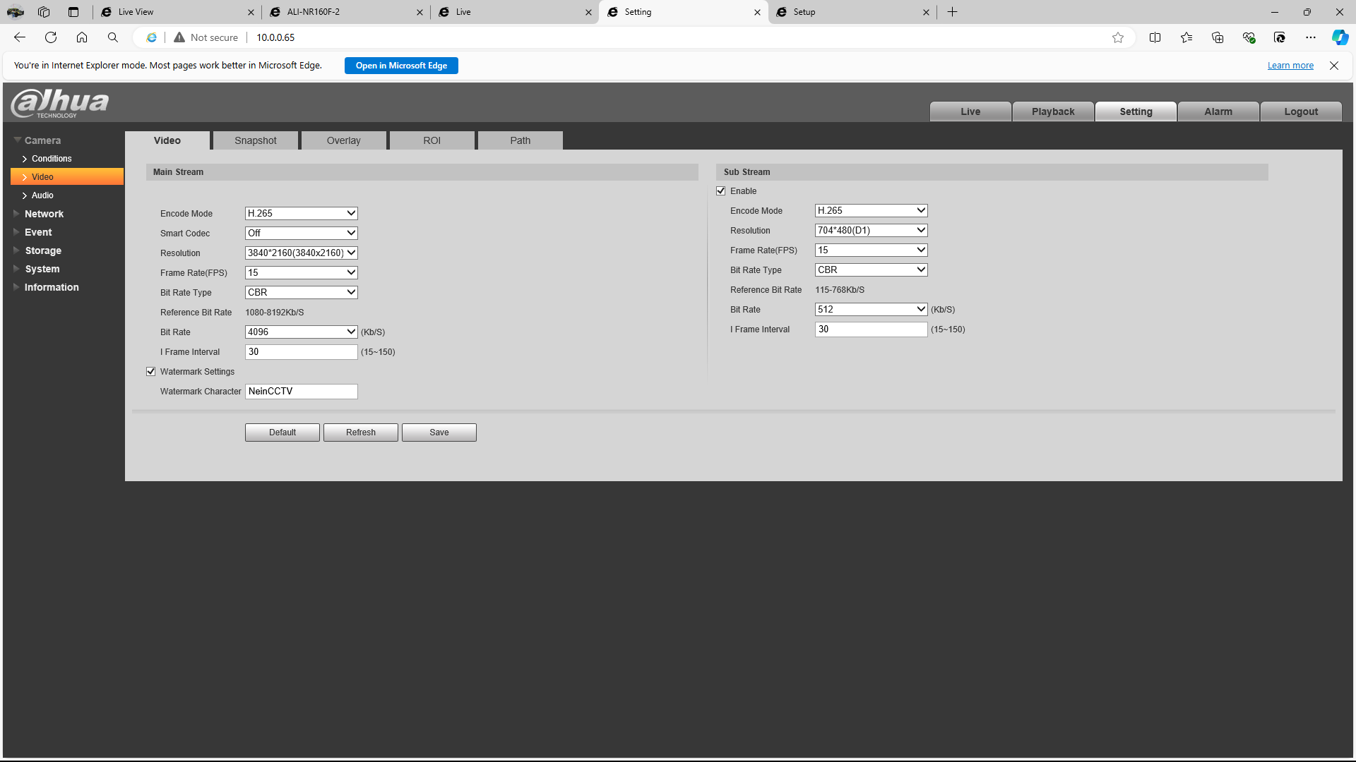

What? You are saying that the Video setup of that camera by Default is the pictures you posted? I mean I know that camera is only 100ish in cost but there is no way I believe that the camera came setup in H.264 setup with FPS of 15 and iFrame rate of 15.. So either that is your setup settings or someone made some changes you were not aware of...
That camera even at that price offers H.264H and I would have to guess came out of the box setup with H.265 and maybe someone changed because of issues with Bi normally not playing well with H.265 however I have a couple of 8mp cameras on Bi that are in H265 format..
So if you MUST change to h.264 at least turn on H.264H. Second issue change the Iframes to be 30 with a 15fps setup camera.. If you have a 20fps then it should be 40 for iframes..
to view my pictures full view right click and view in new tab. These are 2 8mp cameras I am running in Bi, If you would like some more detail on iFrames and what they are and what your settings compared to mine besides the bit rate I did change came setup from factory as double the FPS..

Those were the current settings that I had. I have now made it to h265 and turned off WDR to see if that helps. As far as the iframes everyone says it should be as close to 1 as possible so 15 FPS should be 15 iframes
https://ipcamtalk.com/threads/the-impor ... ons.68607/
