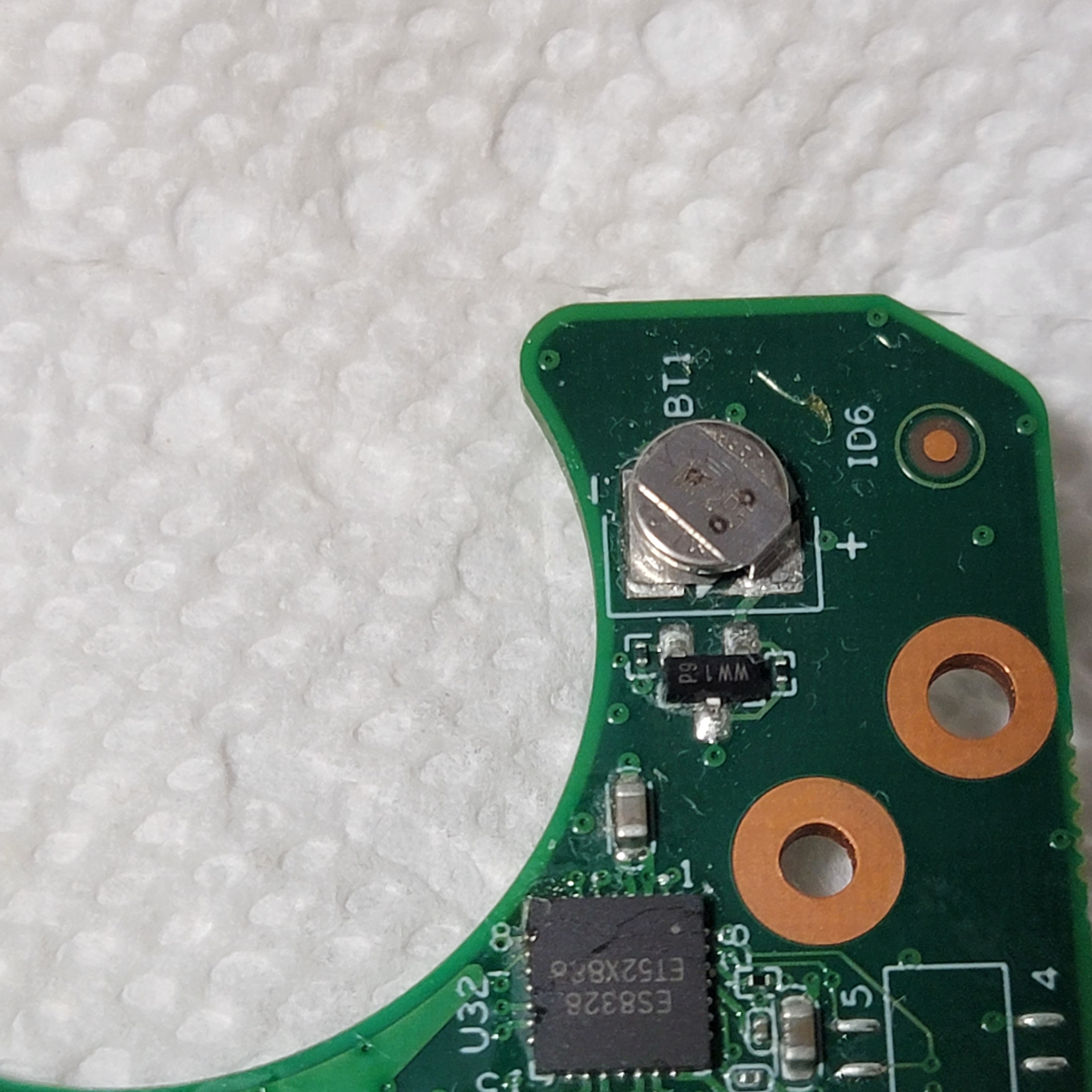

PTZ over shoot and issues like that was related mostly about the 841.. I have over a baking dozen of them and out of the ones I put the new FW on there might have only been 1 or 2 that didn't have the issue however they were with different issues.. Even a new one that I got Direct from Amcrest with the new 2019 FW on it had the issue that was very strange. Also some people didn't have the normal issue as I was saying above, They had issues with Presets if they had a preset 3 set. One of mine even had issue where it would load old presets. I mean I would have it facing 1 area and after a reboot at 2am I would wake up to the camera facing a totally different area. Then trying to go to preset one or what ever preset it was setup on it wasn't in that area and wasn't a preset that was ever loaded (Setup) in that installed location. Then I think one of the issues was battery being dead. As I noticed most of the issue cameras had Batteries for backup in the cameras settings were dead to 0v where the battery should have been 3v. To replace the battery one would have to remove the PCB from the camera body as the battery is on the top of the PCB. So yeah they are nice cameras. They do have a use. However I am not sure I could set it and forget it for a few months and think that I will get constant good footage in the area that I wanted it set to monitor and record. I spent more time down rabbit holes with the 841 then I have with any camera I have ever owned.

Speaking of 841 battery
