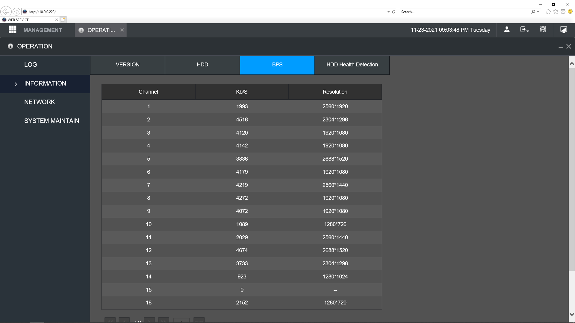

Yes, You can click on main menu, then Operation, then looking at the Network as a Whole you can click on Network then load.
To look at the cameras, on the left rather then clicking Network click on Information, then Click on BPS and that will show you the connection of the cameras to the NVR..

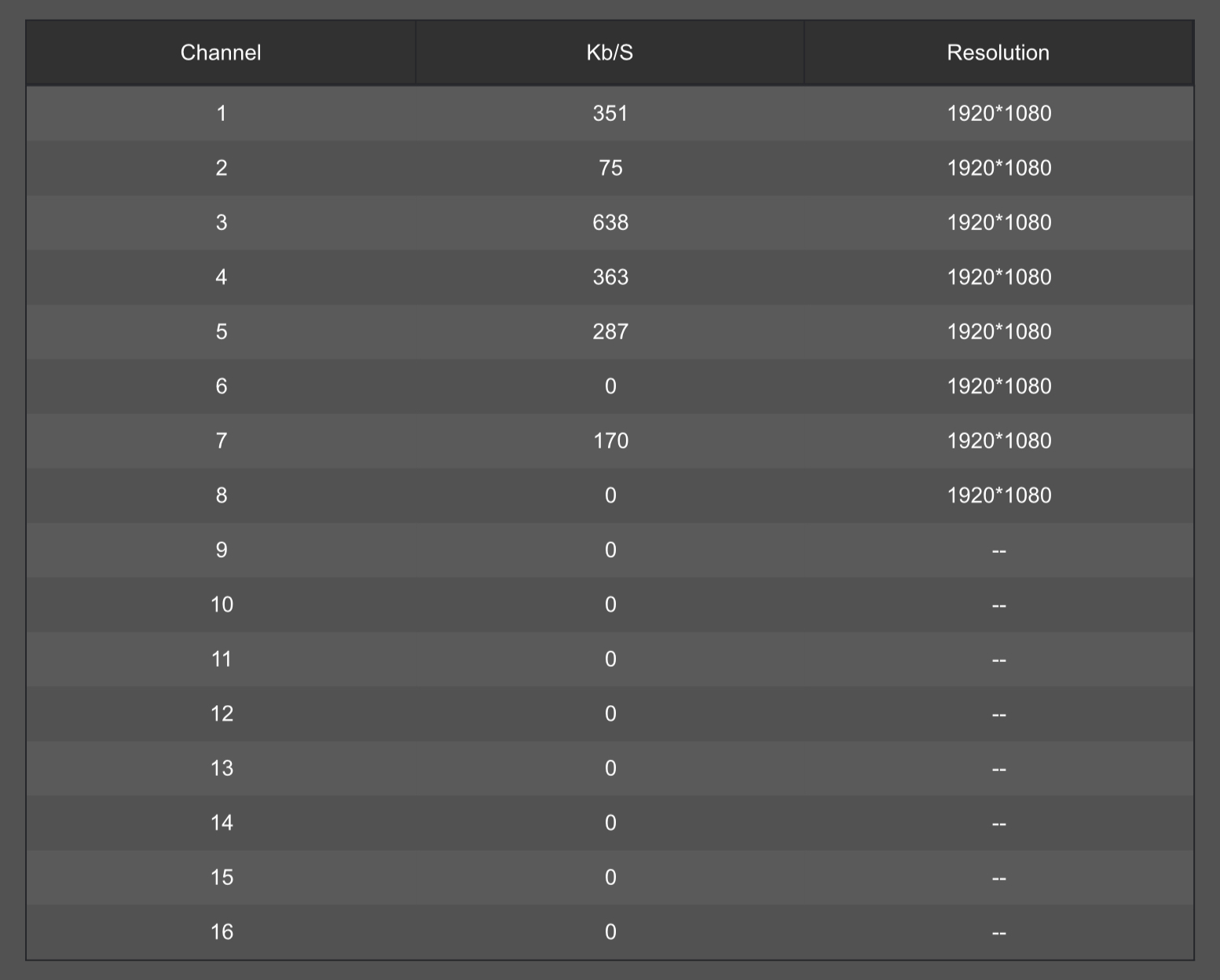

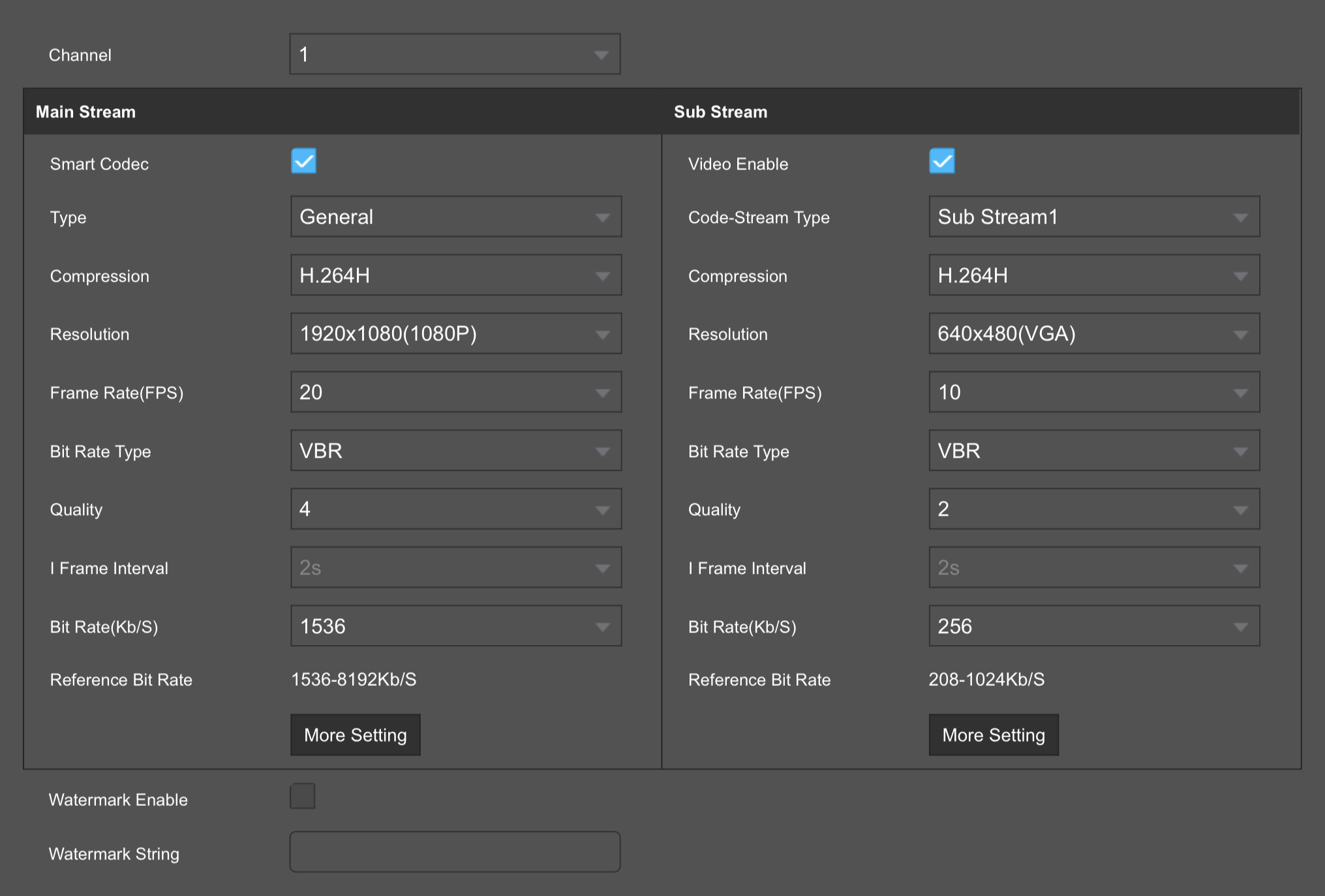

This is how I have each camera configured: as you can see, I’m downsampling both the main and substream a lot, and there is very little network contention. Despite that loading each individual camera, whether from the NVR or from the camera itself causes them to freeze.

Bit rate is to low for a quality video.
I setup my cameras on 22 FPS for Main and Sub I setup at 18 fps. Then most of the cameras I setup for 4096 Bit Rate and 1024 for Sub.
I also don't ever use VBR it will kill a good stream most always
Re: NV5232e-16p unusable with IP4M-1051w
I brought the fps/bitrate down in case it was a bandwidth issue, adjusting to the settings you’re recommending above doesn’t really change anything unfortunately, still getting very choppy video with higher latency now which is all very frustrating.

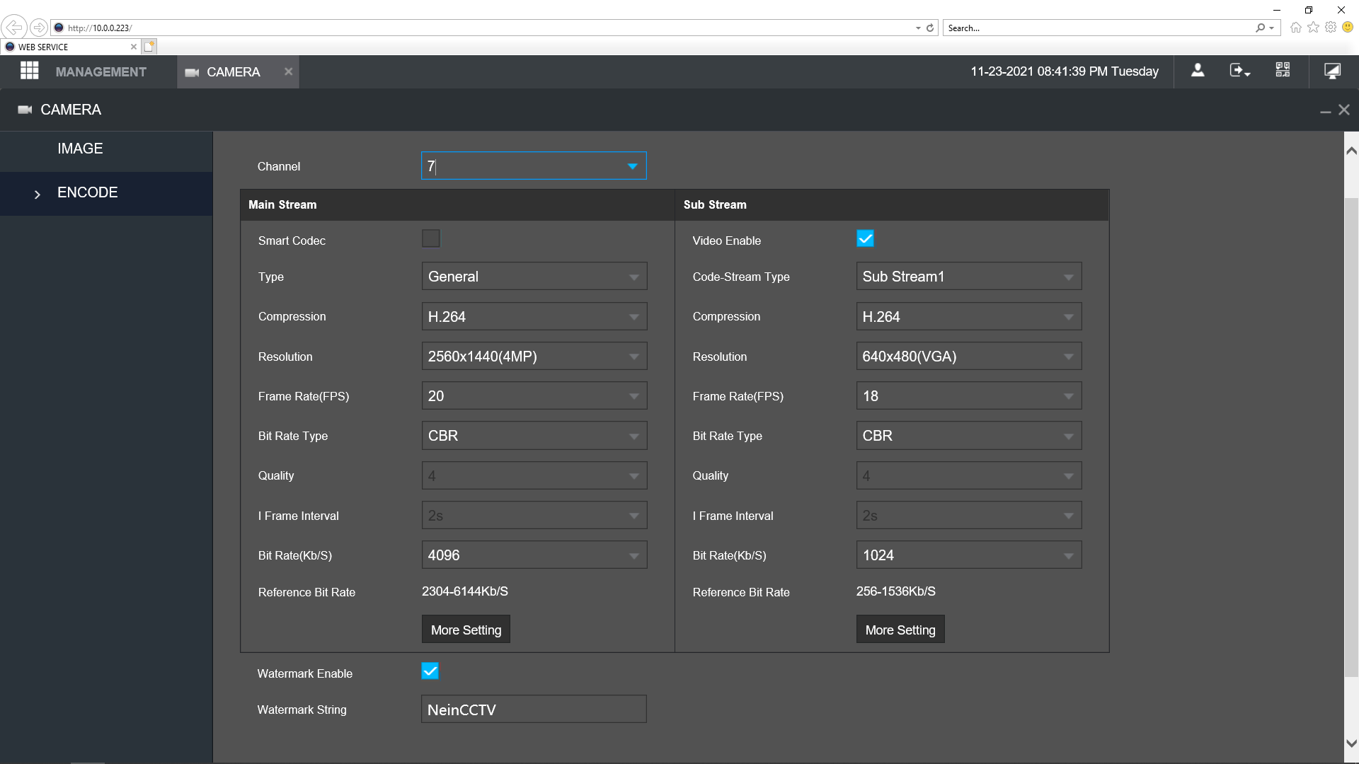

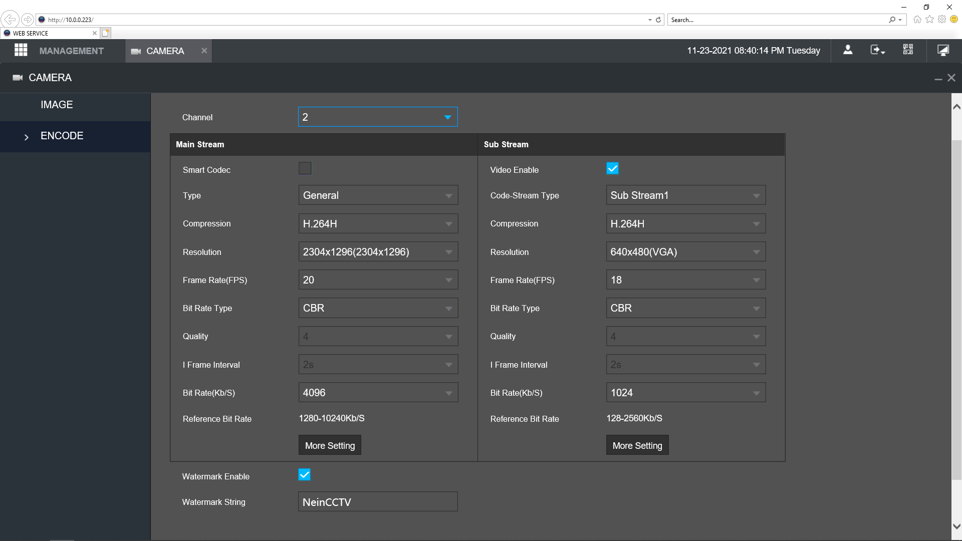

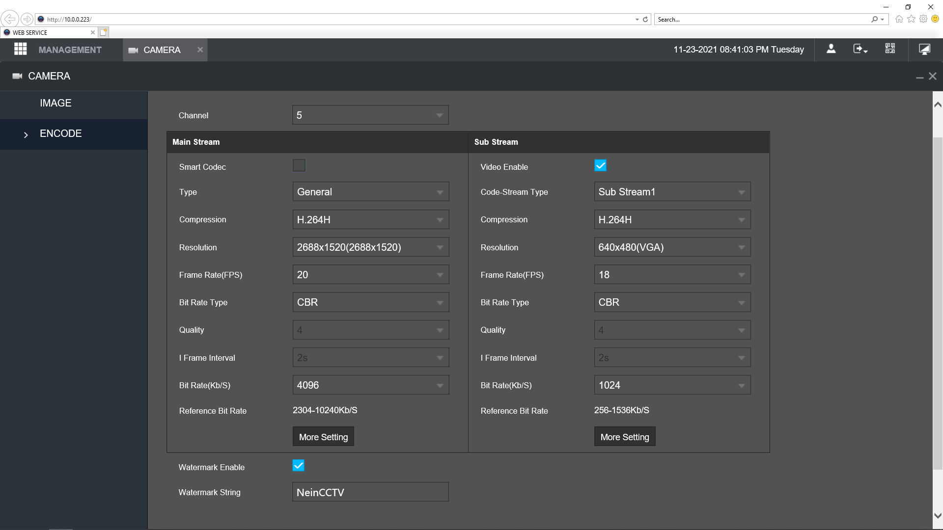

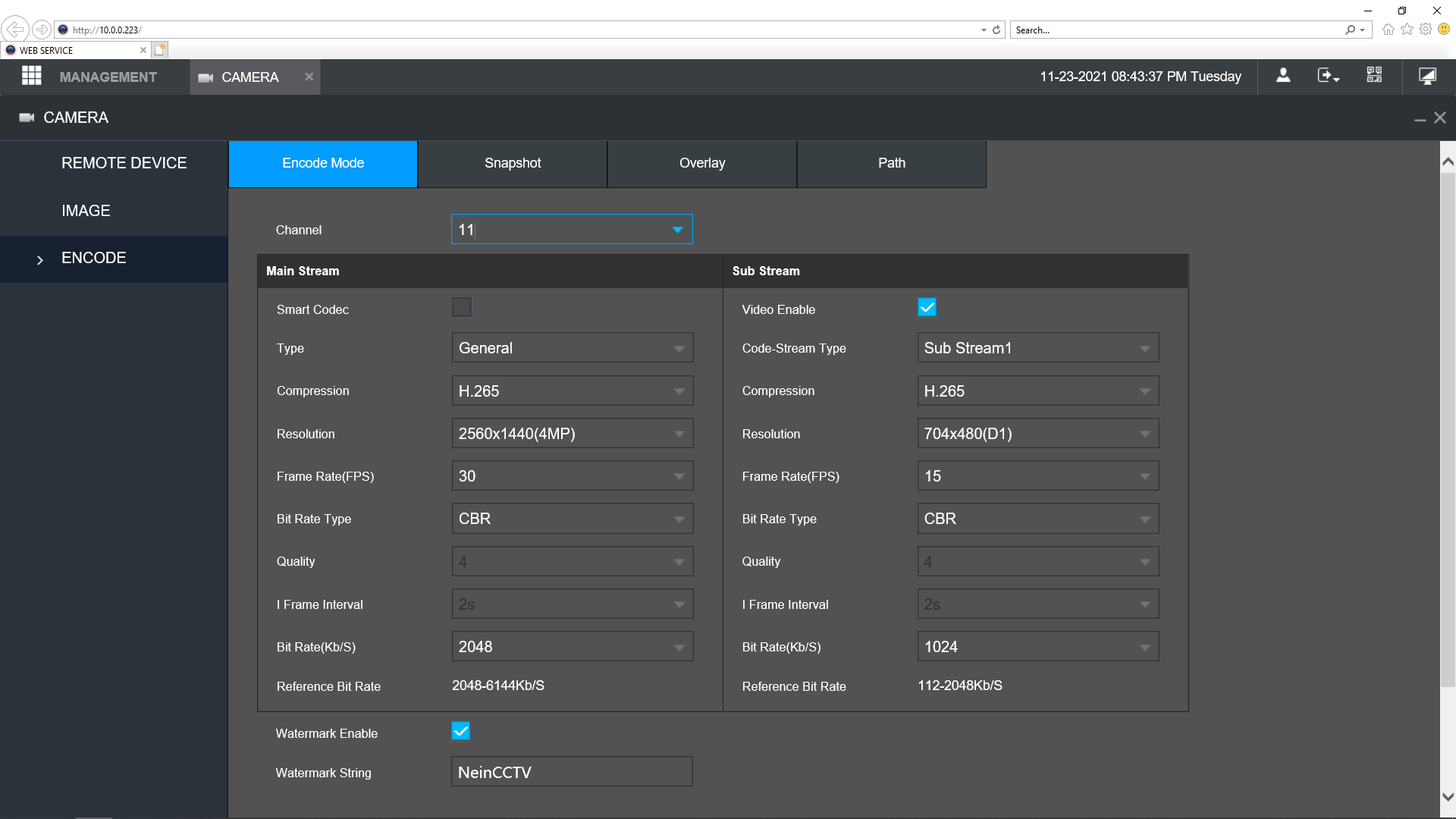

So on most of my cameras that I am able to run 22 I do. However I will admit that I do run a POE camera in h.265 in 30 fps and at only 2048 bitrate. That will be the last camera in the pictures here but wanted to show Ch2 and 5 are 2 of my Wifi cameras the other 2 are POE Also wanted to mention that on the 190 foot of cable there is 2 DVR's 8ch each, and 7 IP cameras. All connected to streaming to internet for P2P connections and even though I have it on a Giga port it has been damaged and my switch has fallen back to 100tx Also only camera that isn't connected to my NVR's is my 841v3 while I do have it port forwarded the NVR don't like the connection my 1051 is port forwarded 2 times and is on my NVR using my Routers DMZ
3mp Amcrest 941 wifi 15ft from router 93 foot cable to switch 4mp Amcrest 1051 wifi 10ft from router 190 foot cable to switch shared 4mp POE 30foot to POE switch, 190 foot cable to Switch shared 4mp POE 30foot to POE Switch, 190 foot cable to Switch shared with 2 above
