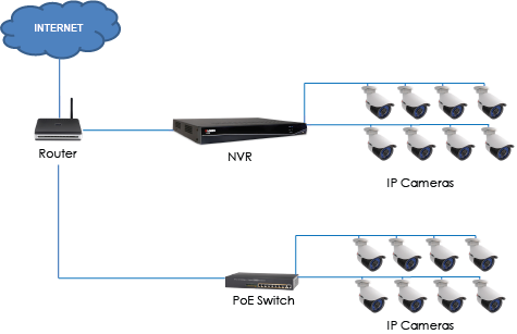

Thats not the right connection method, The recommended connection is you have to connect the NVR and Switch to common router , Switch should not be connected to NVR ports.
Please check attached image and do the connection that way it will fix your issue.
NVR and Switch configuration1.png (28.72 KiB) Viewed 1157 times

I can not do that. I have two networks, one for cameras and one for internet/computers tied to a router. If i hook it up as you show in your image, what is to stop someone from hooking up to one of my CCTV ethernet connections outside of my building and get right onto my PC network? It would be a security risk. Also since these NVR's only come with Ether 100 ports I don't want to consume any bandwidth on the WAN port for cameras, because streaming 16 cameras at 5mbps will already use 80% of the wan connection, add 10 more cameras to that and that port is overloaded by 30%, I will now have recording issues on those 10 cameras.
Why would the internal switch not be able to hook to another switch? What firmware tasks are you performing on this switch? Can you guys fix this issue?
